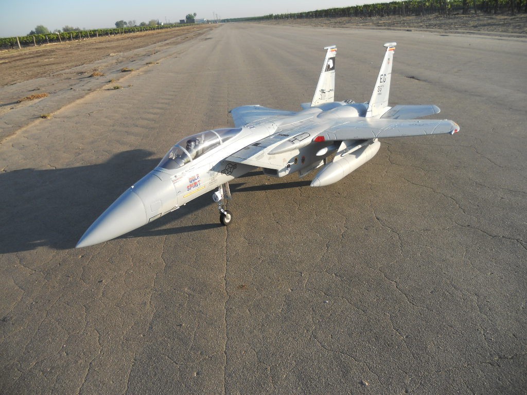

                  I don't use any mix on mine, sure others do but mine is fine with full flaps, I even pop the speed brake out on final and add a little power for the extra drag, the F-15 is one of the best ones on landings. I'm curious how the 9 blade works in yours, I tried it and it wasn't much better than stock so I went with the 4068-1680kv and that works very well. Let me know how it goes.

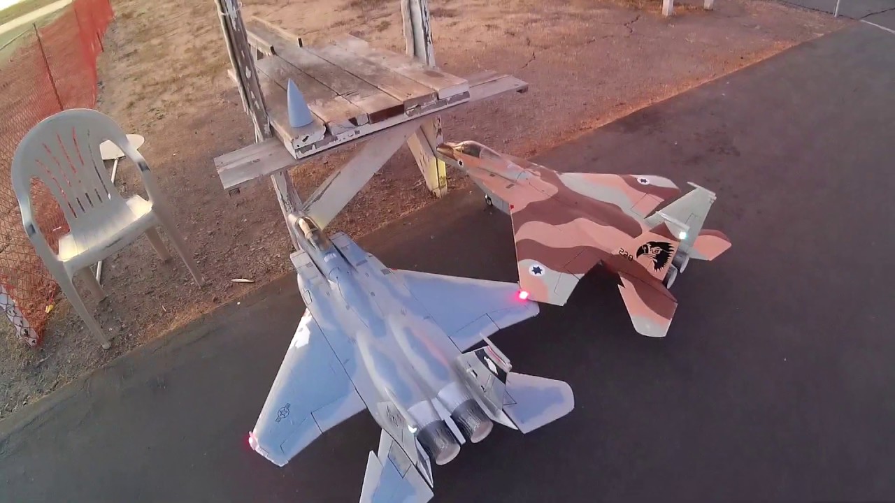

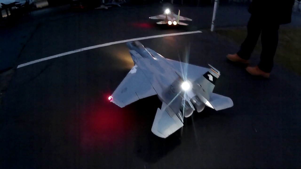

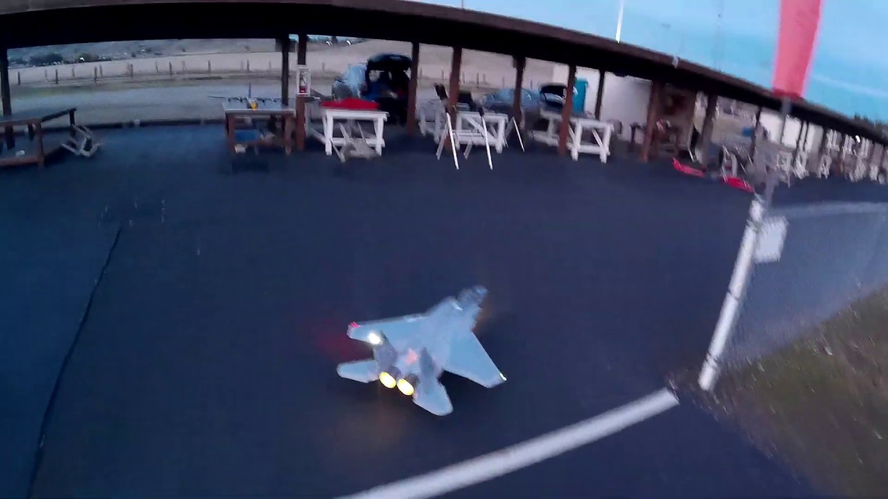

                              I got a flight this past weekend with the Hobby Star 6s 50c 6200mah pack and man was it a blast! My plane is modded but usually gets 3 mins flat... no time to spare... I flew really hard and would have normally depleted my pack. Landed with 3.65v per cell... I may have a new fave F-15 pack....
                                #455
                                I've been flying mine with a RoaringTop 6S 6250 35C, and after 3 minutes of spirited flying I still have like 3.76 left in the pack.
                                • bill34207
                                  Jet Junkie
                                  • 455
                                  • Bradenton, Florida
                                  #456
                                  I use a pair of 4s 5000's and get around 3 and a half minutes, lands around 3.8 per cell.
                                  • gooniac33
                                    The Original Gooniac
                                    • Jun 2016
                                    • 1047
                                    #457
                                    If I hadn't been flying like an idiot I am sure that it would have been about the same. However my current set up pulls around 145amps peak. Here are the videos of those 2 flights... the plane was very happy!!
