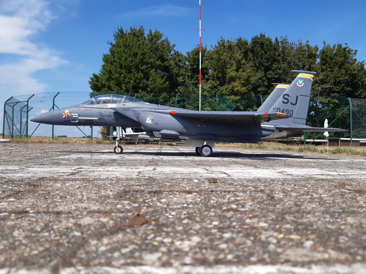

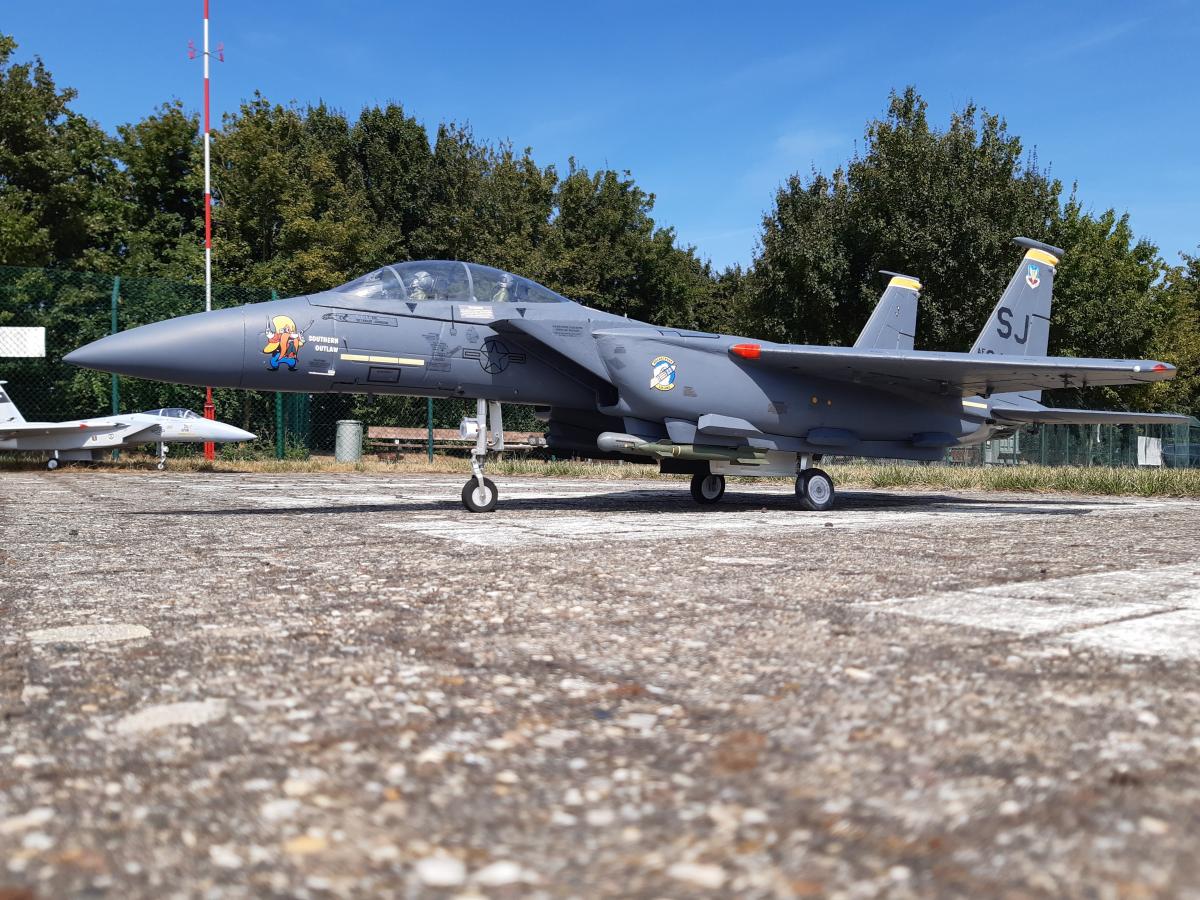

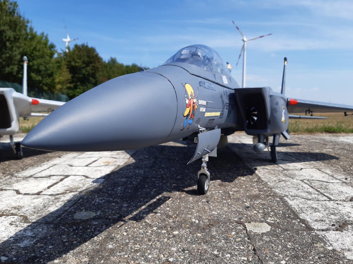

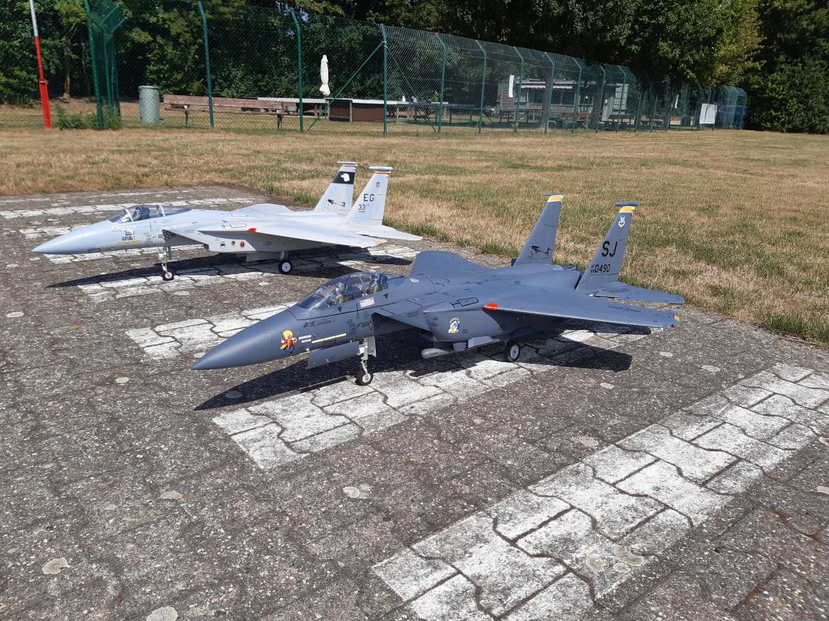

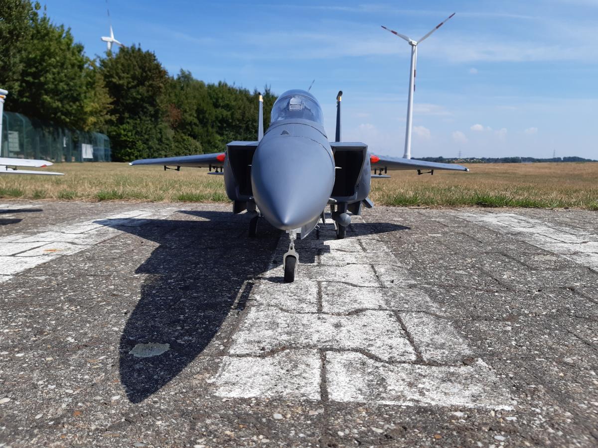

        • Here she comes!!! " F-15 E Strike Eagle"
          Made a transformation of the fabulous Freewing F-15 C to the F-15 E Strike Eagle. Because I had two of them, I decided it is time for it. Added conformal fuel tanks, a tandem cockpit, a new canopy, 15 new weapon and LANTRIN/NAV pod stations. A new color scheme in gunship grey and new decals for the "Southern Outlaw" plane from Callie Graphics. Special thanks to Frank Born (Tinpusher), Alrus1, betsmums and all the others for uploading their 3D parts on Thingiverse. And of course to Freewing, MotionRC and Alpha and his team for such great planes.
          Will have to print a lot more armament and will see how she will handle it in the sky!
          More pics and videos to come!

          • Originally posted by Jets and Wings View Post
            Visit Jets and Wings on Facebook, YouTube or Instagram

            Oh wow, that looks awesome, exactly what it should be, I just don't care for the stock color at all, send those pics to MRC and just maybe the F-15 will get a make over paint job and some choices on livery decals, I would buy another one,

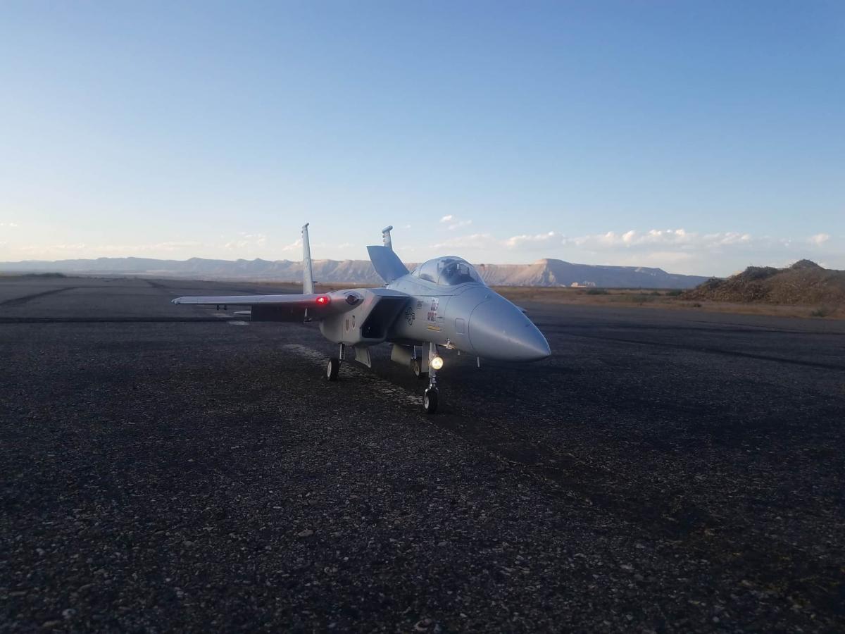

                • This jet rocks. I’ve locked in on a setup that works great for me. Aura 8, High Performance Version, Admiral 6000’s. 3 minutes of high throttle fun with enough left in
                  the tank for a couple approaches if necessary. Click image for larger version
                              I've wanted a strike eagle for a while. I keep looking at the Freewing plane, but kept getting hung up on the canopy. It looked to be beyond my skills. Seeing this conversion is inspiration.
                              At the very least it would be awesome if motion produced a mod kit oftof replacement parts would simplify the conversion.
