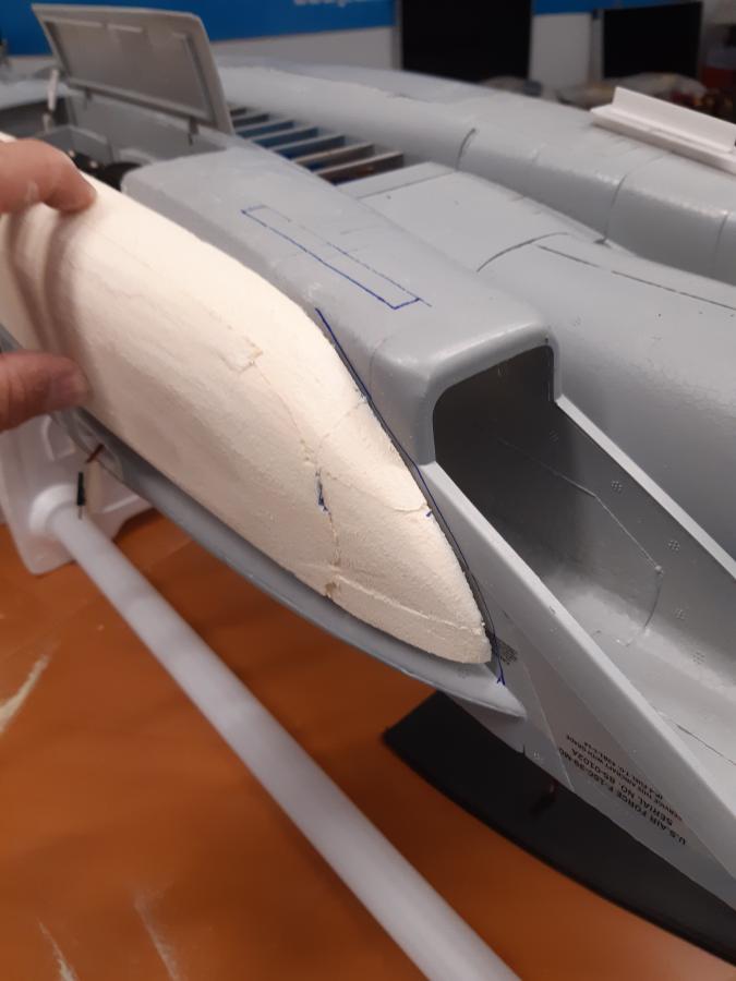

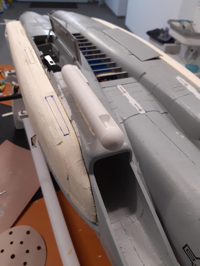

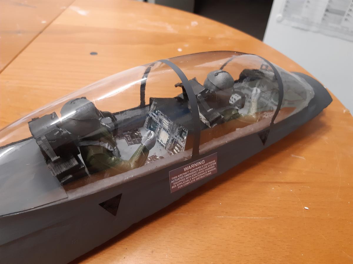

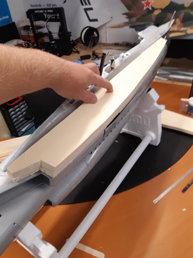

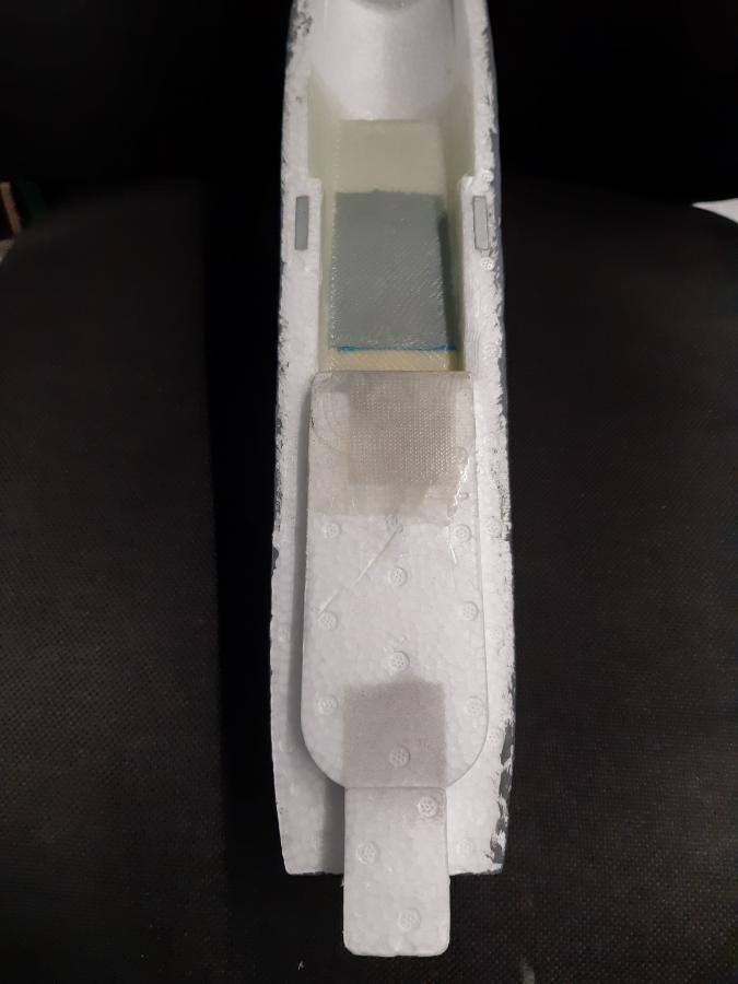

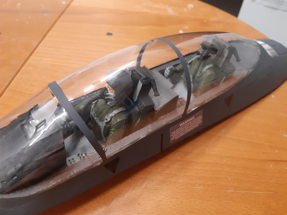

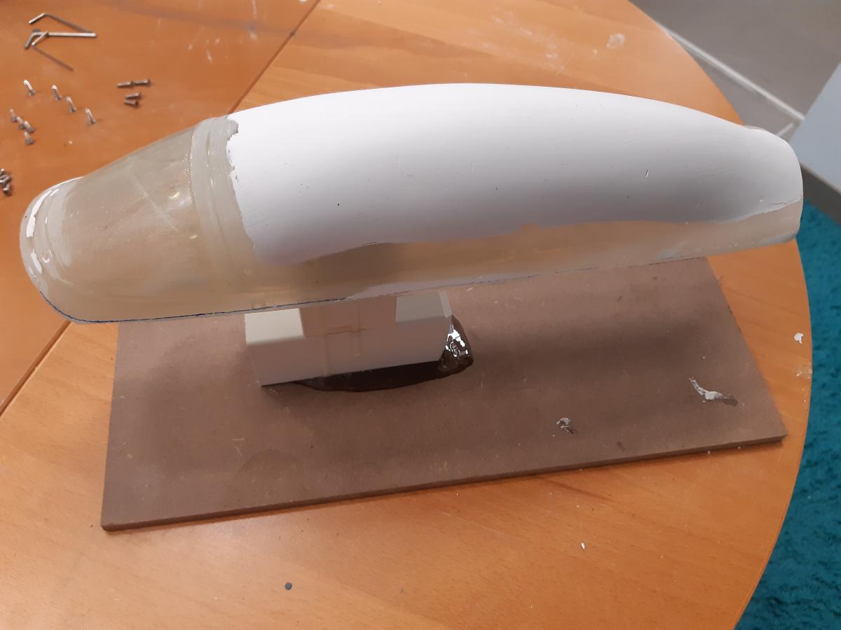

      Some pics I made during the build of the F-15E.
      For all of you Eagle drivers, thinking to build a Strike Eagle also. The CFT's, I made out of roofmate, very light and you can sand them very well. Using filler and lots of sanding and you got them ready. I used a Revell 1/48 model kit to measure. The additional weapon stations are also made out of roofmate with a thin layer of fiberglas. For attachment I used the male and female spare parts from MotionRC's F16 and also 3D printed ones. For the cockpit, I put some fiberglas on the downside, so I was able to remove the foam behind the first cockpit. I used 3D parts( pilots, cockpit parts, weapons etc.) offered on Thingiverse from some great guys out of this forum. Thanks for sharing!!! For the canopy, I used the old one to build a mold and added the extra space using filler and after hours of sanding and measuring I am very happy with the result. I used 0,8mm vivak petg clear plastic plates, put them on a frame and to put it into a 150 degree C hot oven for 3min and put it quickly over the mold.
      Color is gunship grey, decals are from Callie Graphics.
      If you have any questions, please fell free to ask
      If you still have the mold for the canopy would you consider making/selling one or two? I'm really digging on the new F-15EX and would love to do a conversion...

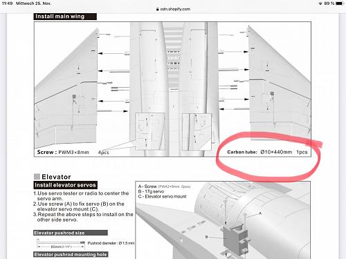

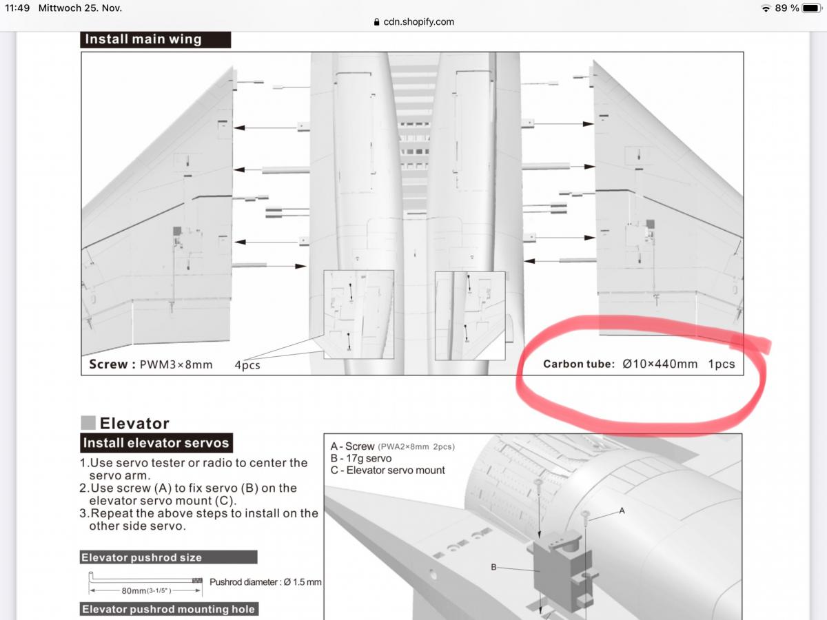

                            Hi guys, just acquired an F-15 and I must have forgotten the spar.
                            Unfortunately, it doesn't look like the spar is available as a spare part on the Motion website, which seems odd.
                            Can anyone tell me the length and OD of the spar for the F-15? Or, even better, if there happens to be another Freewing plane (Or any other manufacturer) that uses the same size spar?
                                #675
                                I have a spare spar that is pretty close in size but I cannot guarantee it will fit...I have a collection of spars and I don't know what models they belong to. If interested just hit me up in PM...

                                  #676
                                  I cut down a spar to size from an F-18 I don't fly anymore. I'm going to see if they have 10mm diameter carbon tube at my local Hobbytown as well. If they don't have anything I'll let you know. I have a feeling buying a new F-18 spar and having it shipped from Motion may be cheaper than shipping it any other way if you do have one available.
