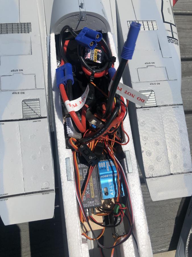

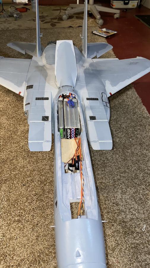

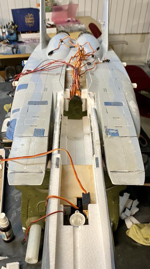

Ok Final Setup complete. Used Freewing 8S system. Jeti REX9 receiver , MUI ( Jeti Capacity Telemetry) and Hobby eagle gyro ..... Balanced at 125mm. Removed nose weight.
5000 6S and 5000 2S

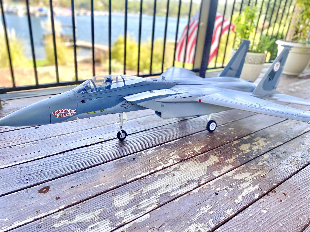

Ok... I am quoting my self.. HAHA, Finally got the maiden ... JUST AWESOME. Utilized the data from this thread to great success (Especially Gooniac Thanks man ) ... the 125mm CG is perfect. Zero elevator trim needed... Almost no room left. 8S with a Gyro ad and a Jeti MUI takes up " all the Space" Its a Winner.... Now need to figure out how to incorporate the Dorsal speed break.

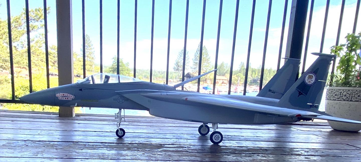

Was a fairly breeze day but she flew awesome.

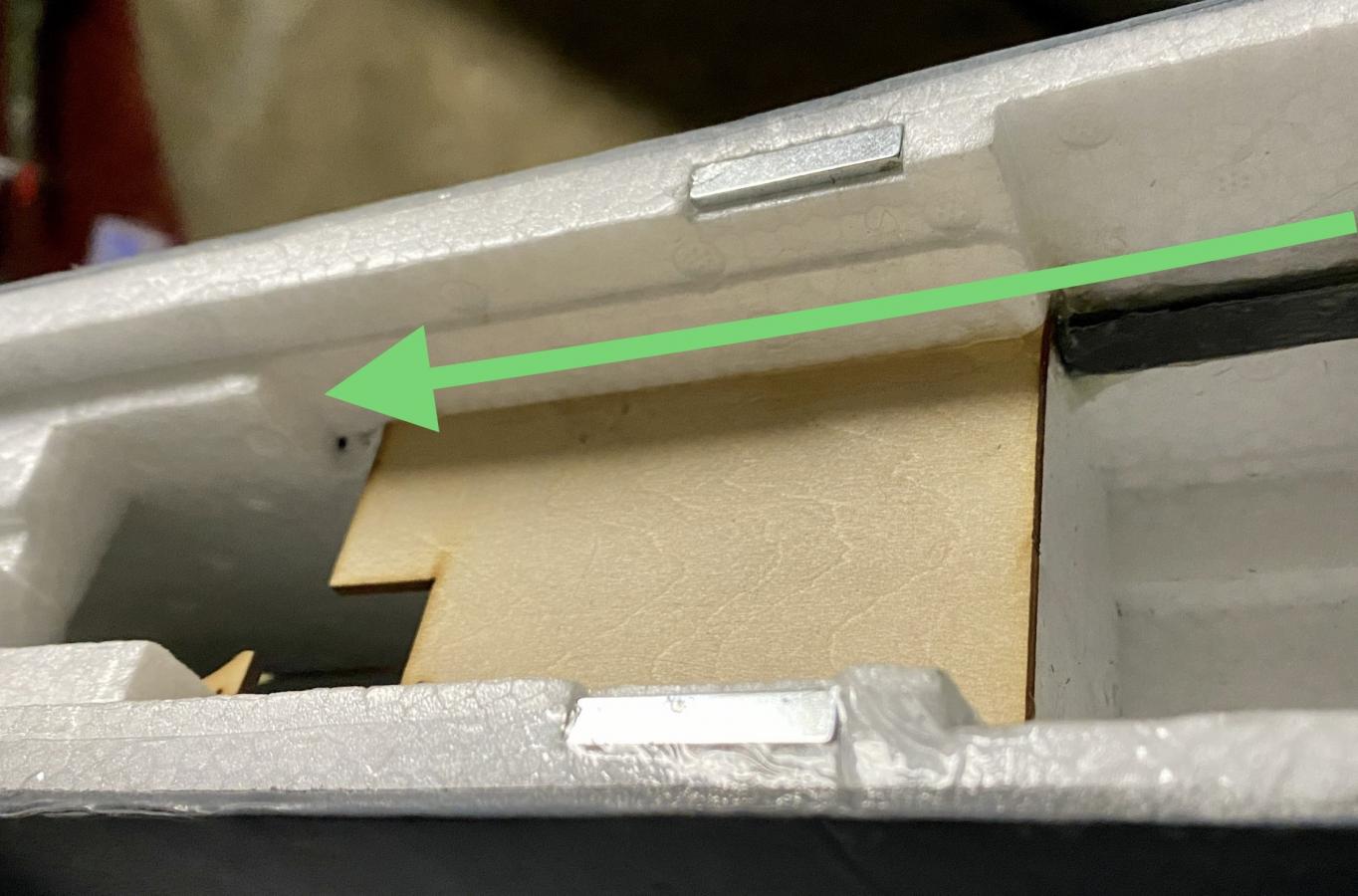

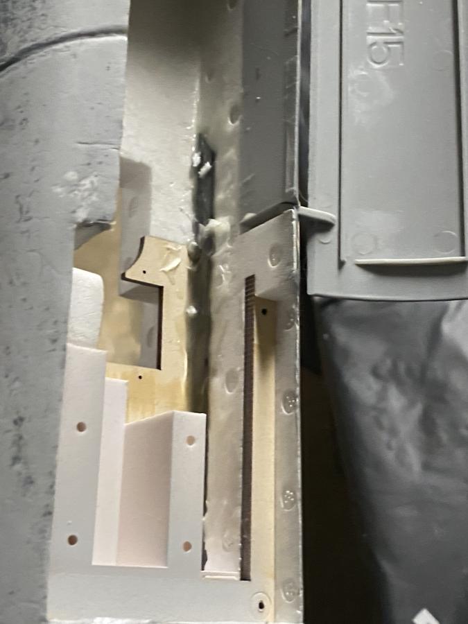

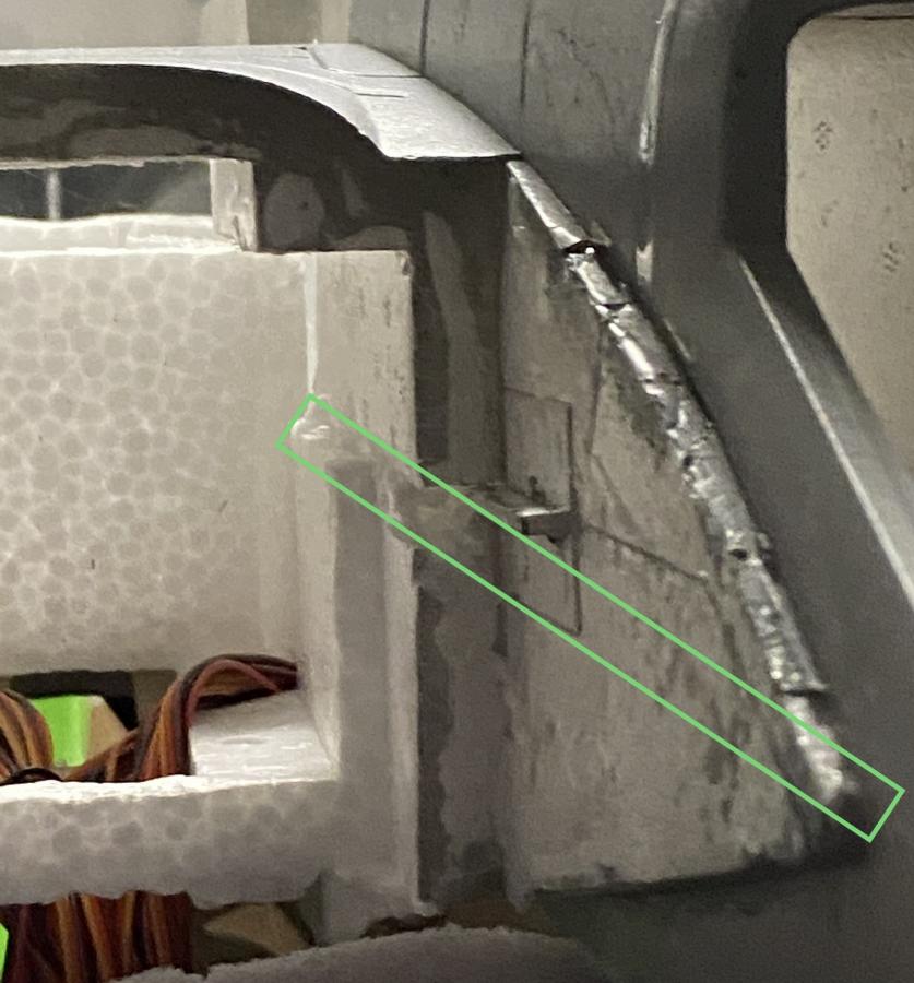

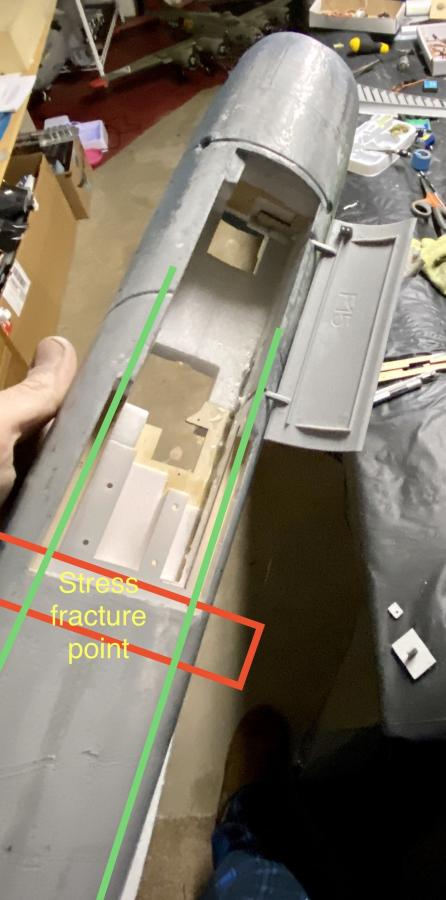

I had the same cracks around the nose gear mount, and one by the nose wheel door hinge. I had some carbon rod I imbedded in the foam to help strengthen these areas. I made pin holes in the cracks with a T-pin and injected some hysol epoxy I was using on another project. Filled the hole with some spackle and touch up paint. If it cracks again some light weight fiberglass cloth in these areas might help.
The nose is fairly flexible/weak. Ironically the same issue the full scale F-15 developed. This might be the reason for the gap you have.
There was a case where the whole cockpit on the full scale did just that and came apart just in front of the air intakes.
Is it possible to heat the nose with weight on it to move it? Takes a lot of upward force on the nose to get the canopy to latch. I don't think the latch pin will hold that much pressure.

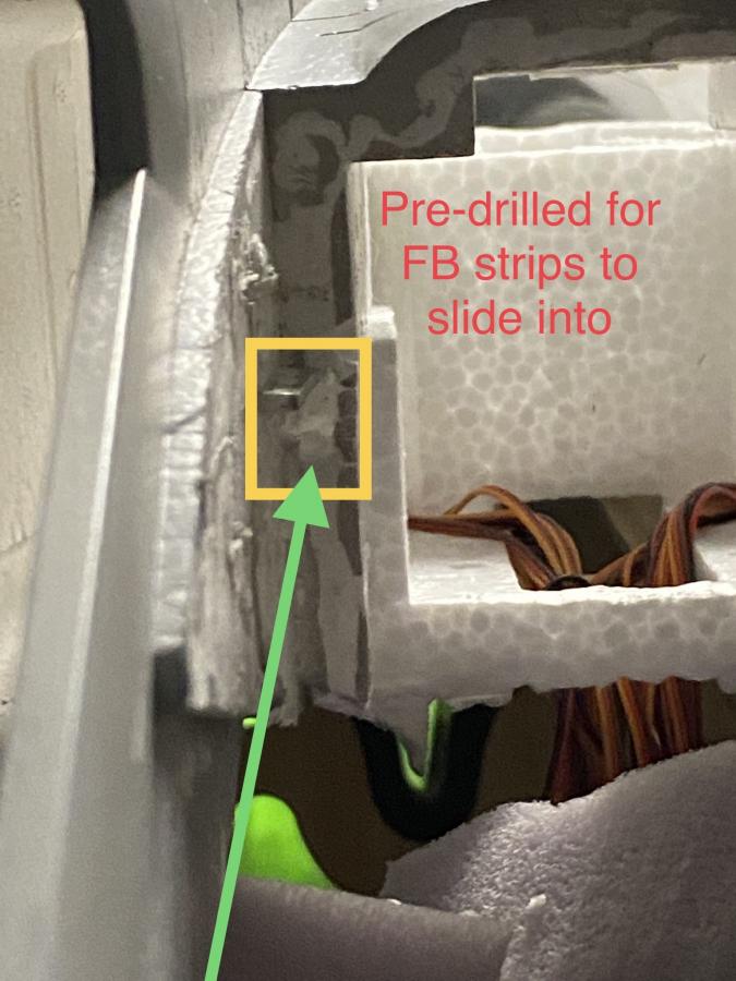

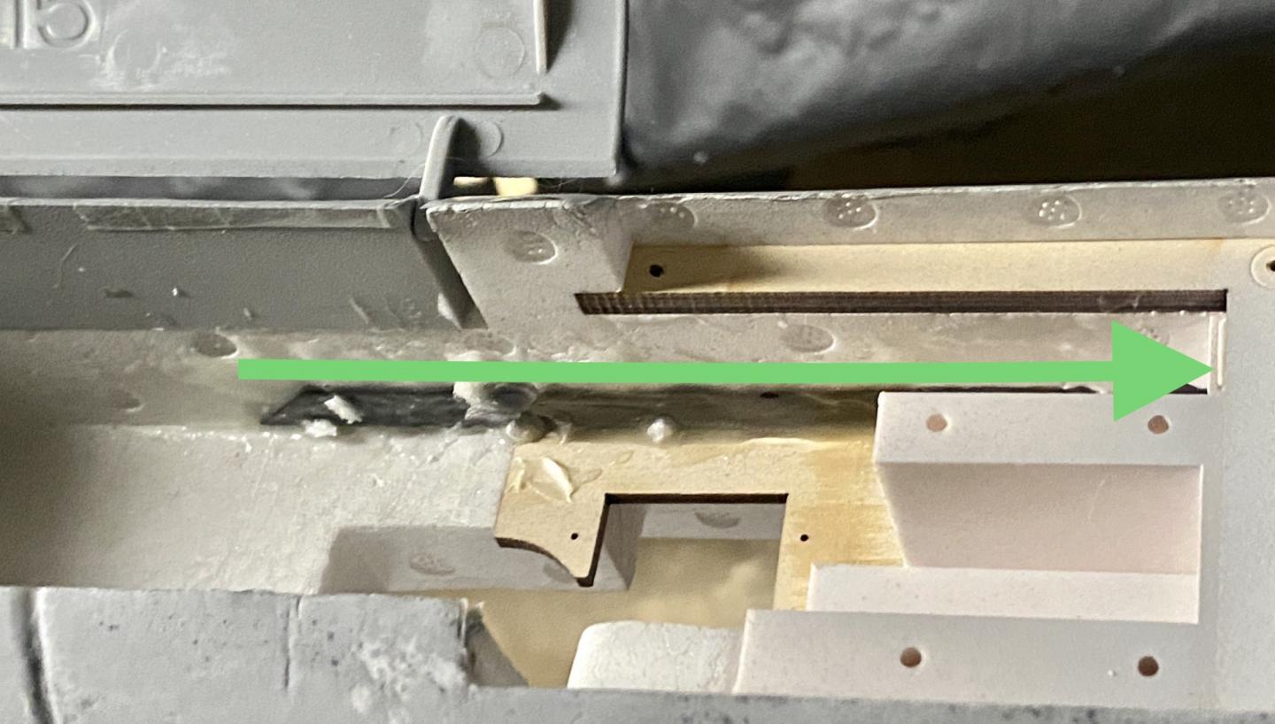

Did you glue the front section on already? I just did a rebuild of the nose area on mine just to keep that area strong enough to fly off grass with 8S. My first few landings were a learning experience (stock 1550kv) and that section looked similar after not maintaining enough speed on landing a few times.

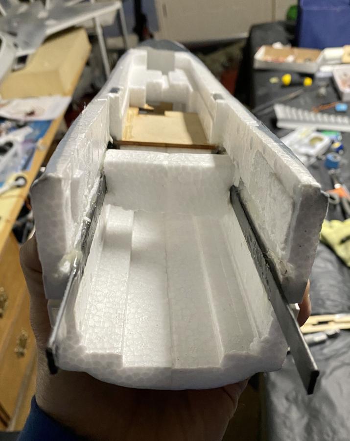

I had some CF strips that I preinstalled along the sides of the inner fuselage from a few inches before the NLG block. I also wrapped the new nose with Thin vinyl. I removed the nose weight to compensate a bit weight wise. You can add a little upward force to the nose section when epoxying it together with the fuselage to eliminate some of the flex that creates a gap in the canopy latch area.
It came with the nose glued on. Guess I can weight the nose to get it how it needs to be, then glue in some c.f. reinforcement. What glue did you use to attach c.f.?

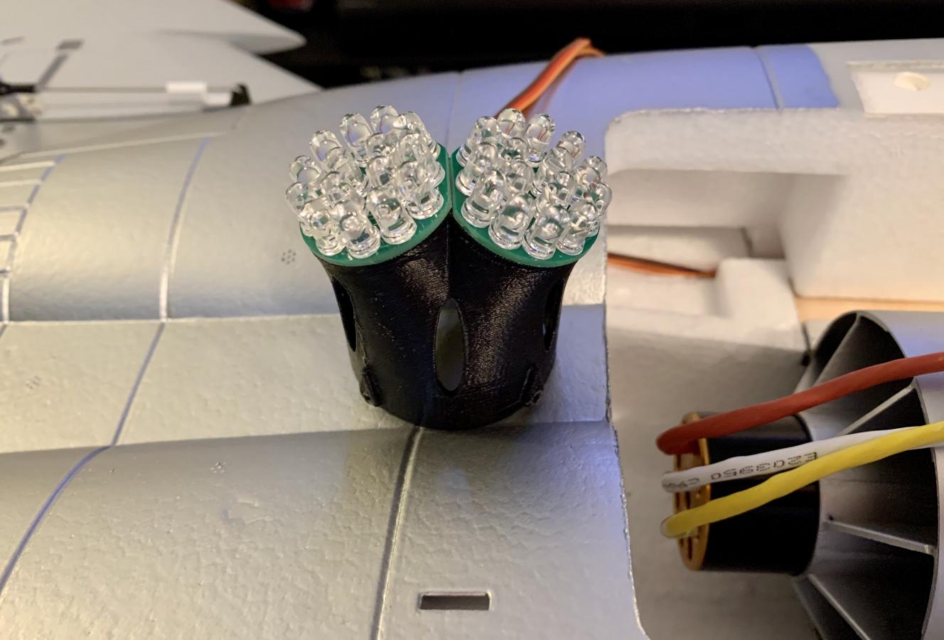

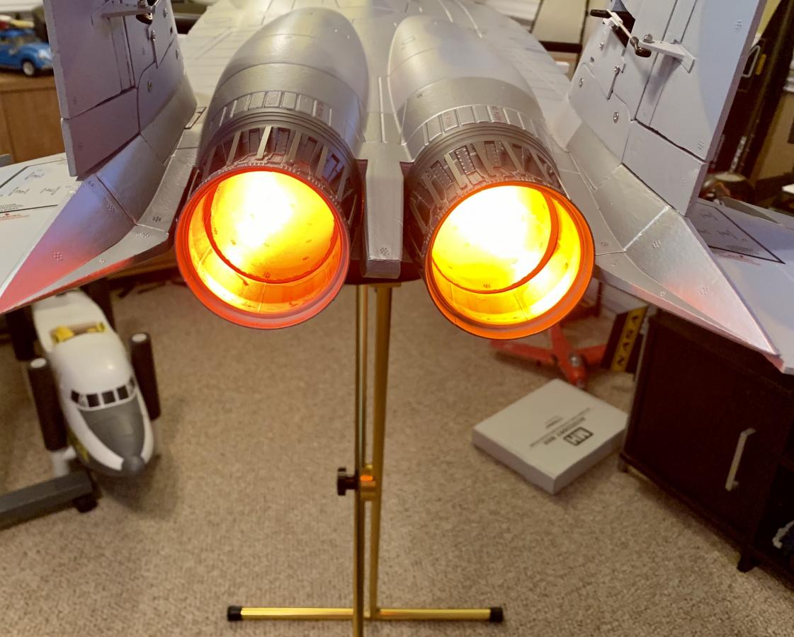

Put five great flights on the F-15 today. The jet flies great, nice scale presence in the air. Landings are fun and very realistic looking. I installed one of The RC Geek multiburner simulated afterburner dual light systems. It really adds a lot to the jet, the flicker as it turns on/off is awesome. Thanks Chris for making these available.
Looks awesome, have to say I do miss mine, sold it after several flights to get something else, might have to pick up another one, landings are the best, very scale with that nose high AOA.
