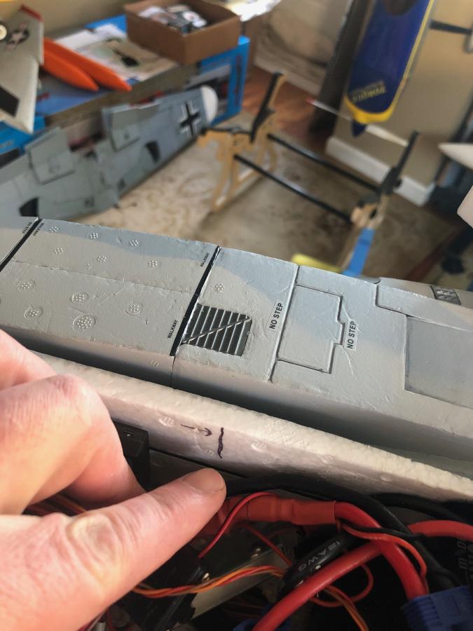

I’m expecting the 6s upgraded power system to arrive soon, the 1835kv Inrunner with the ZTW 155a ESC, and I’ve read it’s basically a drop in replacement for the original 1550kv setup. Besides pulling the BEC out are there headsup item or issue, beside CG adjustment to be aware of?Comment
The CG will shift a lil rearward but nothing to worry about. Just put the battery in the same place as before and you should be fine. I maidened one for a fellow club member and it was an amazing flying machine with that set up!I’m expecting the 6s upgraded power system to arrive soon, the 1835kv Inrunner with the ZTW 155a ESC, and I’ve read it’s basically a drop in replacement for the original 1550kv setup. Besides pulling the BEC out are there headsup item or issue, beside CG adjustment to be aware of?Check me out on youtube at https://www.youtube.com/user/gooniac33
I am an RC addict and innovator that loves to share my knowledge with those that need help. Ask me anything via PM if you need help! Check out my Website here https://www.gooniac33.me/Comment
I just kept the stock 130 ESC in mine, many flights with no issues and the 1835 does add more weight to the tail so be careful and check your CG again before flight.I’m expecting the 6s upgraded power system to arrive soon, the 1835kv Inrunner with the ZTW 155a ESC, and I’ve read it’s basically a drop in replacement for the original 1550kv setup. Besides pulling the BEC out are there headsup item or issue, beside CG adjustment to be aware of?Comment
