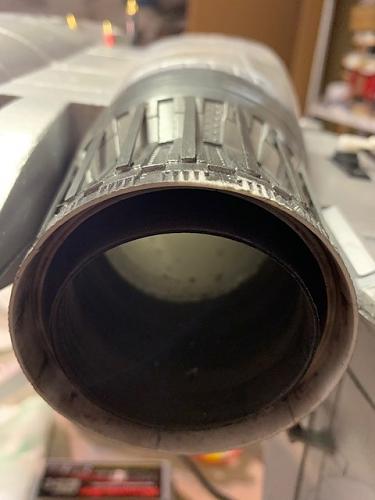

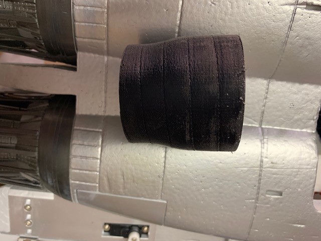

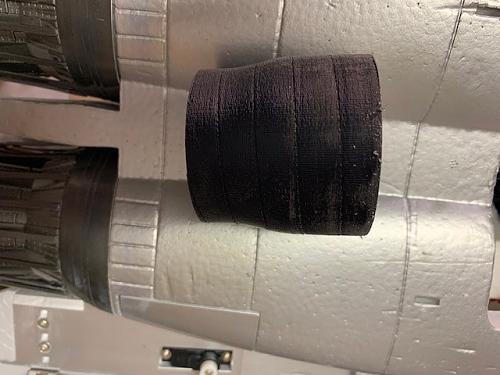

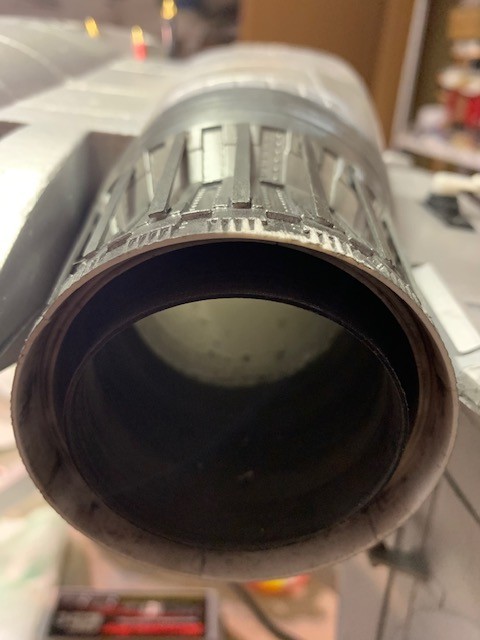

                                  • Cape Jets Another thing to consider: Unless it has been changed by the factory recently, the outlet area of the FW F-15 is way too large! I'd suggest to measure the outlet area of your F-16 and compare it to the area of your F-15.Mine is running on an 8s Wemotec setup and I added two nozzle inserts to reduce the outlet area.
