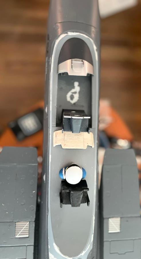

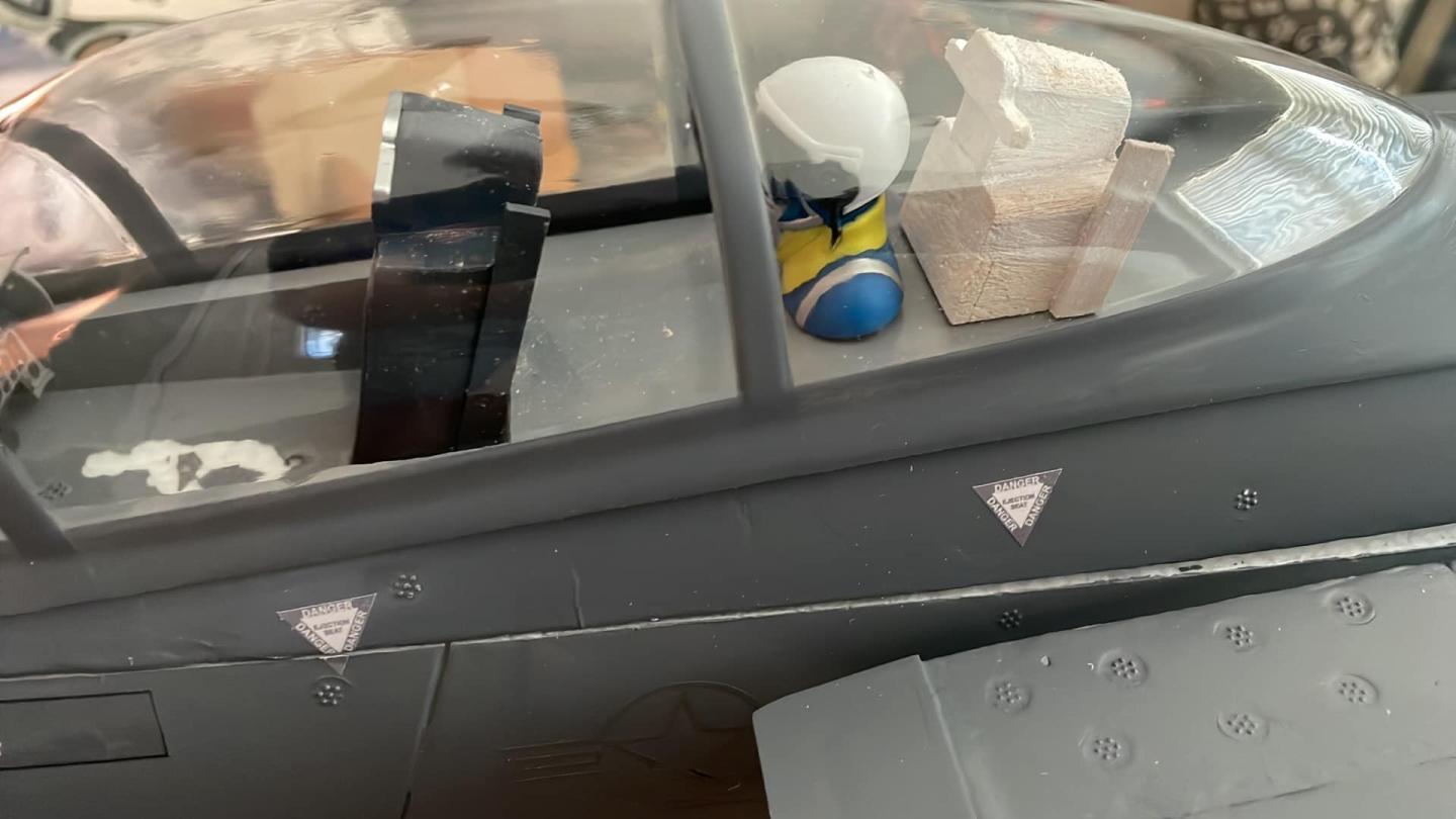

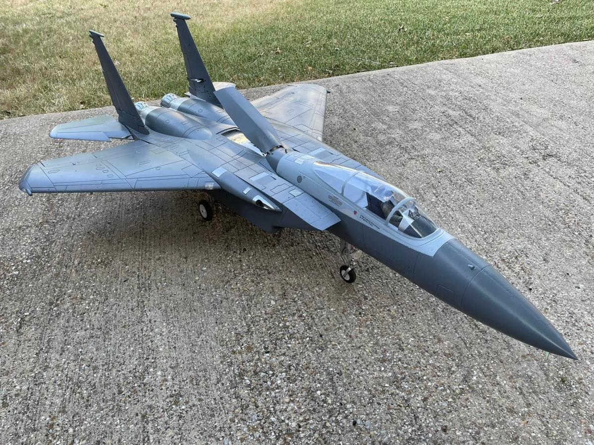

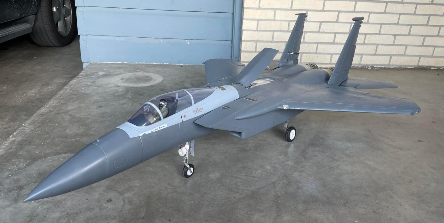

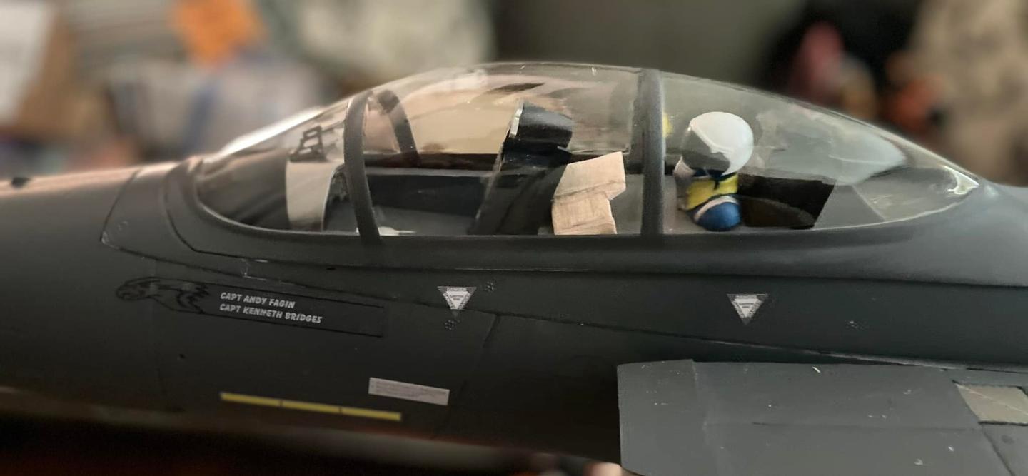

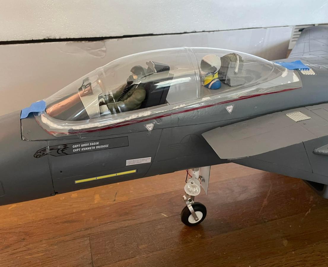

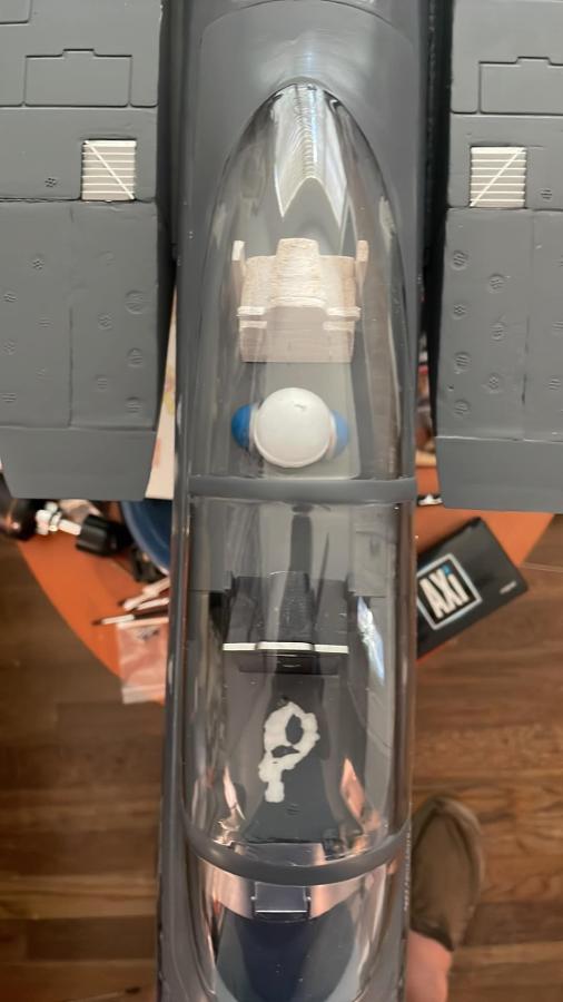

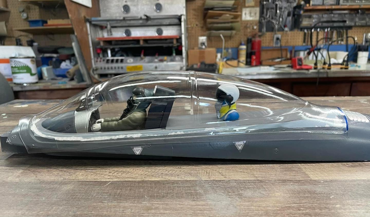

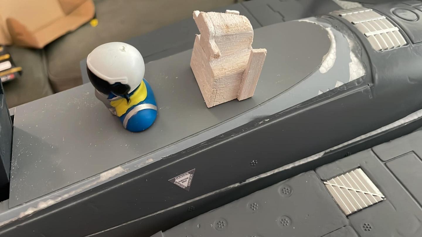

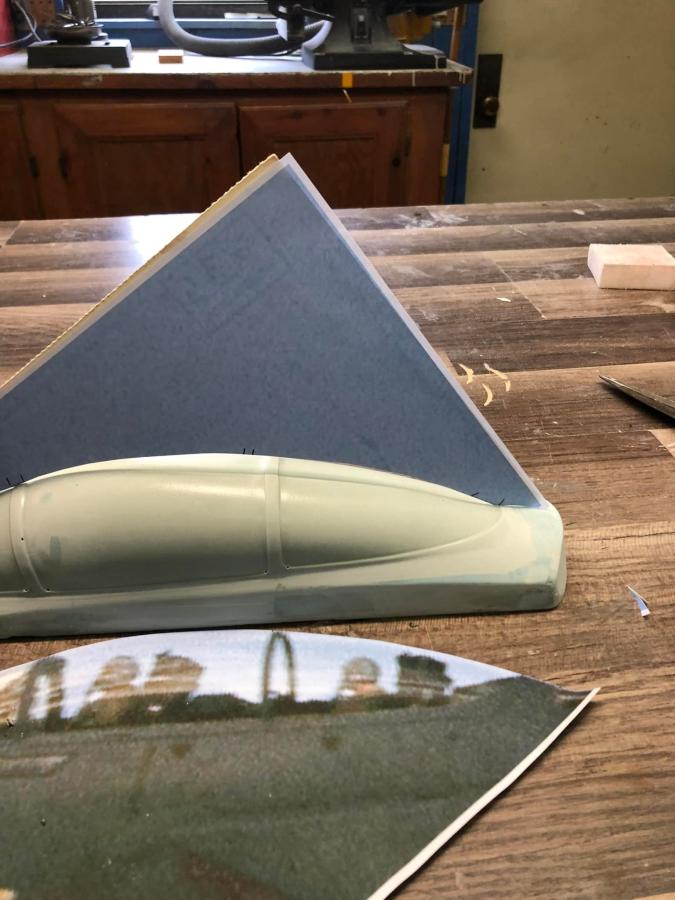

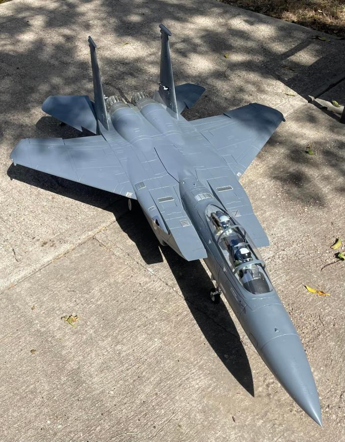

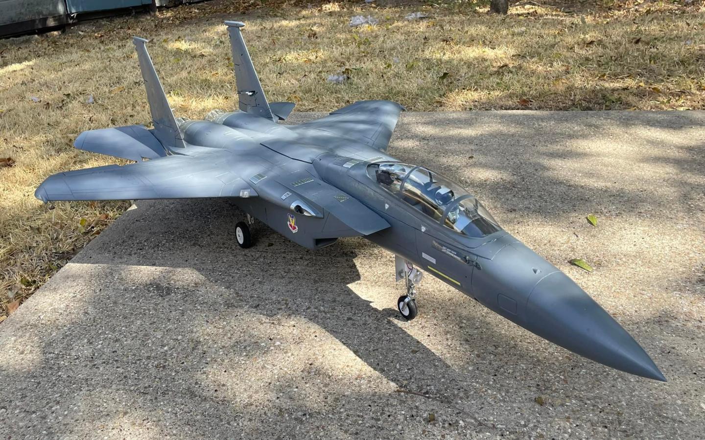

  • Same Great Plane..... Just a new canopy, repaint, and some Strike Eagle influence.
    2 Seat Direct replacement canopy available from Keith "Sparky" Sparks for just $7.00 at www.parkflyerplastics.com https://parkflyerplastics.com/cart/i...roducts_id=894

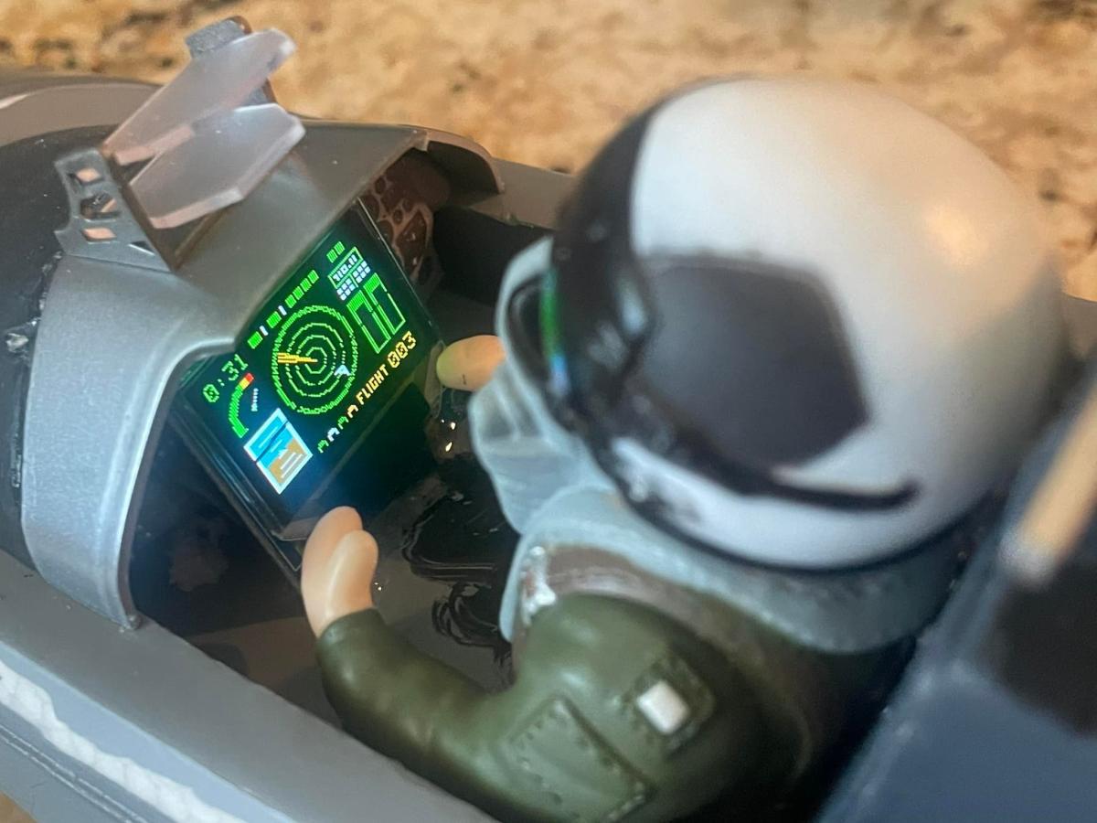

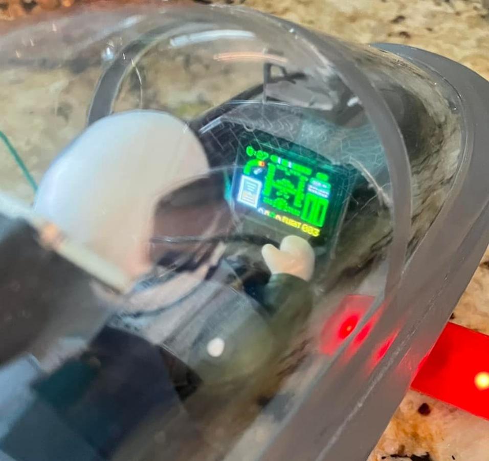

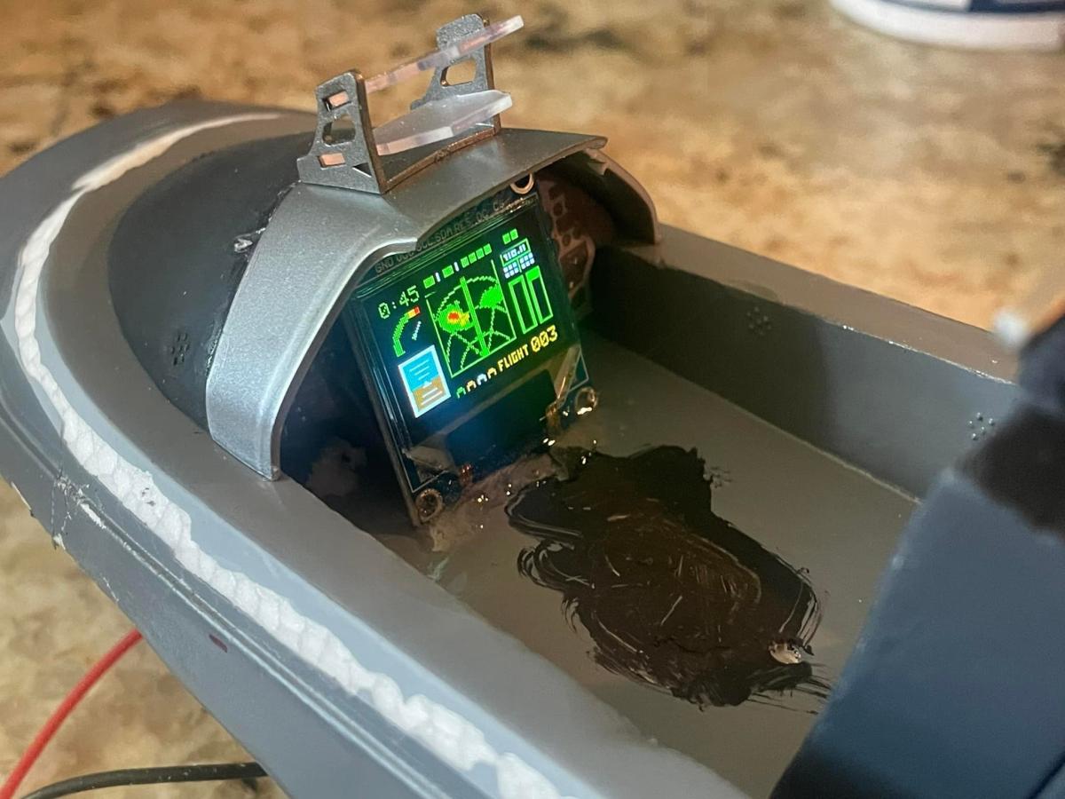

    While i was at it, couldnt resist adding the digital dash from StemWings. https://stemwings.com

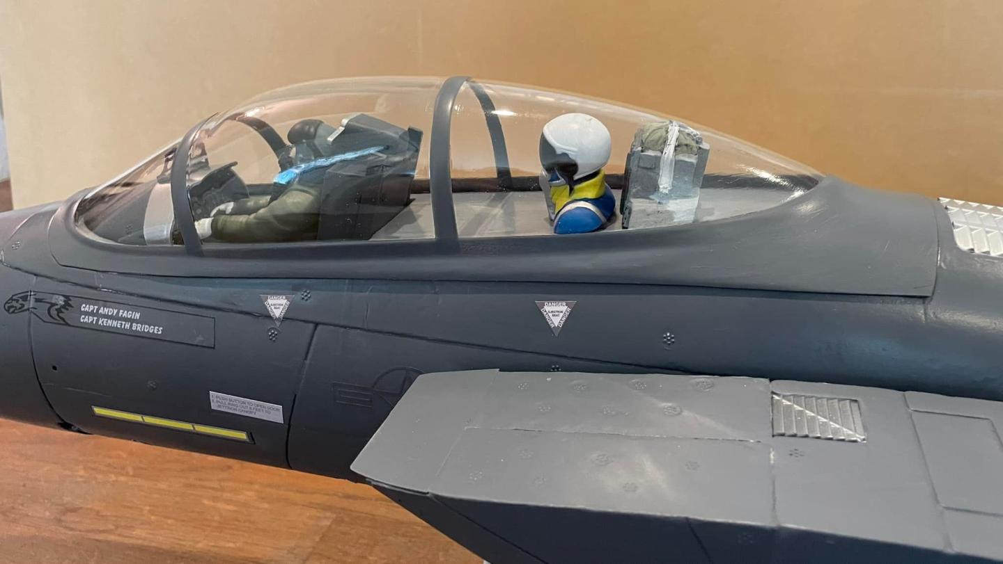

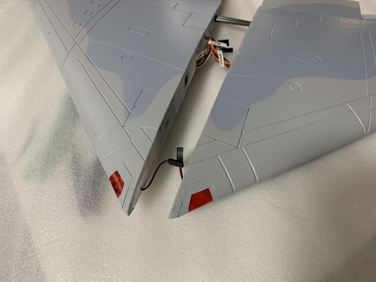

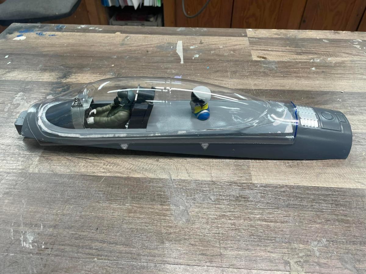

    • More F-15E influenced refinish

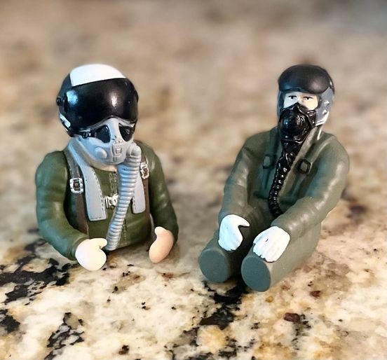

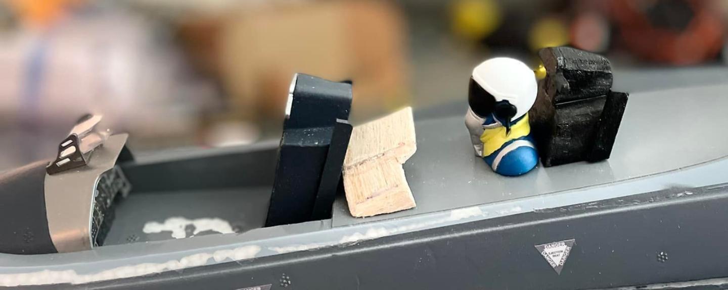

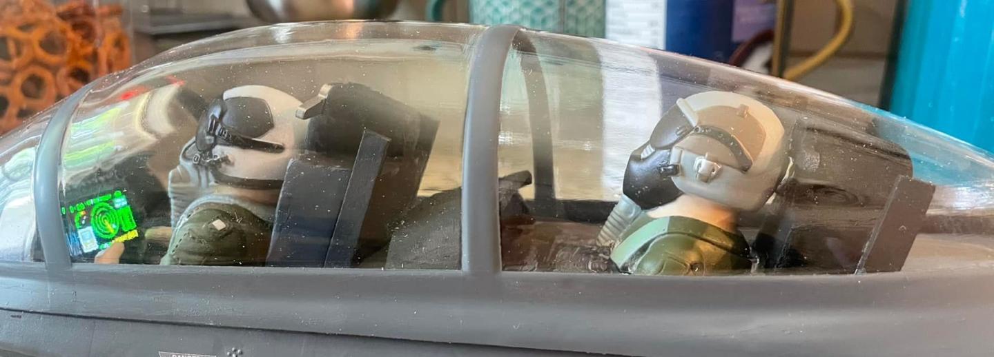

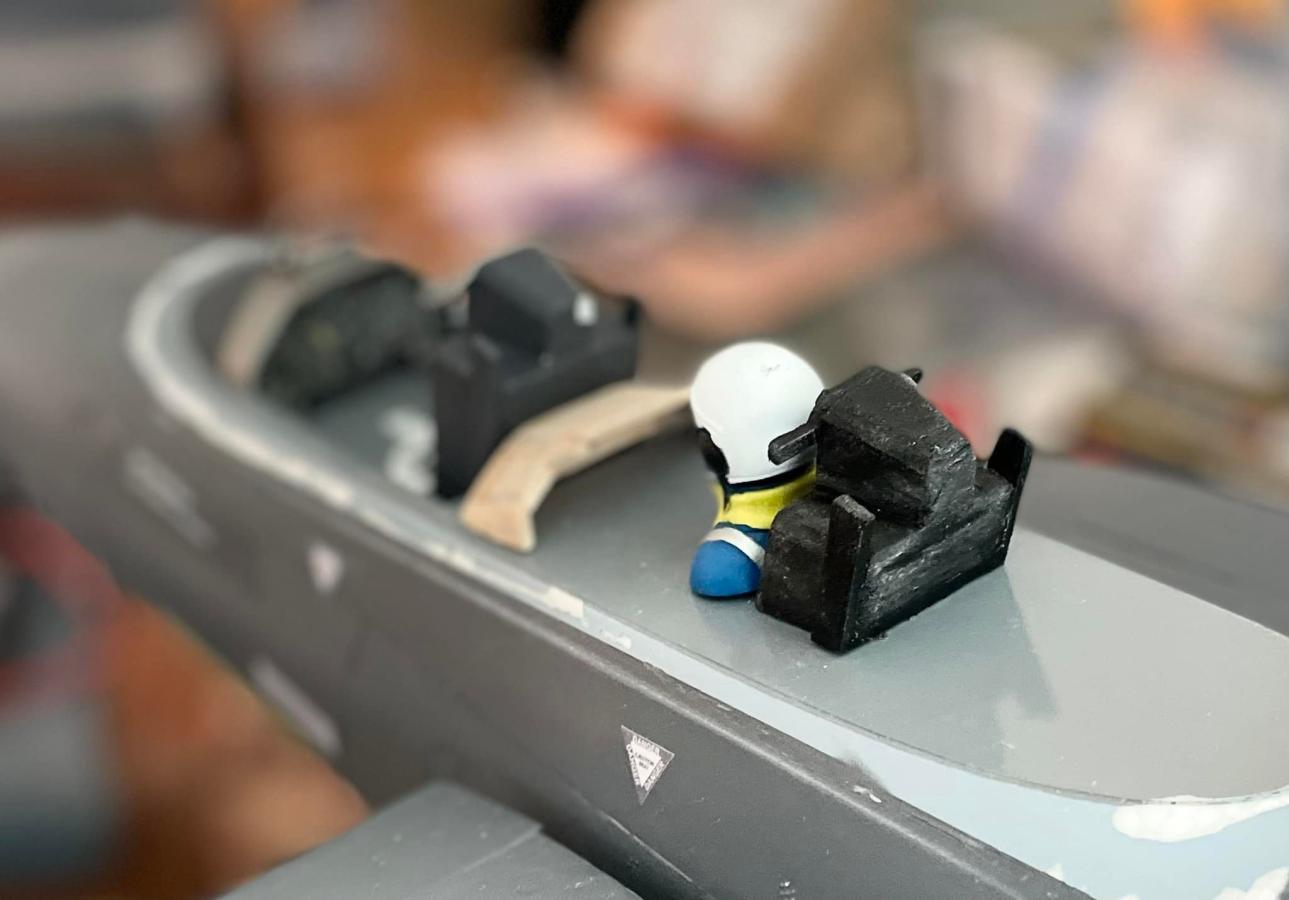

      • I ended up replacing both pilots as the stock pilot (right) doesnt seem to be available from Motion as the spare part pilot listed for the F-15.

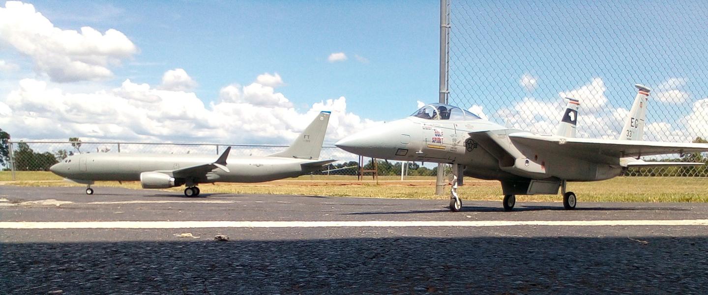

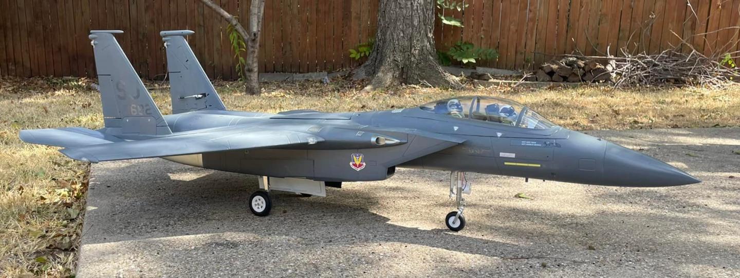

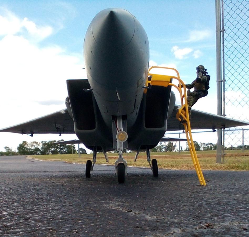

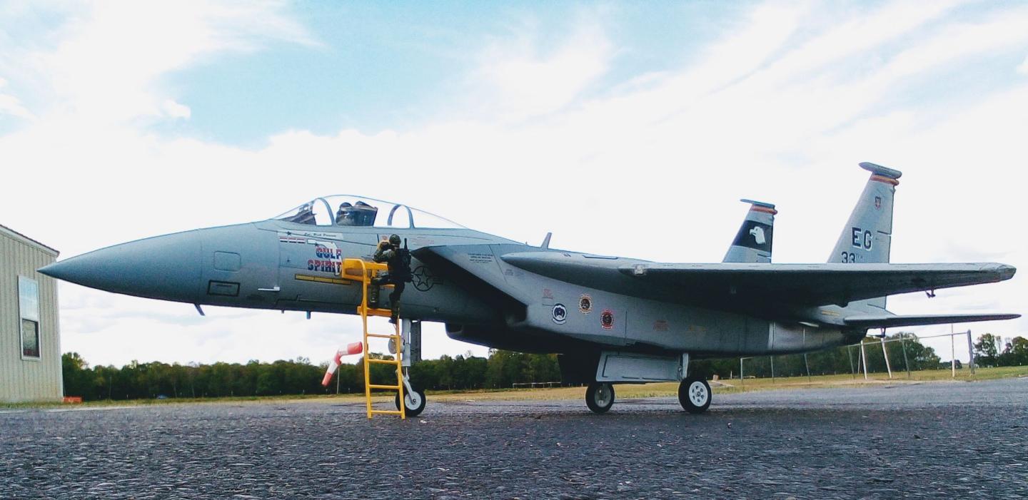

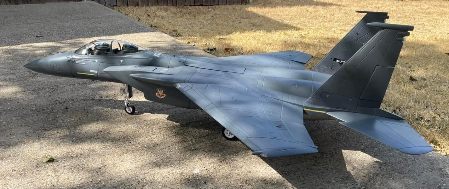

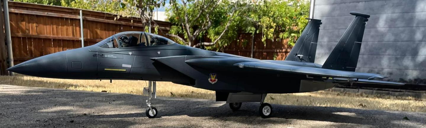

ID:	352292 My 16 th freewing jet , fast , stable, landings are easy, no power and 1/2 flaps

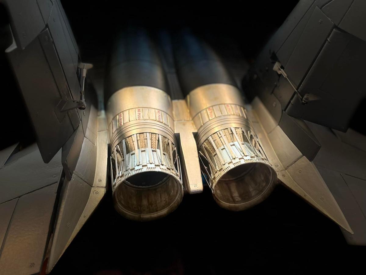

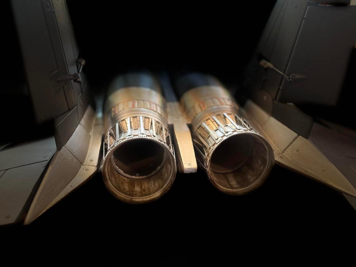

          • Probably the best detail I've seen on a freewing e
            • Dang phone, meant Jet!

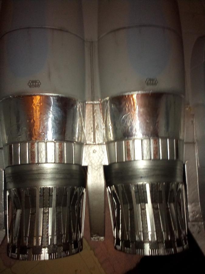

              • Jdcrow Great detail modifications. Diggin' the exhaust nozzles and the cockpit mods. nicely done, Sir. Best, LB

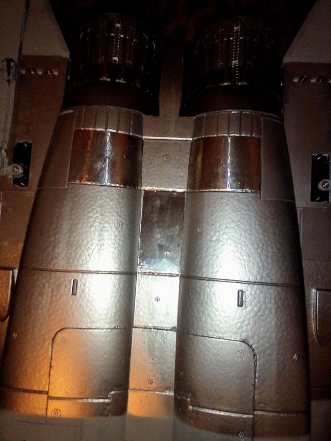

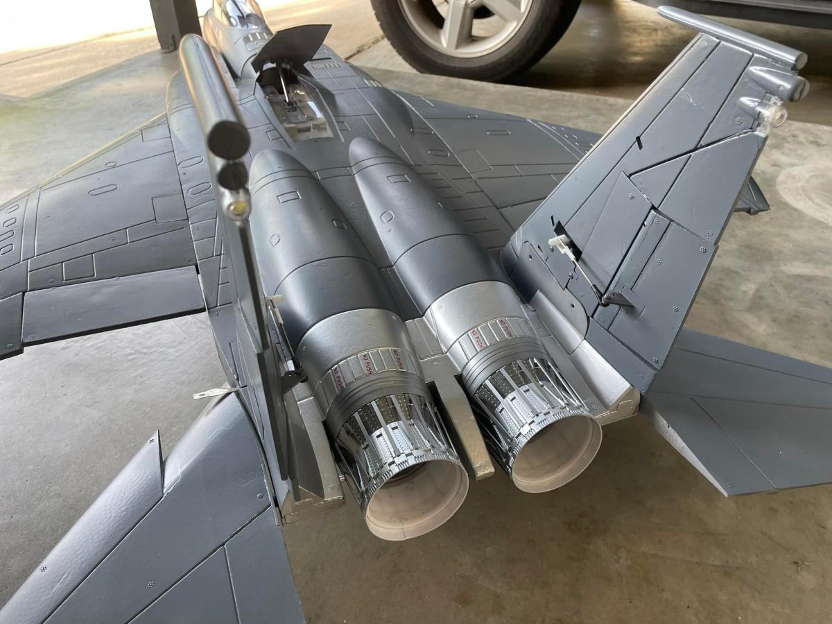

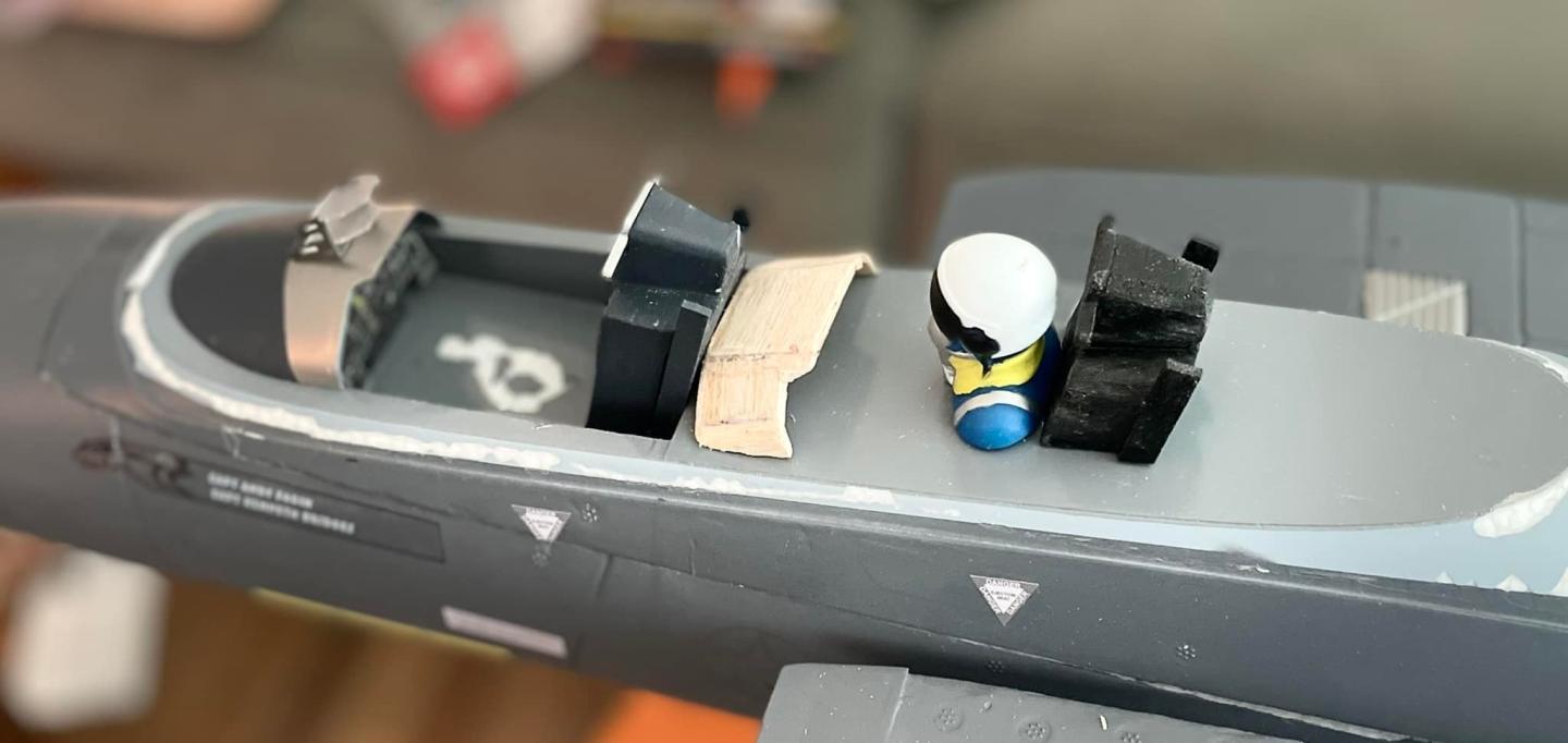

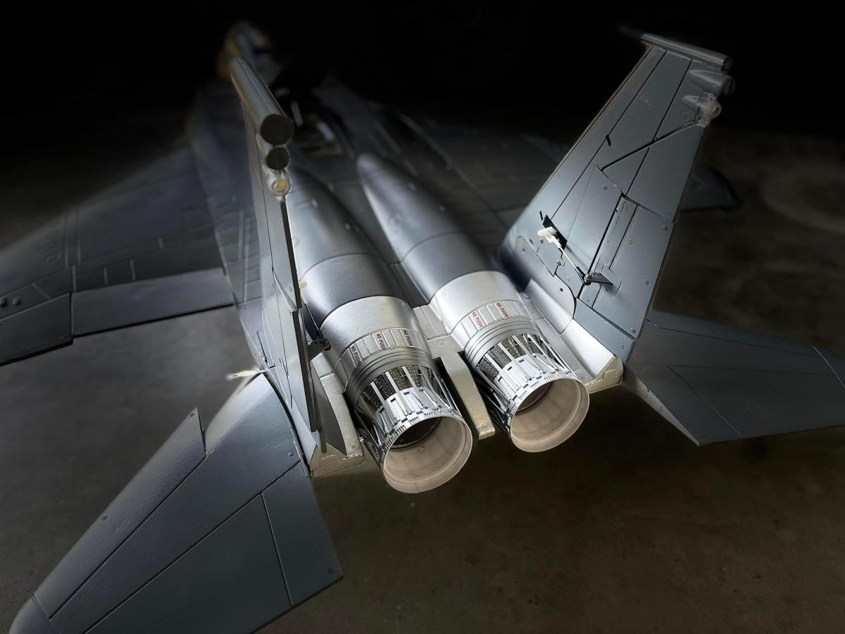

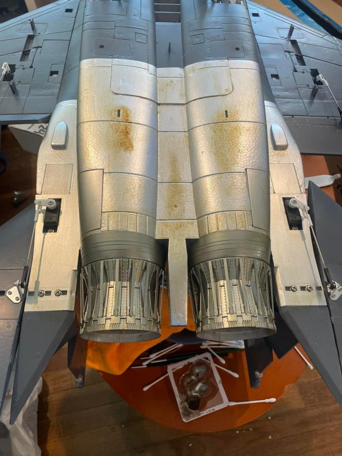

                • Little eye candy
                  • Aluminum tape
                    • Capt G Very nicely done, Sir. Looks authentic to me. By the way, welcome to "The Squawk". Best, LB

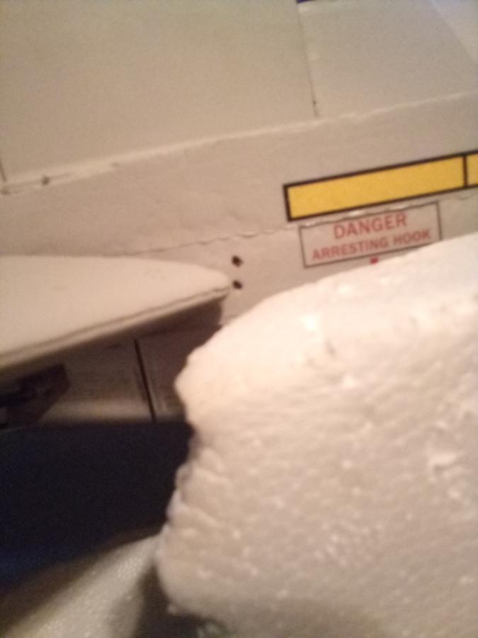

ID:	368834 C G by book ,rates by book but I do 75% on ailerons for low, elevator neutral in pic top dot recommended bottom dot after flight trim. ( Notice seam , bottom dot is between seam and fuse bottom) half flaps elevator mix is zero, full is 10% . flairs great. I land power off half flaps , my style.

                                  Perfect, all I needed Capt.G. Awesome thx a lot.!

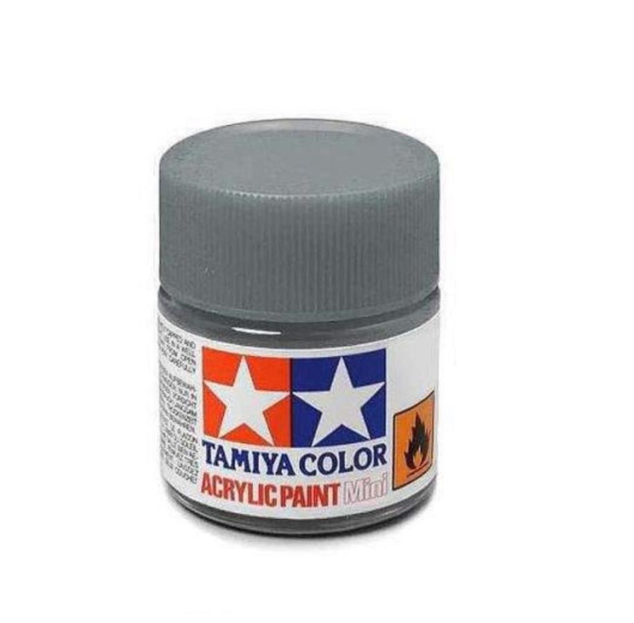

ID:	369036 Hi there, is there a good acrylic grey color match to use with the airbrush? tamiya, hobby color, mr.paint... or so? thank you

                                      TD, that's a good question. To match the OEM colors, I go to Home Depot with a panel from the model and have it color matched in exterior latex sample size jar. But to airbrush that is difficult, ask me
                                      how I know.. Hang in there, someone might have a answer for you; otherwise the HD Behr paint is a plan B. Best, LB

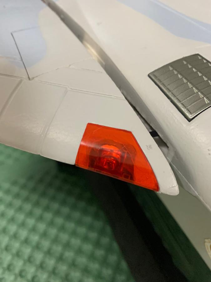

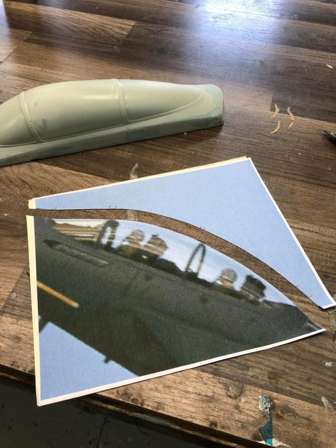

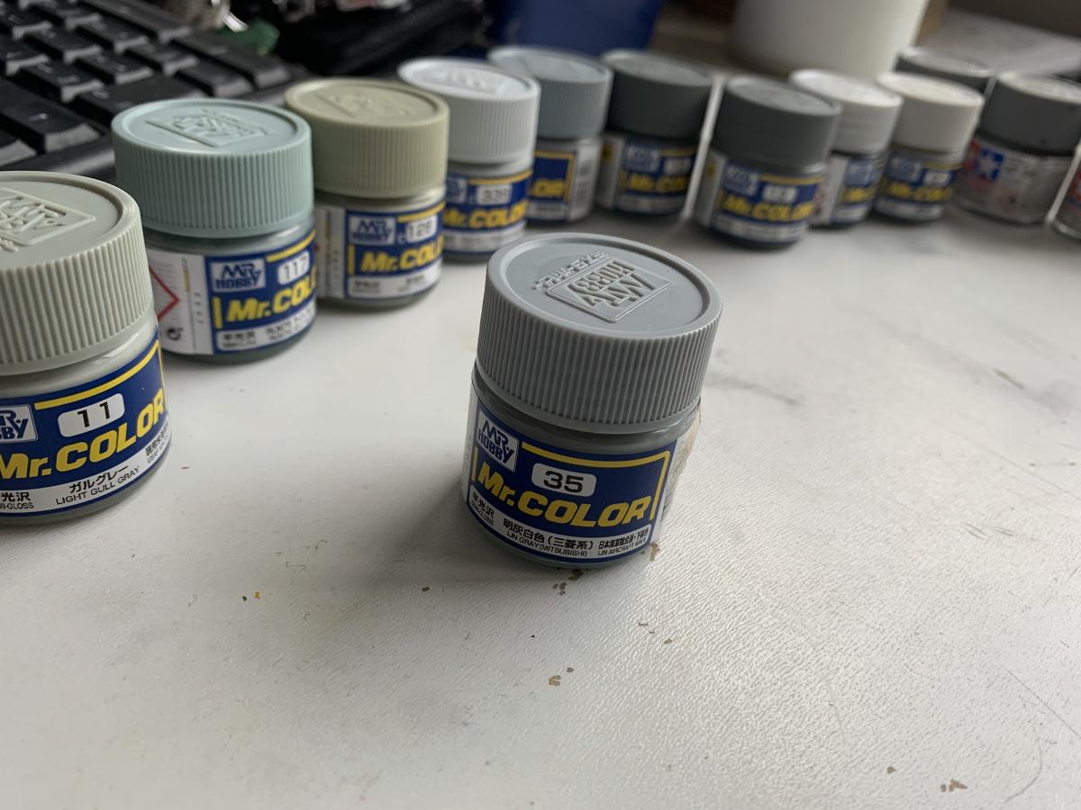

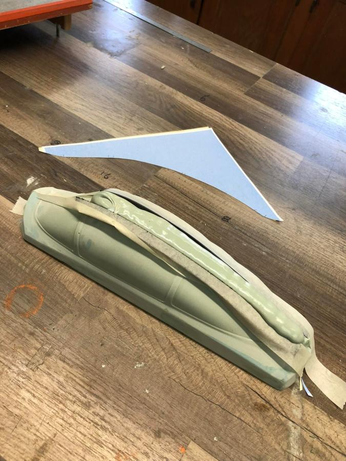

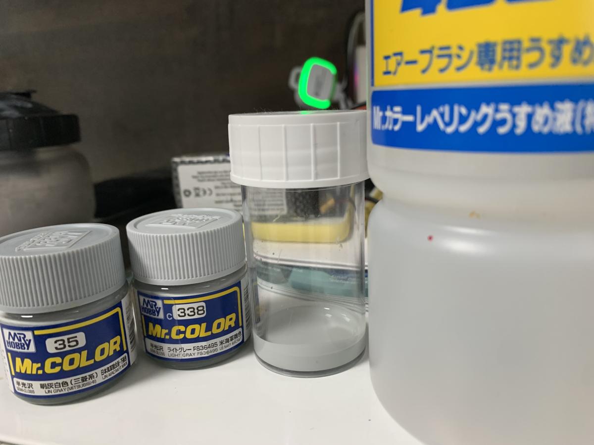

                                      • This mix worked out in order to make the covers to look more scale
