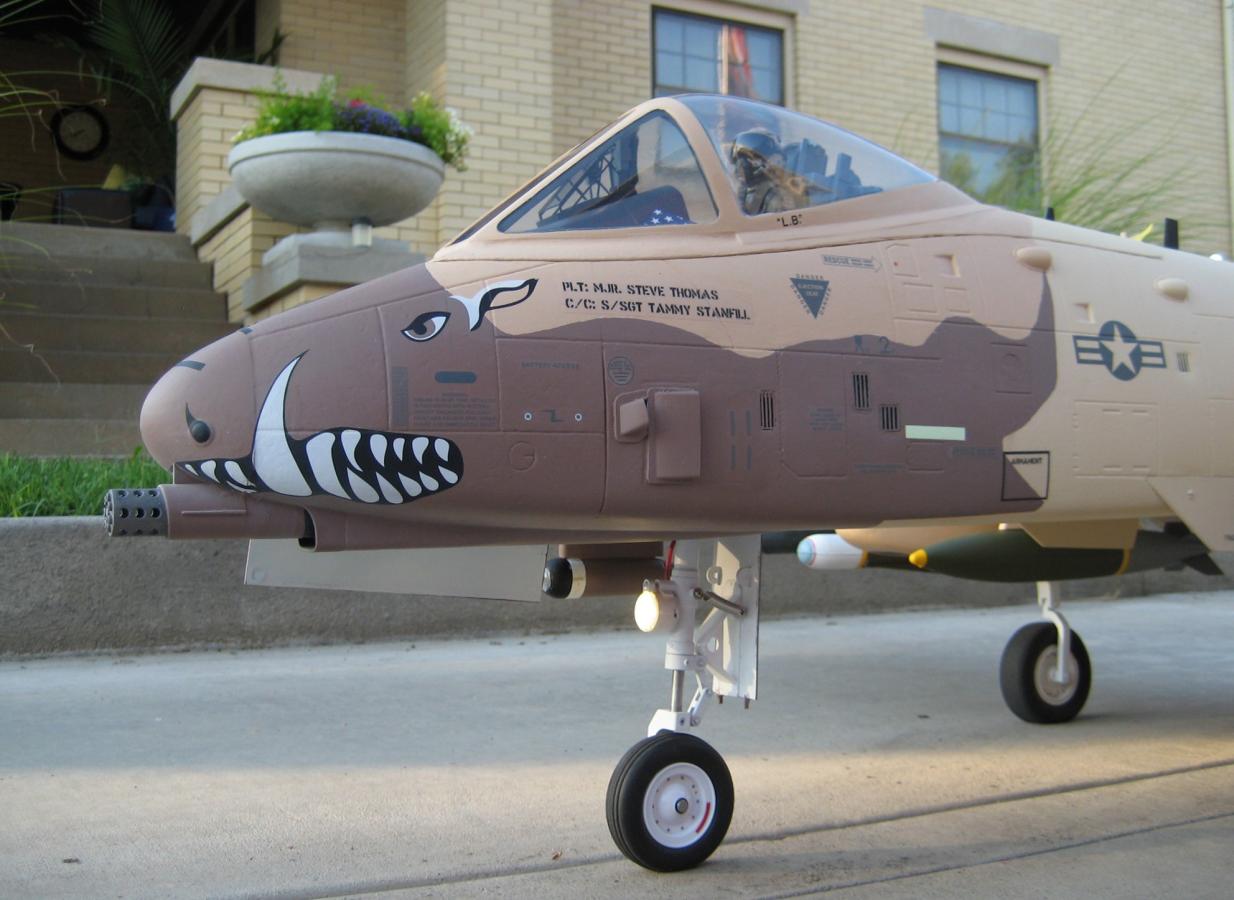

      DD, the A-10 is a kitten in the air. Short takeoff roll on pavement, however, the challenge is keeping her flying through touchdown.
      My first check flight, she was a buckin' and flyin' and buckin' and stallin' and buckin' ad nauseam.
      Results: Badly scraped wing tip, nose gear retract, axle pin, and front wheel replacement.
      All since repaired, but lesson learned.
      Point is power on landing which is actually easier anyway for me.
      The A-10 was my first aircraft after returning to RC after a 25+ years away.
      IMHO, Go for it.
      Best, LB

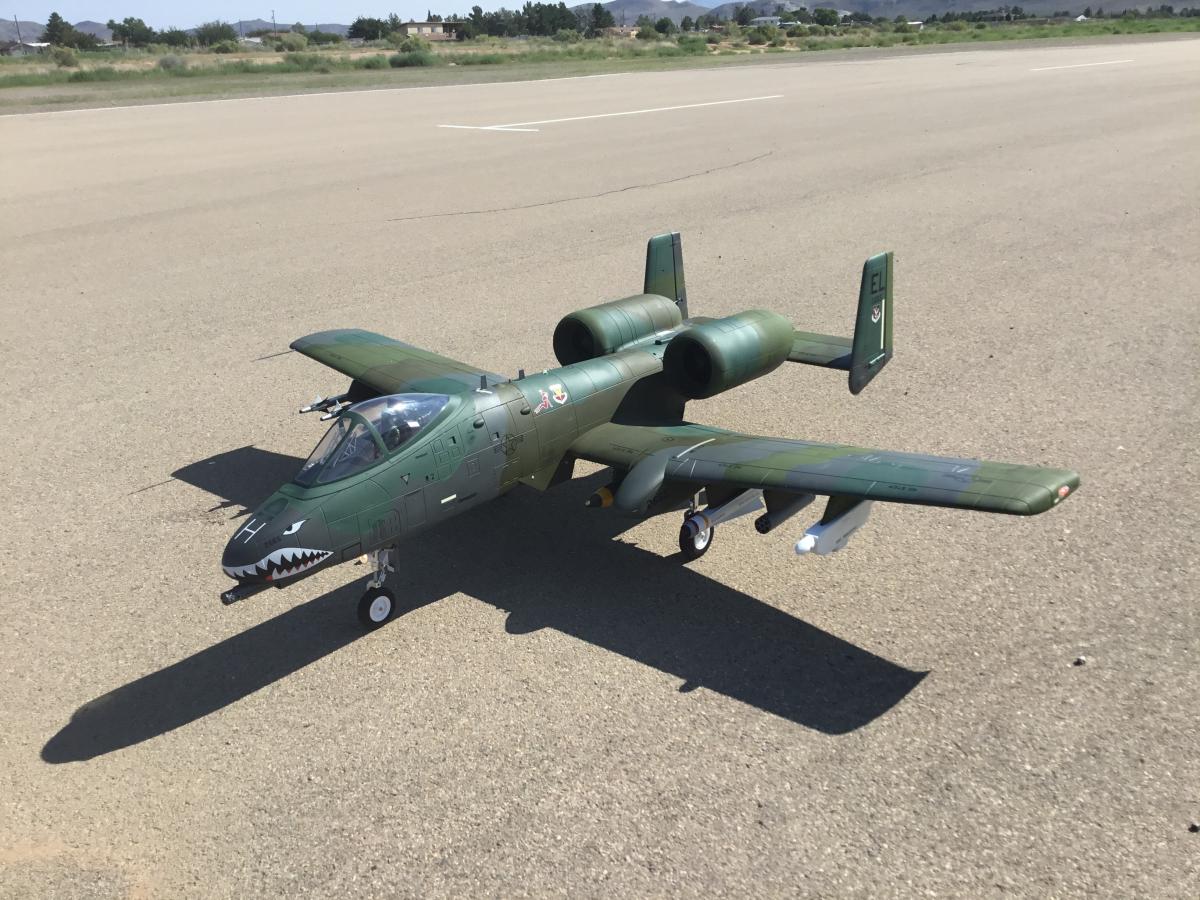

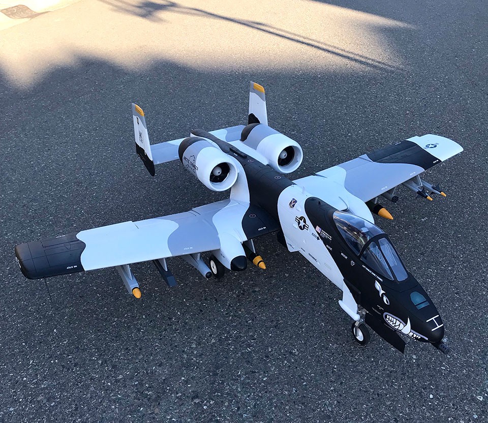

          I own both the F-15 is a dog and underpowered. The A-10 is awesome from a to Z.

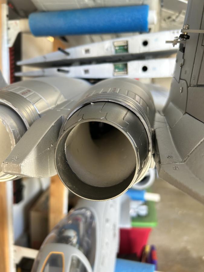

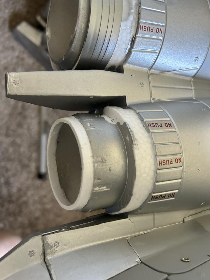

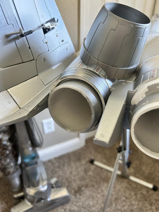

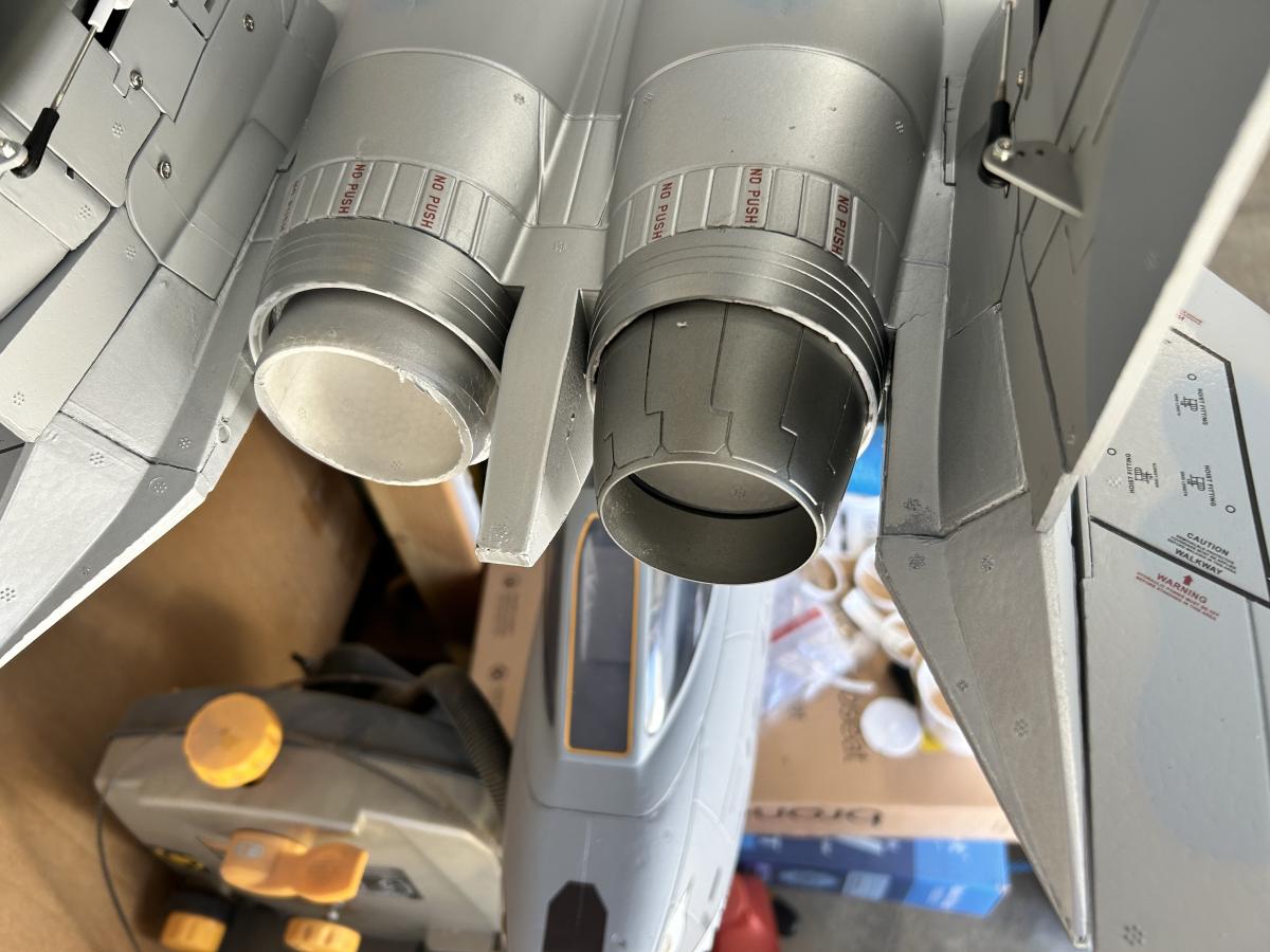

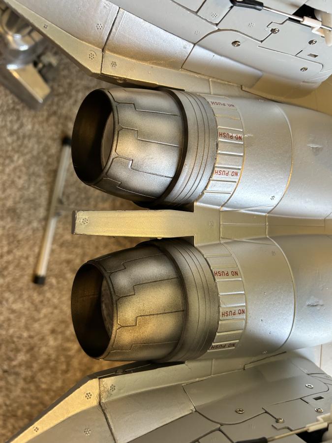

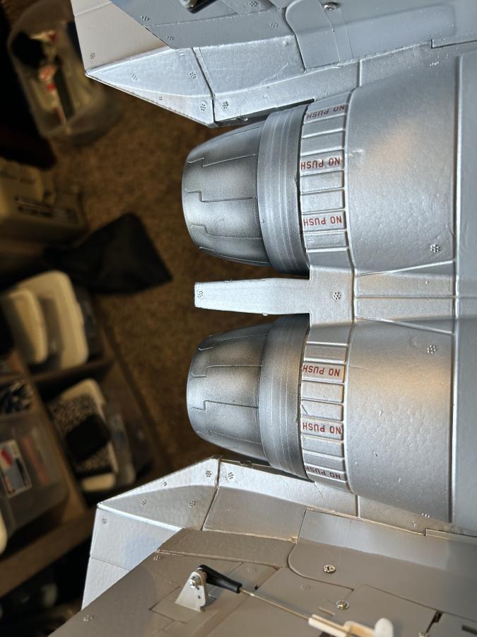

                            • I’m currently in the middle of a nozzle mod. I’m combining the stock nozzle base with the last part of the F-18 nozzle.
                              the foam opening on the Fuse is 60mm the opening at the end of the stock nozzles are 65mm. The opening on the F-18 nozzles are 55mm.
                              I’ll test unit again with GPS with both EDF units again after I get the nozzles done.
                              interesting note, the new F-15EX have similar nozzles to what I’m making.
                              Gravy

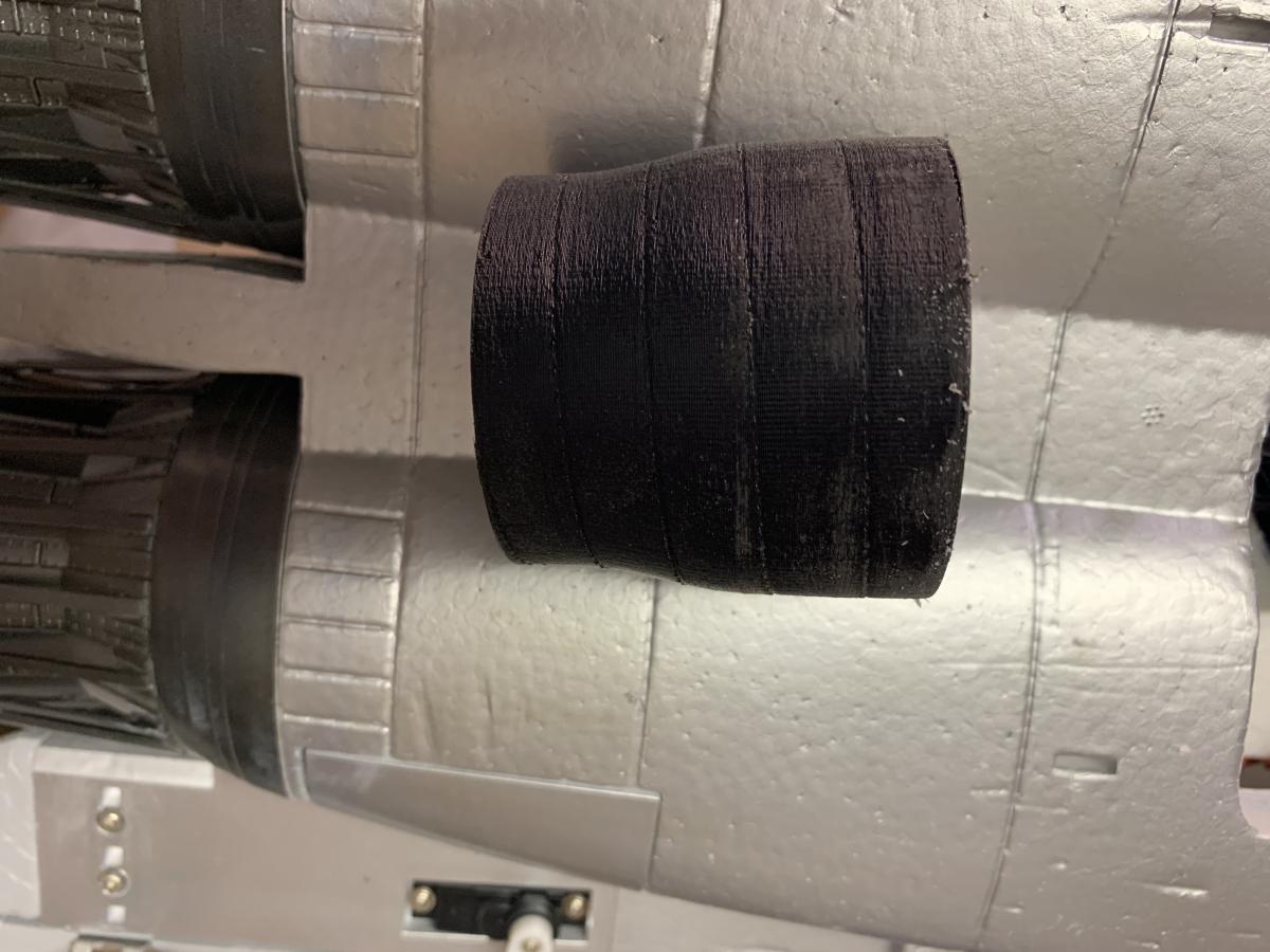

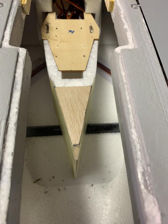

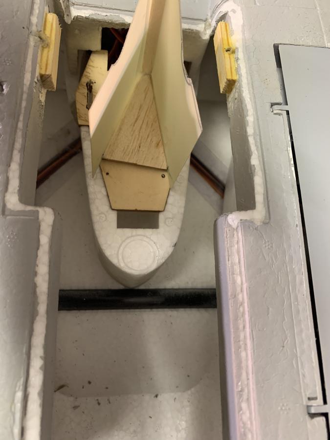

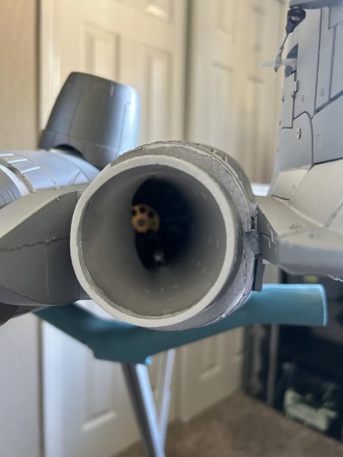

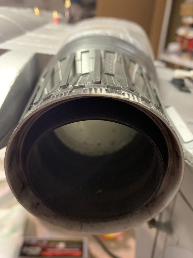

                              • Here’s my simple 3d printed solution plus another mod to the intake you might consider.

                                • After doing that did you keep the cheater grate or close it off?
                                  Gravy
                                  • Originally posted by Gravythe clown View Post
                                    Gravy
                                    Mostly closed, just two or three slots left open for ESC cooling. Intake area to feed the fan is sufficient.
                                    Frank

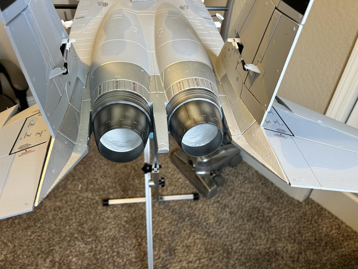

                                    • Nozzles all done. Now just need to test them out.
                                      Gravy
                                      • Well didn’t get to do any gos testing today, but I did take it up one time with the 6000 HRB. Not going to add any more than I noted two notable improvements, no data to back it up just how it felt and looked.
                                        take off felt much more alive, like it had authority and the vertical impresses myself and my buddy watching it.
                                        I was hoping to get 4 flights today but the wind had other plans. I almost didn’t even take it up the one time I did, but I just couldn’t resist.
                                        Now I’m really looking to get some test results.
                                        Gravy
