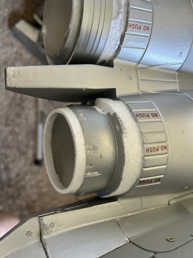

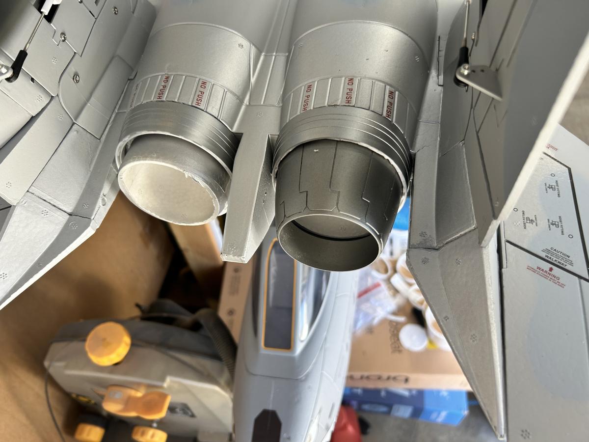

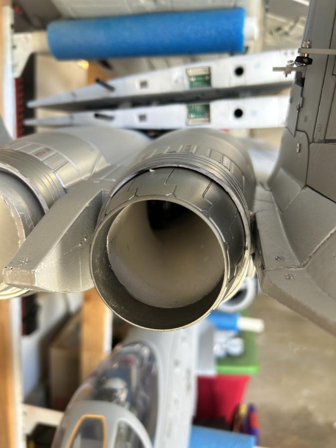

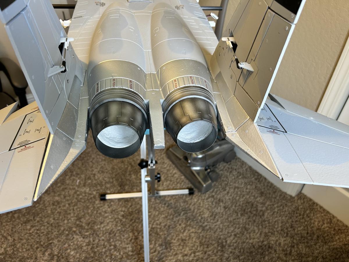

    Finally got some ghost testing and numbers. Did total of 6 flights today, 5 of which were tested and recorded in similar flights.
    I changed the nozzles to custom made kit bash of F-15 and F-18. I ended up with 55mm per nozzle.
    I switch between the 1900kv 9 bld unit and the 1960kv 12 bld units.
    I used 6000 50c 6s HRB’ and 5000 50c 6s HRB’s.
    My test flights were all conducted the same. Take off heading south, climb out to the right, level off in down wind backing off to 60% throttle, turning base to final and level off going upwind down the runway to the south and punching to full throttle. Hold full throttle until banking right to head back down wind. At this point I cross over and do figure 8 changing direction, now heading south back field back to 60% throttle, banking left to head north down the runway (about 25’ AGL) punching to full throttle, this time end of runway I go vertical keeping full throttle until it falls out. I the let it glide back down to level off again about 25’AGL now heading south. I punch it full throttle and at the south end of runway I go vertical again until it falls out.
    After that I drop back down fly three right hand circuits. One is a cool down about 50% throttle, second is gear check, third is half flaps dropping full on final.
    One test I had two bad approaches because of wind gust. That’s why the longer flight time. My timer is set to 3 minutes, but I also use battery cell call outs.
    Results.
    1960kv 12bl
    1, 6000 flight ended 33% left
    Wind: 2.5 SSE, top speed recorded 103 mph, top altitude 270’ AGL, time 3 minutes.
    2, 5000 fight ended 30% left
    Wind 2.5 S, top speed 108 mph, top altitude 367’ AGL,
    Time 0:02:50 .
    3 5000 flight ended 22% left
    Wind 3 SSE, top speed 104 mph, top altitude 496’ AGL, time 0:03:30
    1900kv 9 bl
    1, 6000 flight ended 28% left
    Wind 3.5 S, top speed 102 mph, top altitude 227 AGL, time 4 minutes
    2 5000 fight ended with 32% left
    Wind 3.5 S , top speed 98.6 mph, top altitude 397’ AGL, time 3 minutes.
    I am happy with what I got out of my nozzle mod and the new 1960kv 12bl until.

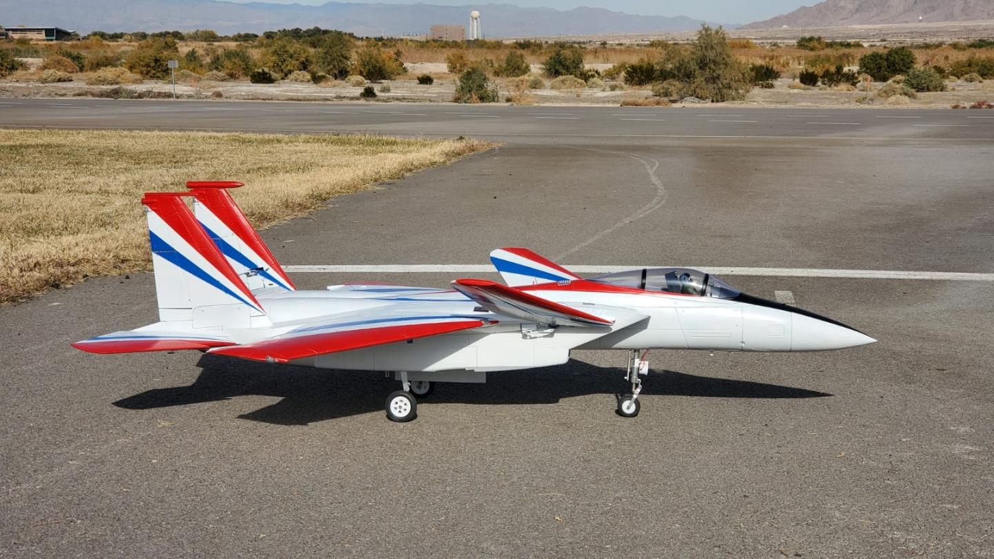

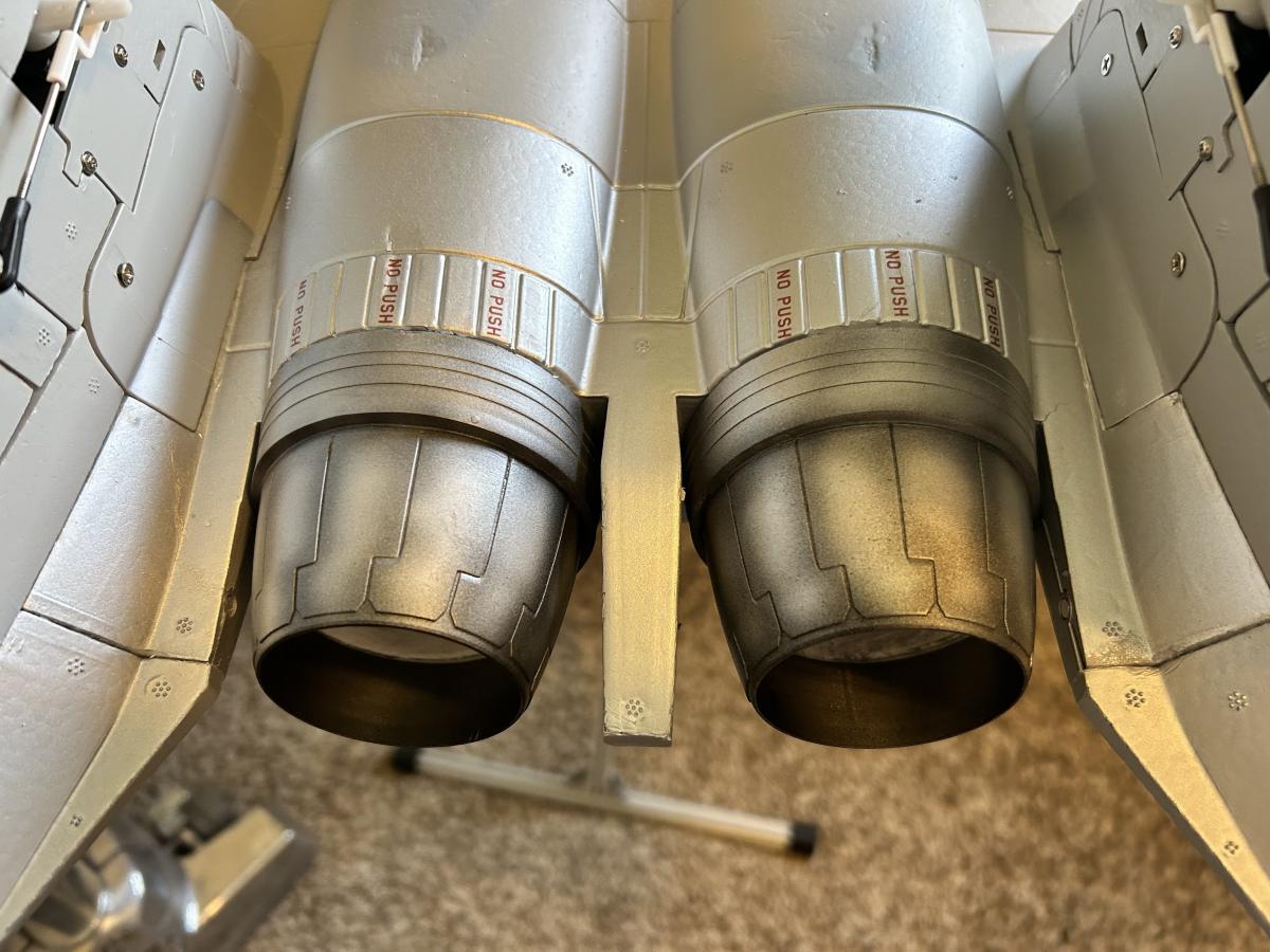

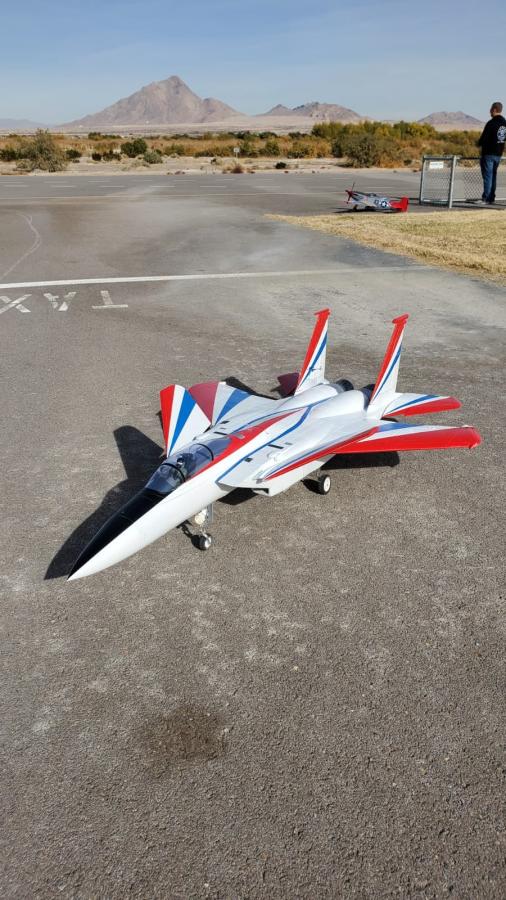

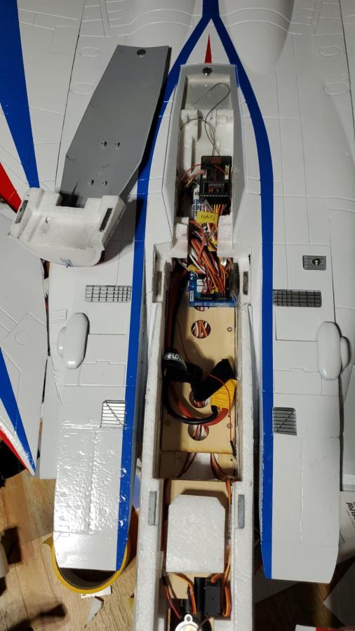

                    Yep I love my F-15 now. As DCORSAIR said, I changed out to the new 1960 12 bld unit. That helped get it to the close to the 100 mph range the real magic came from modifying the exhaust duct. There are 3D print files for inserts out in the forums if you look but I when a different route.
                    I got a set of F-18 nozzles and bashed them together with the F-15 nozzles. End result is my F-15 is now a F-15EX and holds its own to the likes of the F-5 and Vulcan now.

                        ‚Lazy man‘ inserts
                        https://cults3d.com/en/3d-model/home...-nozzle-insert

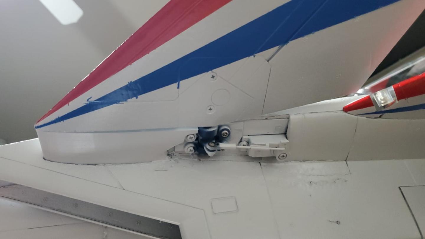

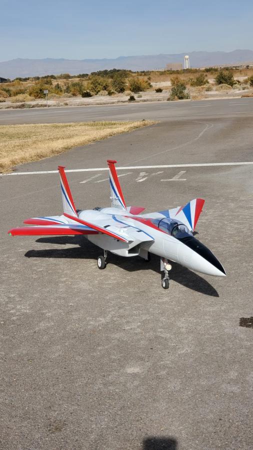

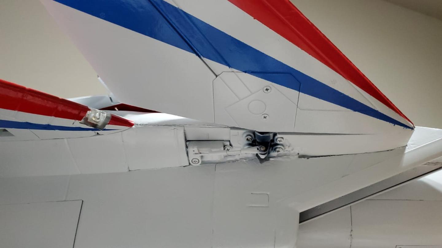

                              Hi there! I present you my project of my favourite F-15 ever made... the F-15 ACTIVE 😎
                              As the big scale one, it uses F-18 elevators as canards; taken from the Freewing F-18 90mm. The servo mechanism is so well done that is very small size making it a perfect fit for the very little room the F-15 has in front of the wing.
                              Made a 3d printed piece with the 20 deg angle, carved all the necessary foam to make it fit. Also, notice the 2 extra 3d pieces that actually holds the mechanism from the top (even though it's epoxyd in).🤩
                              The interesting thing was the performance in the air. If you see videos of how the canards work on this plane it will blow your mind! Clearly they're controlled by a computerized system as it doesn't make any sense it's behaviour.😲
                              Back to the project. No idea about the CG is gonna be or Canards neutral position, the first flight was trully a mystery but I gave it a try for the sake of humanity. Upon rotation, the plane did a Cobra, canard authority was enough to bring it to level, but it was impossible to fly and pancaked off the runway (unfortunately not caught in camera). That was my best save ever! I saw it completely destroyed...😬😬😬
                              With the extra 160gr weight of the canards system in front of the CG, in order to achieve stock CG I've elimitated the airbrake (I rarely used it anyway) to move the battery all the way back, and removed the nose weight. ALL WRONG! CG on canards planes should be way forward, almost behind the canards.
                              So, 2nd flight, battery all the way forward + canards in negative attitude (as the real one!). Managed to do 2 successful flights, but still CG had to be moved more forward.😃
                              As the real thing canards behaviour was impossible to achieve, I decided to go for a standard canard system. Moved all the electronic back to where the airbrake was, and batteries all the way forward (did I mention I'm running on 7S?), so the canards can be almost leveled to the wing (also restored the 20gr on the nose and added an extra 100gr above the gear well). WHAT A BEAUTY FLYER!!! And the looks is badass! 😈😈
                              CG ended 35mm ahead of the stock wing marking (still I feel it need a little more forward).
                              With the paint scheme done and only decals to be done, here's a successful flight (working on getting better focus) and some pics. Enjoy!

                                dariobrit , WOW, what a project and what a unique subject. Bravo Zulu, Sir. And welcome to Hobby Squawk! Great to have more innovators onboard. Best, LB

                                  dariobrit Ambitious project! Nice work!

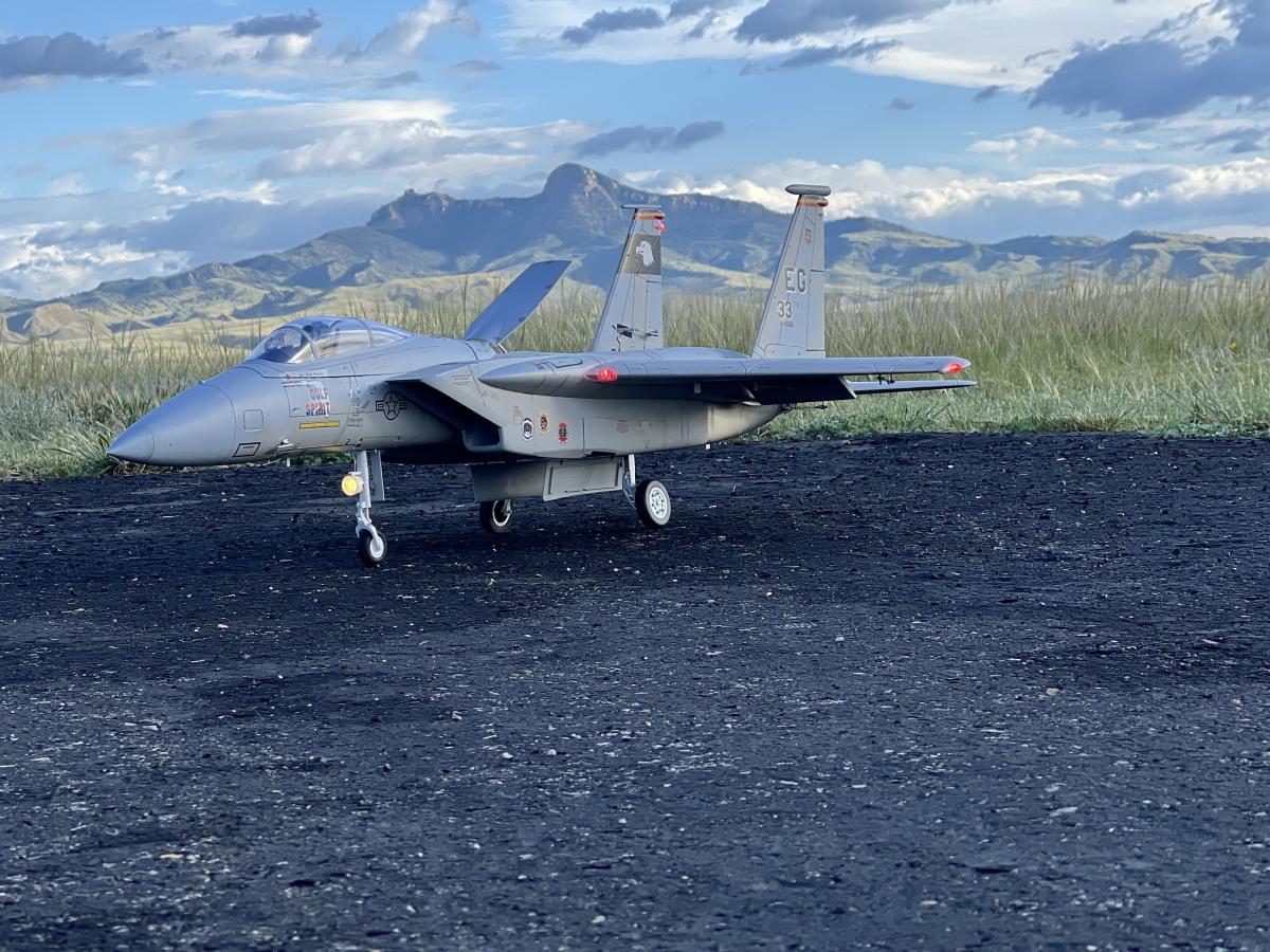

                                          I took my F-15C Eagle out for its second test flight early this morning. Nice time to fly, cool, and light winds. I recently purchased a SMC 6S 5000 MaH battery that Hugh Wiedman had suggested I give a try, since my last flight with the Eagle was pretty doggy. I always fly my T-33 first as a weathership before taking up a more valuable plane like my F-18, F-4, F-15, or B-2 Spirit. I brought the new SMC battery with me, but didn't feel comfortable making its first flight in my new F-15, so I put it into the T-Bird to see how it went.
                                          My thoughts were that performance improved with the SMC battery in the T Bird. I don't have empirical evidence to back that up, but it did seem to fly with more authority and at a lower power setting. It is also a bit smaller size than the comparable MRC Admiral batteries, so that was a good test of the battery before I put it in one of my other jets.
                                          I used a pretty new Admiral 6S 5000 MaH battery for my second flight of the F-15. I have installed a new 12 blade fan and the stock inrunner motor that is currently sold with F-15 kits. I do have a little extra weight with the JP Brakes and wheels and a simulated afterburner in the tail.
                                          Takeoff was normal when I started near the approach end of the runway for a full run at our approximately 500 foot long runway. Still, it took up much of the runway to take off. The whole flight was better than the first with the outrunner motor and 9-blade fan I had on the first flight, but still, I'd have to say "pretty doggy." (My field elevation is 5,000 feet MSL.)
                                          I got one surprise on my first attempt at landing when I saw that one of the main gear had not deployed. I went around, recycled the gear, and the second time I got a nice landing in a pretty high-alpha attitude like the real planes. Brakes worked great and I'm glad I have them.
                                          Next flight I will use the new SMC battery to see if that helps its "dogginess" a bit. It's still a fun plane to fly, but even my T-33 totally outclasses it in performance at this time.
                                          I'll attach a pic after today's flight.
