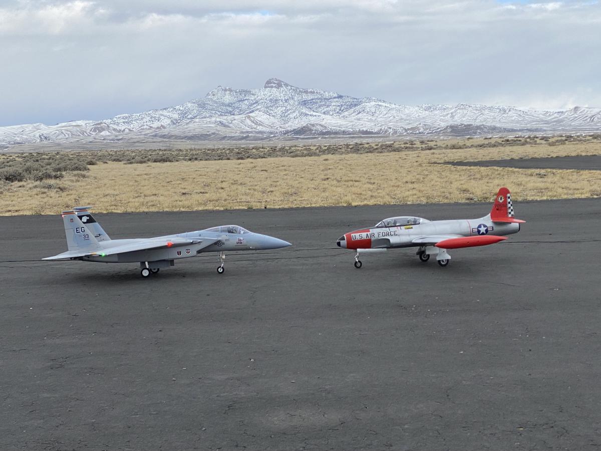

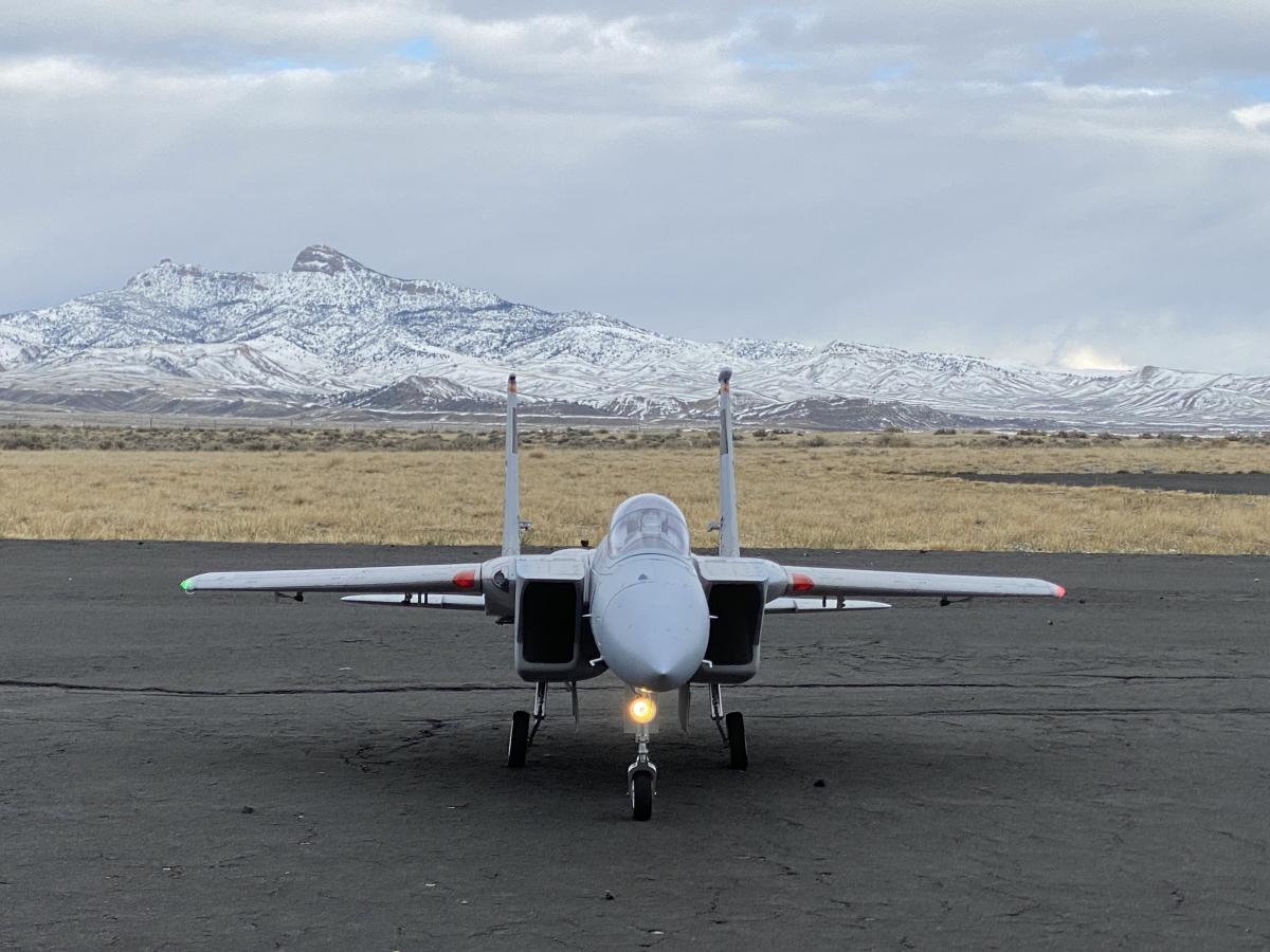

                            Hi All: I successfully maidened my F-15C this morning. Temp was about 30 degrees, spitting snow, but I wanted to get this first flight out of the way. Plus, this was an auspicious day to do it: the 74th anniversary of Chuck Yeager's record speed setting flight in his Bell X-1 that "broke" the sound barrier. Before he totally retired from flying, he did fly an F-15 for awhile with the name "Glamorous Glennis" on it, as had been on his X-1. So, I had that going for me for a little extra luck!
                            Regarding the flight, it went ok, took a lot of the 600 foot runway to take off at 5,000' MSL, and I flew it for 3 minutes, trying to make trim changes, where necessary in various configurations. This will take several flights to finish. It is strictly a stock setup, had a Spektrum 5000 30C battery in it, CG just slightly aft of the manual recommendation.
                            My only concern, and it was a distracting one, was that the plane exhibited a noticeable wing rocking in almost all configurations with the gear up. Didn't notice it that much in landing Click image for larger version  Name:	IMG-0668.jpgadjsuted.jpg Views:	0 Size:	144.7 KB ID:	327238Click image for larger version  Name:	IMG-0672.jpg Views:	0 Size:	130.2 KB ID:	327239Click image for larger version  Name:	IMG-0669.jpg Views:	0 Size:	127.8 KB ID:	327240 configuration and it went into a nice High Alpha attitude for landing. So, nothing damaged, but am concerned about the wing rocking. Might need a gyro.
                            Does anyone else have this issue with their Freewing 90mm F-15C? If you have any recommendations about a gyro to buy and install, that would be very appreciated. Took a few pics after the maiden. Flew my T-Bird first as the "weather ship" and "warm up ship" for the Eagle.

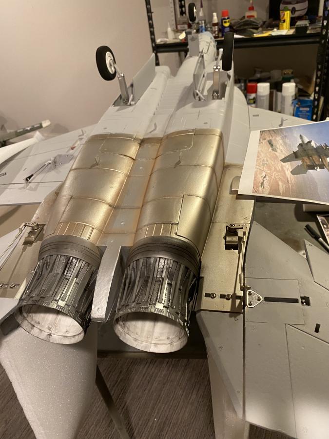

ID:	327321 I tried a stab at detailing staining of the inner afterburner rings on the F-15C. For this attempt, I used a dark grey pigment powder, a small stiff brush, and a q-tip. I'll revisit it later as I see fit to improve it, but I like it better than just a pure white color. Also, I have ordered a bottle of Alclad II Pale Burnt Metal which gives a slightly gold color to some of the panels underneath the F-15. That, along with some grease and dirt streaking, should improve the look underneath, I hope. I'll attach a couple pics of my still in-progress afterburner exhaust detail and a real F-15, that shows that discolored gold tinted metal underneath the fuse.

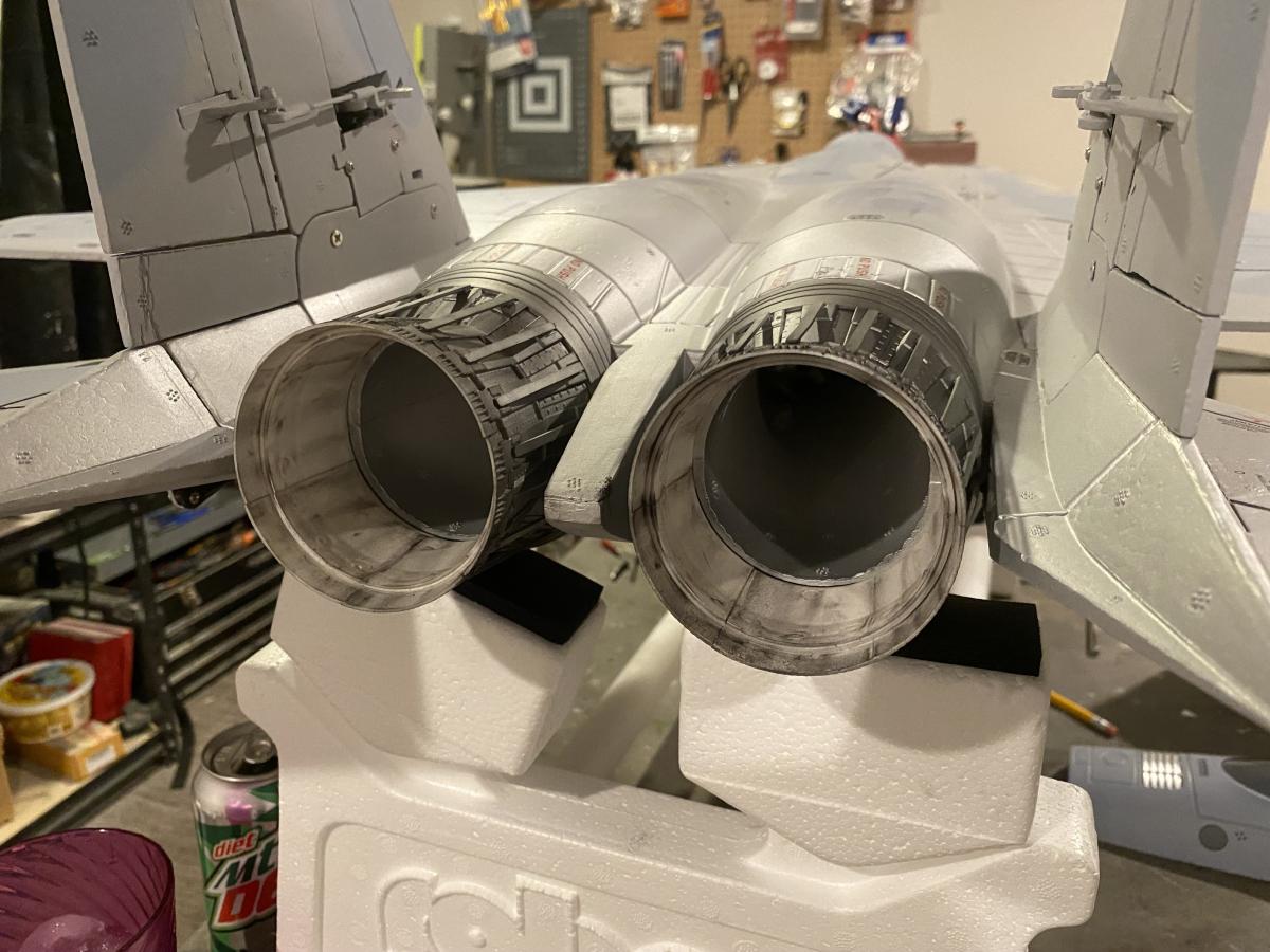

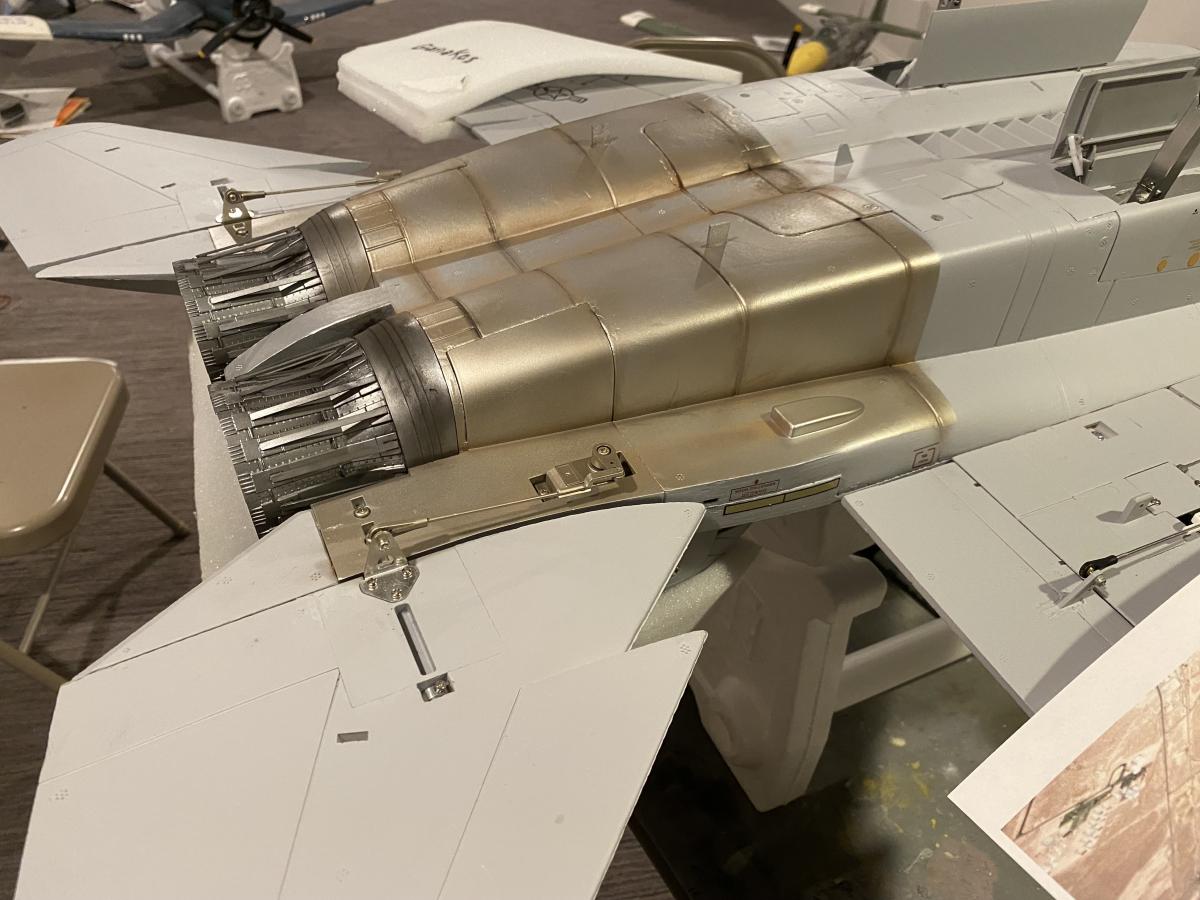

                                Wind was a bit stronger than I wanted to tackle for my second flight on the F-15C Eagle. So, I did some detailing of the hot end underneath of the fuselage. Painted over with an airbrush lightly over the silver with Pale Burnt Metal paint, and then added some browns and blacks dry paint pigments with a brush. Used as a model a photo I found online of a real one. Still more work to do. Click image for larger version
