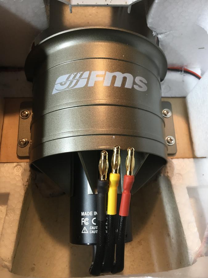

Name:	FMS EDF 1-12-21.JPG
              First step to the FMS 8S up-grade to the Eagle. There is some shaving of the foam to get this beast to fit. Found the best way to do it was using a solder iron to remove the excess foam needed for this EDF to fit. A good 1/8 inch needs to be removed from the cover piece and the fuse needed only small amounts removed. The ESC post needed to be cut down atleast an inch for 150amp ESC to fit under the air cheater grate. So far so good on the install and need to extend the motor leads to complete the project. Looking forward to final set-up and getting this bird in the air again....

                Upgrade completed on the F-15 to 8S with the FMS 90mm and Freewing 150amp 8S ESC.... No issues setting up ESC but question. When you hook up the 2S then the 6S will you hear 8 beeps from the ESC? Not sure if the ESC is seeing the 8S system. It throttle ups fine and seems fine , but not sure.... Thoughts?
