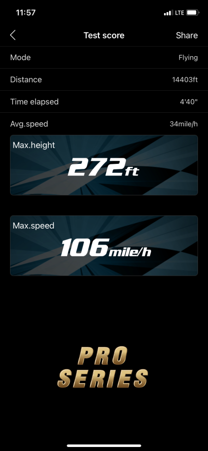

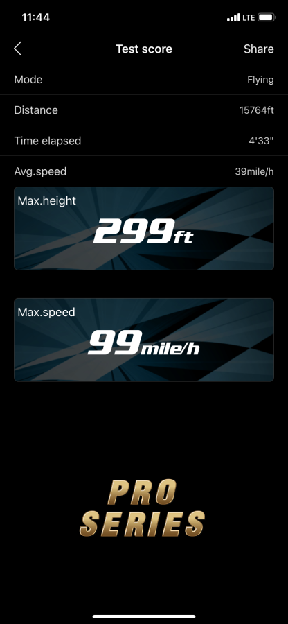

        Just got to speed test my new 90 F15 today she’s all stock exception FW twin burner, running SMC hivlt 53-4600 packs getting 3-4 min flights. She’s so forgiving to fly not as fast as my J-10 but not bad either

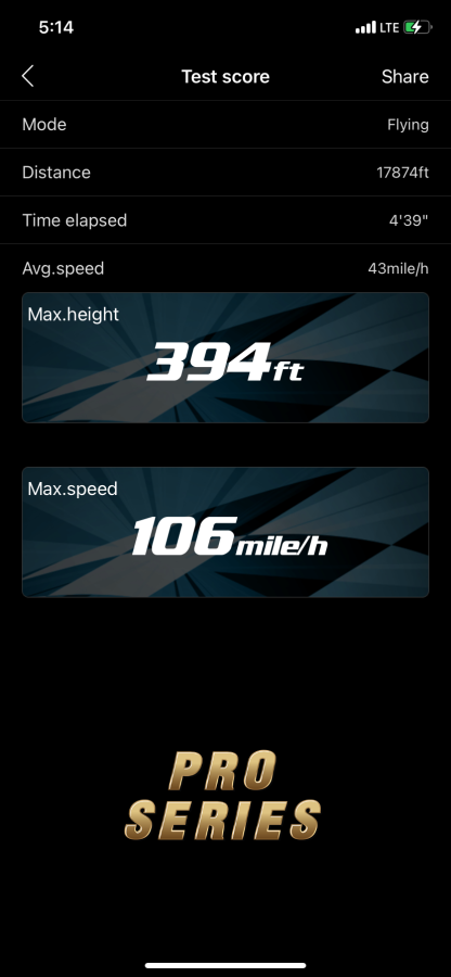

          Another successful day flying the F15 not a scratch seems like 106 is all she’s gonna get other than steep dives. Super happy with this plane even more forgiving than the J-10 on grass, gets a little hard to see up there but what a amazing sound it has

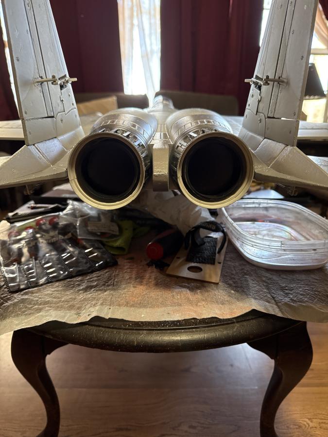

                      Just upgraded the 90 F15 to 8s I made a set of exhaust reducing nozzles which made an amazing improvement over stock 6s. Not sure if anyone else has gone 8s also and should I make another reducer set with slightly larger outlets

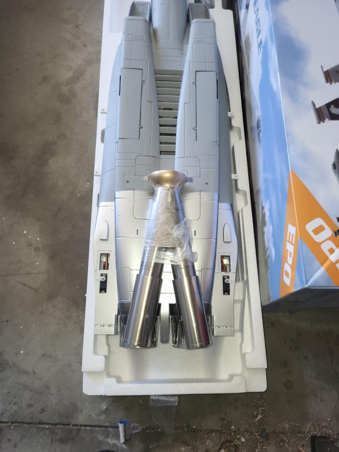

                                #855

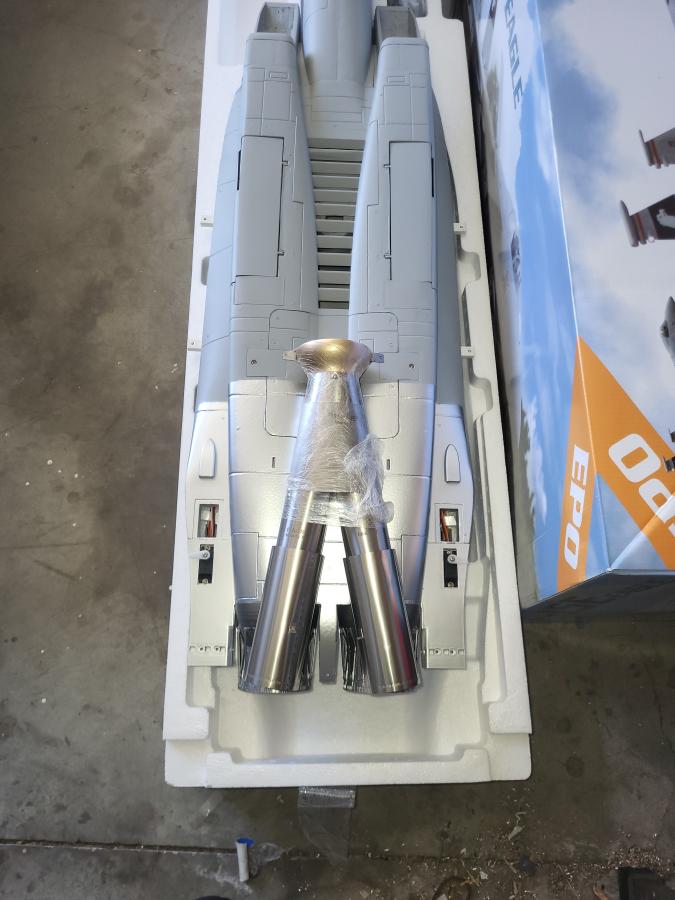

                                JL conversion pipe for the F-18 works perfectly for this!

                                  #856

                                    #857
                                    Wow that looks nice I made my own this would have been much nicer. I used a PCV pipe joiner opened up to 55mm exit worked best for me on 6s, haven’t flown her on 8s yet sure I will try some different sizes
                                      • 5401
                                      #858
                                      His is a turbine conversion
