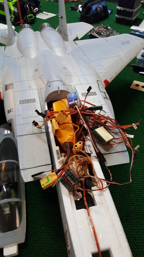

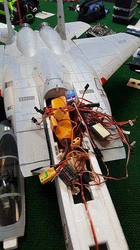

                    I have 2 admiral 40c 5000 4 cells that fit on the battery tray nicely with plenty of room to shift for cog. But first, I need to shorten the ail, elev, and rudder wires that go to the gyro, so that I don't have a lot of wire clutter in the aft section of the battery compartment. I'm anal about this with all my jets. The plane as received is a rats nest of wires. I want neat, organized cable ways.
                      #370
                      I am the same way.

                      After....
                      Ahhh. All better.

                        yeah, I just went through my stinger 90. It was a rats nest too. So I procrastinated on this one a little, but I'm on it now.

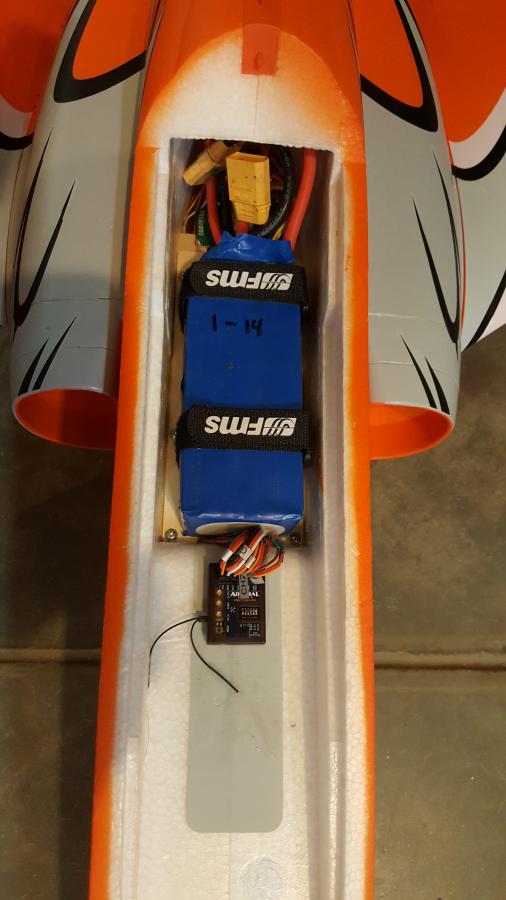

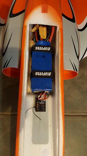

                          I just did the radio install on an FMS 90mm Super Scorpion. It has a connector board with wires coming forward off the bottom of it located aft of the battery tray. The leads on the board are only about 4-5" long so to add a receiver would mean having to locate it behind the battery. I wanted to install an Admiral 6ch stabilization receiver and needed a horizontal, easily accessible location for it. The plane also does not have a removable battery tray which I have become spoiled on thanks to Freewings recent releases so I made my own removable tray and extended the leads from the board. This also allowed the leads coming off the bottom of the connector board to naturally run forward under the tray. The end result is a super clean radio installation.

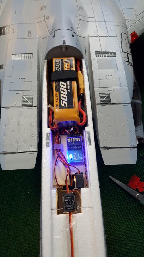

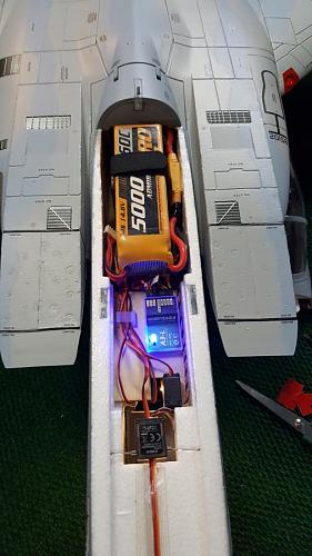

                            Finally finished the afterburn light install. Just what I need, six more wires and controller inside this thing. Time for wire organization. Here goes another week.:Whew:

                              Great install. Is this the dual 64mm? I wish I would've done this over the single 90. We'll see how it flies, but maybe I'll configure it this way if the flight characteristics are affected. I imagine this will be far more esthetic. Might I suggest the aluminum tape trick to allow for greater effect through reflection?

                                Yes, which size rings did you order Phatbob ? BTW, great job !

                                  Yes, the 64mm. I added ply hard points to make my nozzles removable. I will line the nozzles with chrome bare-metal. I did it with two of my f-16's.

                                      Finally got my wires organized. It took me my entire Saturday. I have the AB controller and BEC mounted under the airbrake. I'll install the cover under the brake tomorrow. Now to program my radio and balance her, then wait for spring.
