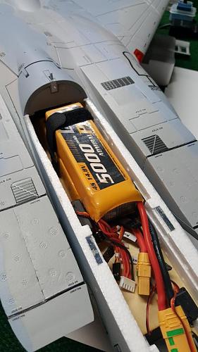

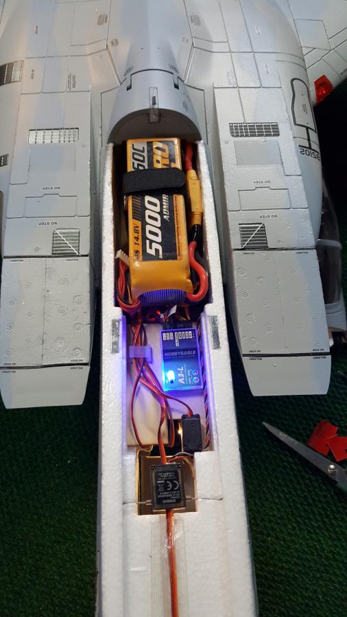

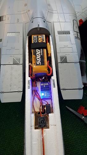

    After further inspection, two Admiral 4S 5000 Pro's will fit with a minor modification to the battery strap position. Just not sure yet about how it will balance. I don't know if the plane tends to be nose or tail heavy. Tomorrow I plan to fly the retirement flight on my Stinger 90 so I can start swapping everything over.

      It tends to be nose heavy with 8s 5000 on board. Did you remove the weight from the nose cone? If not, do.
      I still have the light and gear sequencer in place on mine and the front of my packs are a little behind them. The rear of them are under the turtle deck. I also have my CC BEC Pro mounted in the intake just ahead of the ESC on the starboard side..
      Oh, and Happy New Year since I'll most likely be asleep when it rolls around. ;)
        #323
        Bill, thank you so much for the information. Weight has been removed. Happy New Year to you as well.

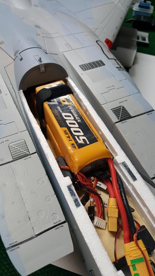

              I had both, sold the stock version and went with the high performance version, maybe a little less flight time, I had my timer set for 3 minutes on the stock version and I have my timer set for 2:45 on this HP version. So was it worth the $50, oh yes, pay the extra $50 and get the HP version. Take off is where I noticed it right away, shorter take off distance and I can climb out at a good AOA, top speed isn't that much more but it just flies better, I don't see no need to go 8S on this one, unless you have a stock one, I can see why people upgrade it, it is a little slow, but if your a rookie pilot then the stock one is fine, I use Gensace 5000 60c and 45c, having to use only one battery is nice too.

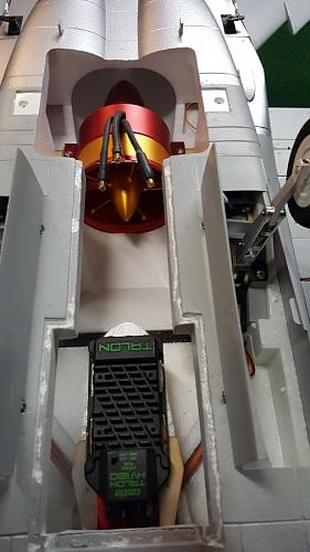

                I just ordered the 150a HV esc from Motion. I had a hard time finding it. They should list it in the upgrade page. Instead, I found it in the spare part listing for the 8s Yak 130. The 4075 1250Kv fan combo is currently out of stock, but found a new one on ebay for 15.00 more out of Hong Kong. So now I have everything to run this aircraft on 8s. Can't wait to get my feet wet with this baby !

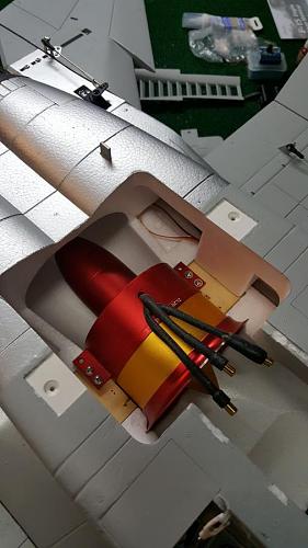

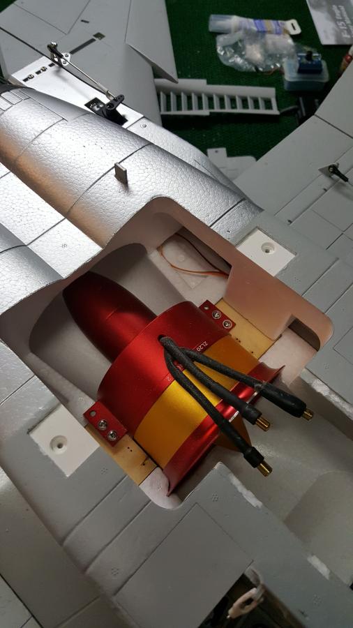

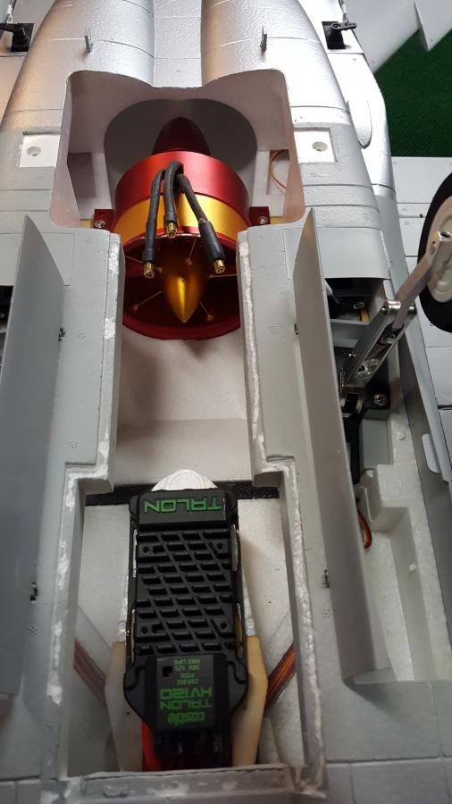

                  JP 90 8S fan going in mine. I had to pull out the shoe horn for this one but it's in there.

                    Nice ! is that what you were running in your stinger 90 ?
                      #330
                      Yes. I flew one last decommissioning flight on it today at the club's annual New Year's Day fun-fly. Froze my keester off but had a good time. As soon as I got home I started removing the electronics. It has performed flawlessly in the Stinger and should do well in the F-15

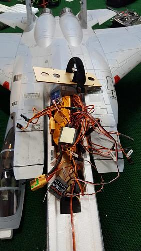

                                      Originally posted by scootergenie
                                      Mine is supposed to arrive tomorrow, But will be waiting for the power system coming from Hong Kong. Hope I'm ready for this thing. My only experience with 90mm is my stinger 90, but its a great flyer.

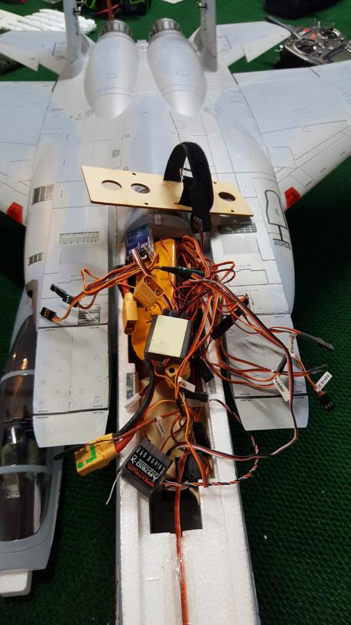

                                      You'll probably be fine. I changed to a different true 7 channel receiver and it all works now. Set my throws & gyro, balances perfectly with two Admiral 4S 5000's. Just gotta finish card stocking the pilots chair and it will be ready to maiden when it warms up. The rats nest that was.....
                                      Click image for larger version  Name:	20180103_170953.jpg Views:	1 Size:	71.6 KB ID:	111624
                                      now looks like this...
                                      Click image for larger version  Name:	20180104_180842.jpg Views:	1 Size:	64.3 KB ID:	111625

                                        Nice Job cleaning up the rat's nest...looks clean now. I see your satellite and gyro, but where did you hide your receiver ?
                                          #340
                                          It is mounted vertically on the back side of the ledge. The wires to the gyro kinda cover it. I finished card-stocking the cockpit and pilots chair so she is all done and ready for the weather to warm up. Now I have two new jets to maiden.
