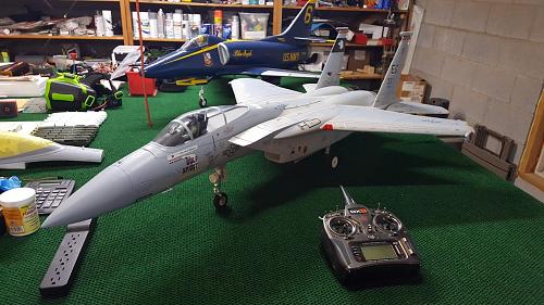

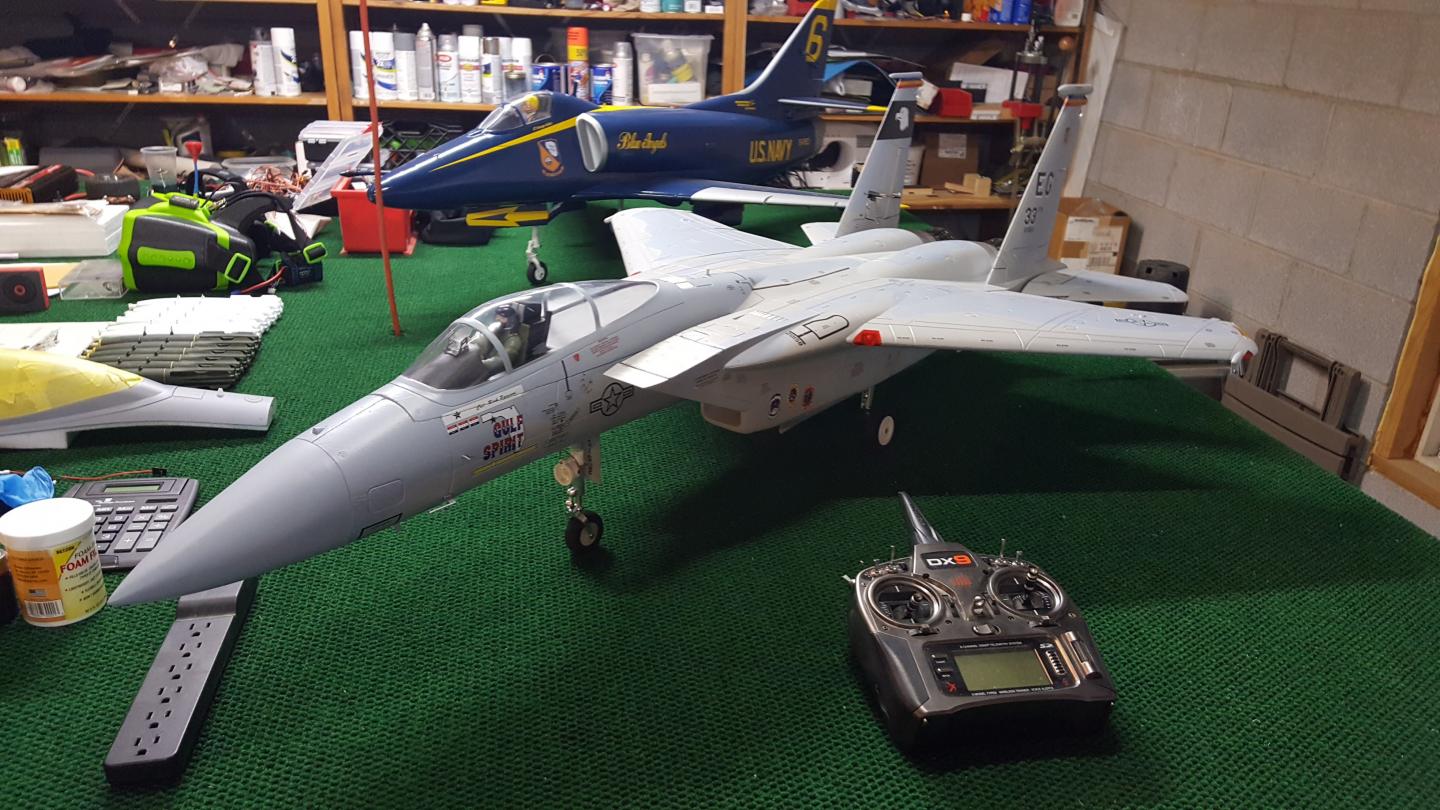

    It is mounted vertically on the back side of the ledge. The wires to the gyro kinda cover it. I finished card-stocking the cockpit and pilots chair so she is all done and ready for the weather to warm up. Now I have two new jets to maiden.
    Click image for larger version Name:	20180104_223514.jpg Views:	1 Size:	188.7 KB ID:	111666
    That's ok. This cold weather will give me time to pet them and love on 'em a bit. LOL Bill, thanks again for the tip about the weight in the nose cone. It balances perfectly as is with the weight removed and two Admiral 4S 5000 Pro's. It would have been big time nose heavy and I hate adding dead weight to planes.
