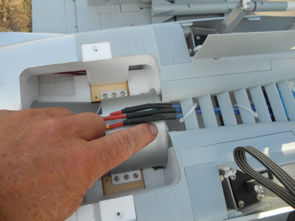

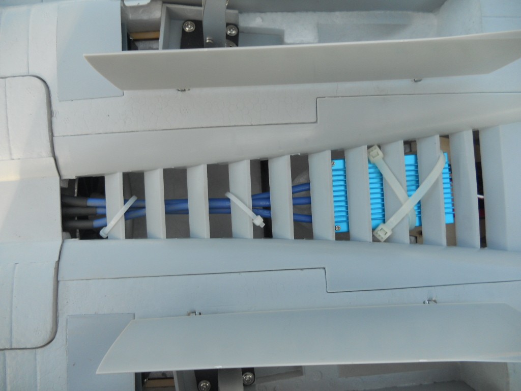

                        I bought the high performance version with the 1680kv and mine came with a chunk of lead in the nose cone from the factory, I think the ARF plus kit does not come with this lead weight. I did leave it in and mine balanced out just a little tail heavy still so I moved my fan/motor forward, used two of the stock mounting holes and drilled out two holes for the front mounting screws, I did that for two reasons, it moves the CG more forward and it also helped the wires to be more relaxed on the ESC, I did grind some of the fan shroud too, it was pinching the wires right where they go under the cheater hole cover. Hope this helps and I don't have the weight of the lead I used, sorry, I glued the nose cone on solid because some people were losing it on a rough landing, I haven't had to remove it yet. This jet is forgiving on the CG too, you can be a little back on the CG and it flies fine. I know I'm not much help but thought the pictures might help you understand what I did to mine, you can also see that my fan cover doesn't sit down flush anymore because I moved the fan foward out of the foam ring, it's no big deal, got plenty flights with no issues, keep your timer to no more than 2:30, it loves to eat batteries with this setup but it's way faster over the stock F-15.
                        I can get you my CG range if you need it?? I use Gensace/Tattu 6S 5000 60C to power mine.
