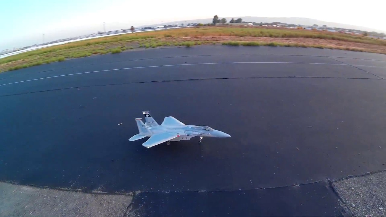

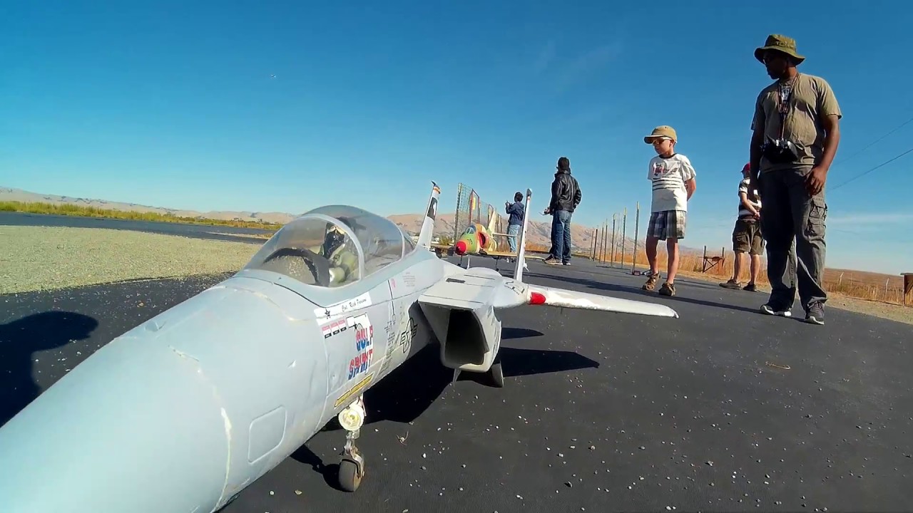

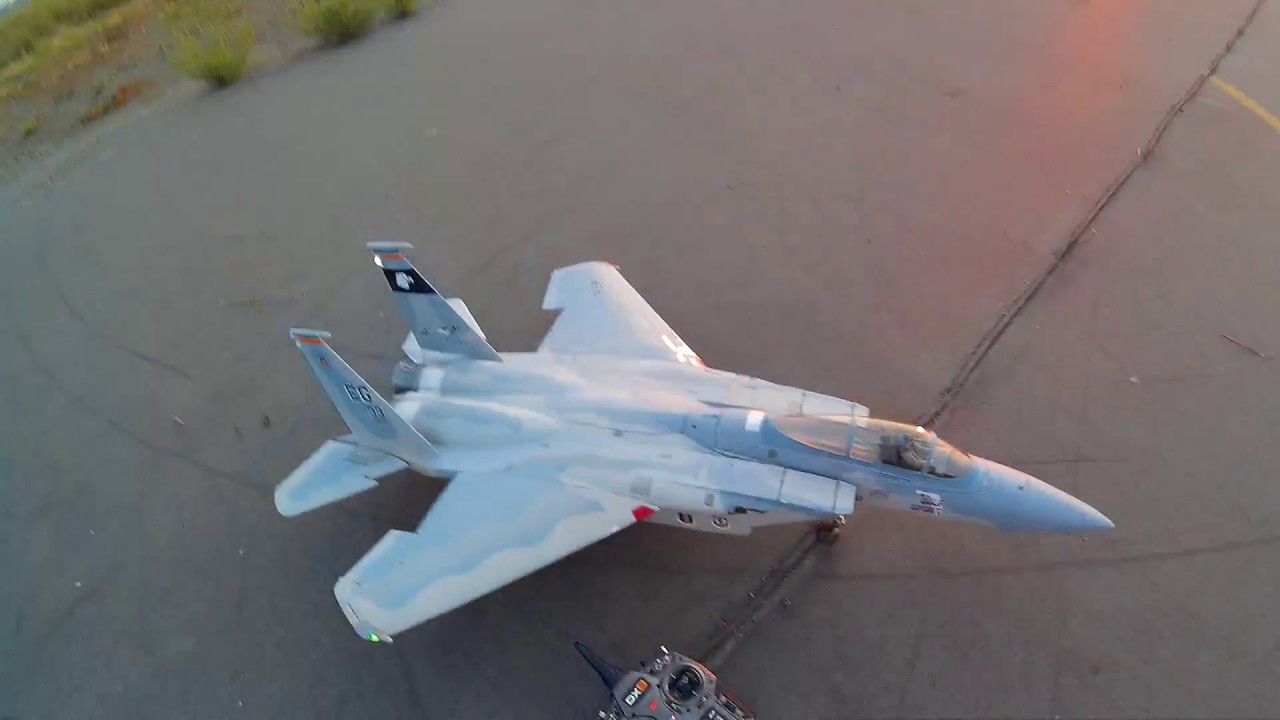

              more f-15 flights over the last couple weeks. Here are a couple vids....
