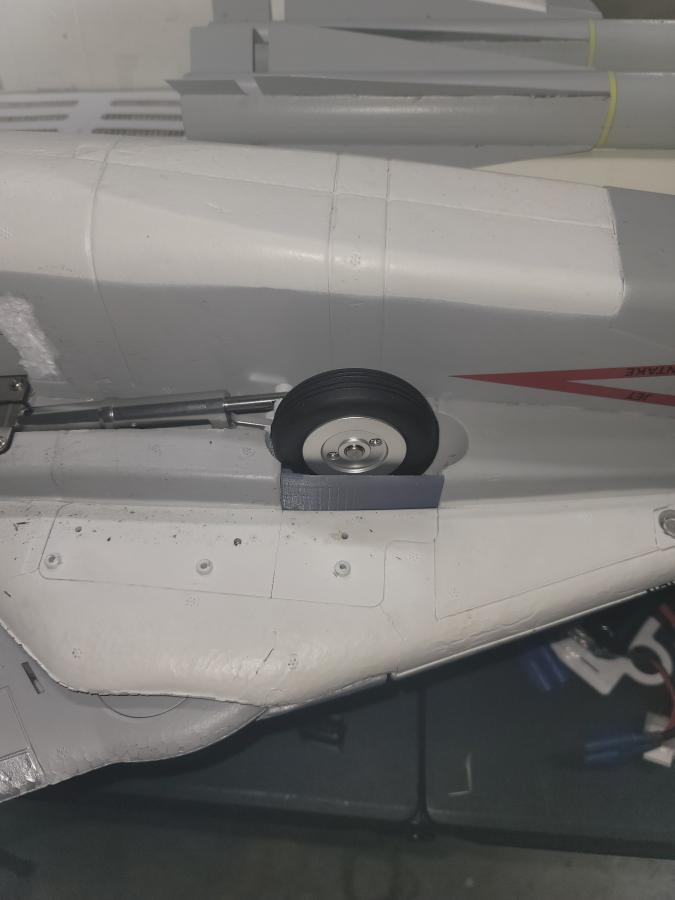

                    • I don't know if anyone has tried this, but here is my idea for adding support to the mains. I printed a strut clip by ShadowVFX (https://www.thingiverse.com/thing:3926466), the brace from kallend (https://www.thingiverse.com/thing:3326062), and used the stock "slider" tray for the nose wheel. The dry run appears to be ok, with enough clearance on the brace and servo to somewhat insert it into the foam. It may not look the best, but I think I can make it functional.

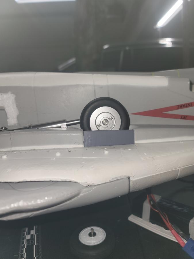

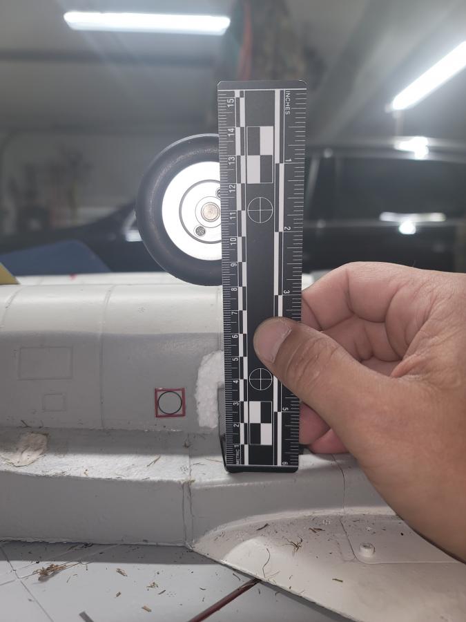

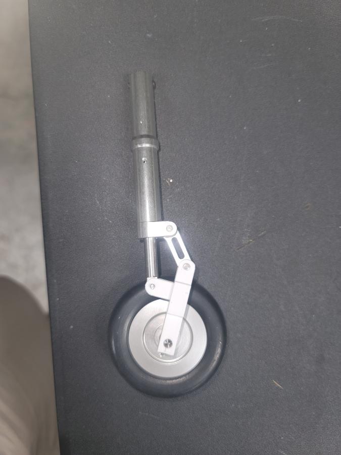

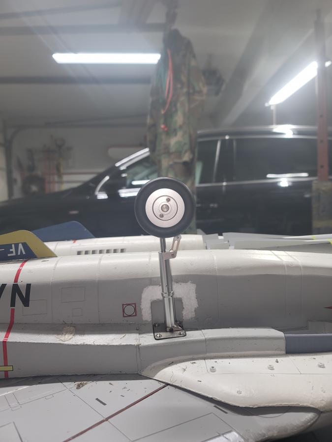

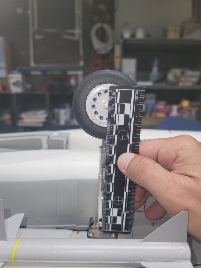

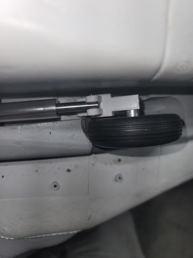

                        My first attempt at 3D design for the A-10 trailing link nose strut to use on the F-14 to add trailing link mains. The 3D printed test file fit nicely. I added 5mm to the overall length compared to the pictures in order for the wheel to align more with the wheel well. Only minor amounts of foam to trim out. Now I need to source a machinist and get a quote to have it made in aluminum.
                        First attempt at creating a modification to add trailing link main gears to the Freewing F-14. This was generated as a test fit prior to machining. It replaces the lower "fork" in the A-10 trailing link nose gear.

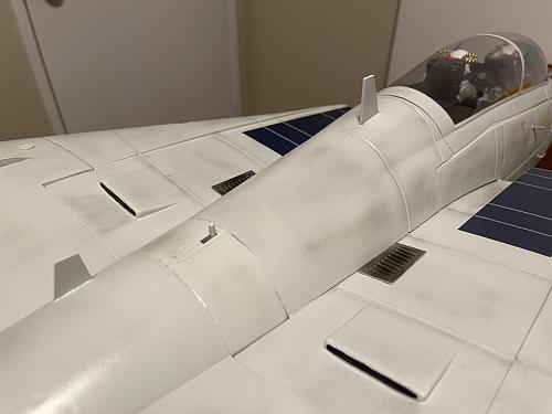

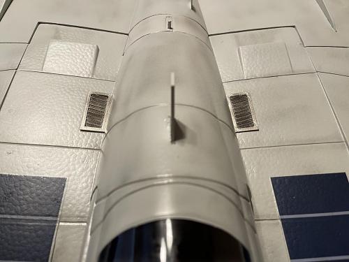

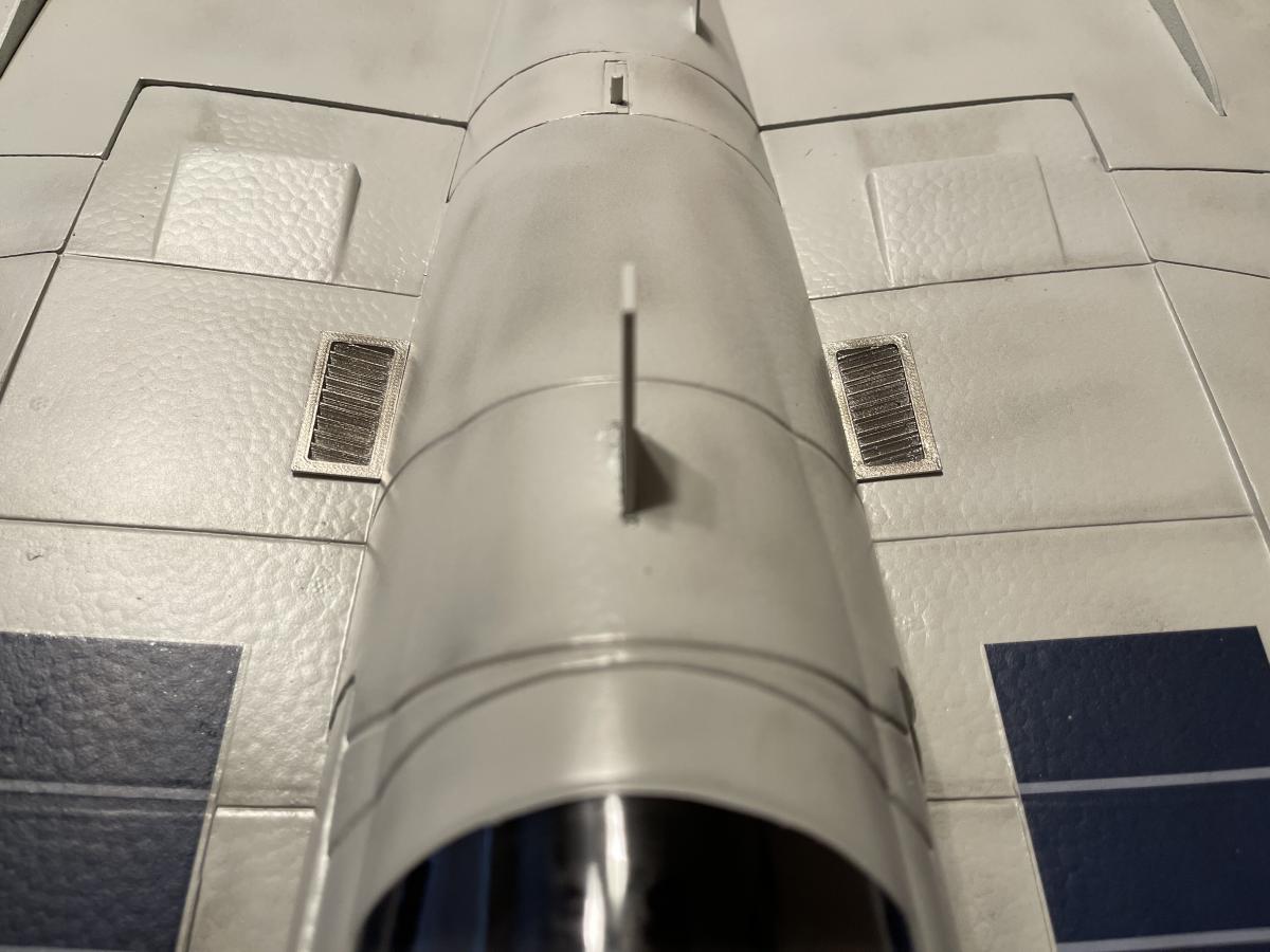

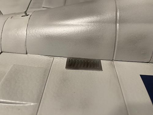

                        • I have wanted to add Heat Exchanger Duct Vents to the Freewing F-14 for a while now since I really enjoy the way they look on the full-scale version, so I designed and 3D printed some. These were painted in Aluminum and then shaded with sone thinned Black paint, and secured with a small amount of CA glue.

                          • Originally posted by T-CAT View Post
                            I have wanted to add Heat Exchanger Duct Vents to the Freewing F-14 for a while...
                            TC, Now we're talkin'...nice touch, Sir. Best, LB
                            "You just need the will to do what the other guy wouldn't."
                            ~Keyser Soze~
                              Thanks a ton, Elbee! These have been on my mind for a long time, so it was nice to get the project done. After some carving of foam about 3.5mm deep, I used a little CA to glue them in and they were done.
                              • Nice touch T-CAT ! I love subtle yet powerful scale adds like that!
                                • Originally posted by Aros View Post
                                  Thanks Aros! I love small, easy, cheap, lightweight, and visually appealing scale modifications.
