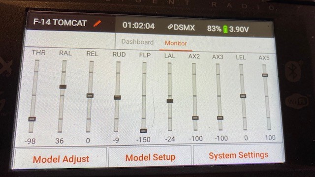

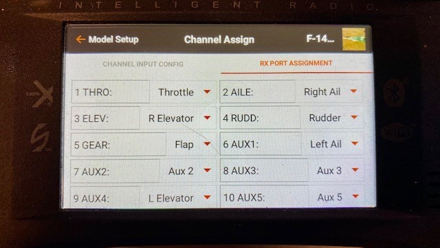

    • When I do to aileron and dual elevators I have my dear channel back on 5 when I add ailerons with lapse that's when I lose my channel 5 for gear and it doesn't give me the option to assign it back to gear thanks for all your help guys and girls
      • I hate talking on a microphone When I do Dual aileron Dual elevators I have my gear on channel 5 when I do Dual Aileron with flaps And dual Elevators I lose my dear channel when I go to assign the channel the gear is that in the selection

                          • Originally posted by davjamhan View Post
                            At that point the gear channel on your RX becomes the input for the flaps. You will have to use AUX 2 on both the TX and RX for the gear input.
                            I attached pics of my Spektrum setup using an AR9350, so only 9 channels. You will be able to see a working configuration. Sometimes if all else fails, start from scratch with a new model on your TX and RX. My channel 10 is programmed for Gyro gain. Aux 2 & channel 7 is Landing Gear, and Aux 3 & Channel 8 is Wing Sweep. Using spektrum receivers with built in gyros (AS3X), you do not need a physical channel open for gyro gain or mode selection.
                            I don't know about other RX's with built in gyros, but using the separate HobbyEagle A3S3, I needed 2 channels open just to use all of the capabilities of the gyro.
