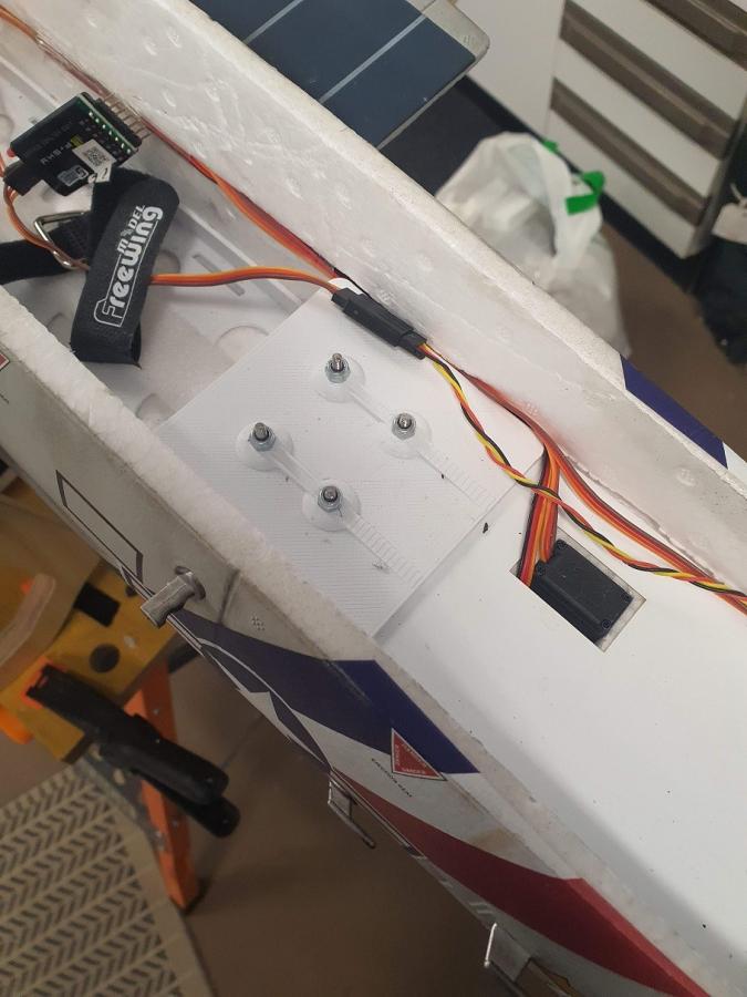

  • The nose gear mounting plate looks similar to where i landed with it a few weeks back, but based on a captured hex nut rather than allthread + locknuts. The idea itself was adapted from Bmcormack who used a piece of plywood to achieve the same, but im not much for woodwork lol.
    (Can also see the front of the full length tray in this shot, which adds some additional strength to the glue seam for the forward section of the fuse once glued in place)

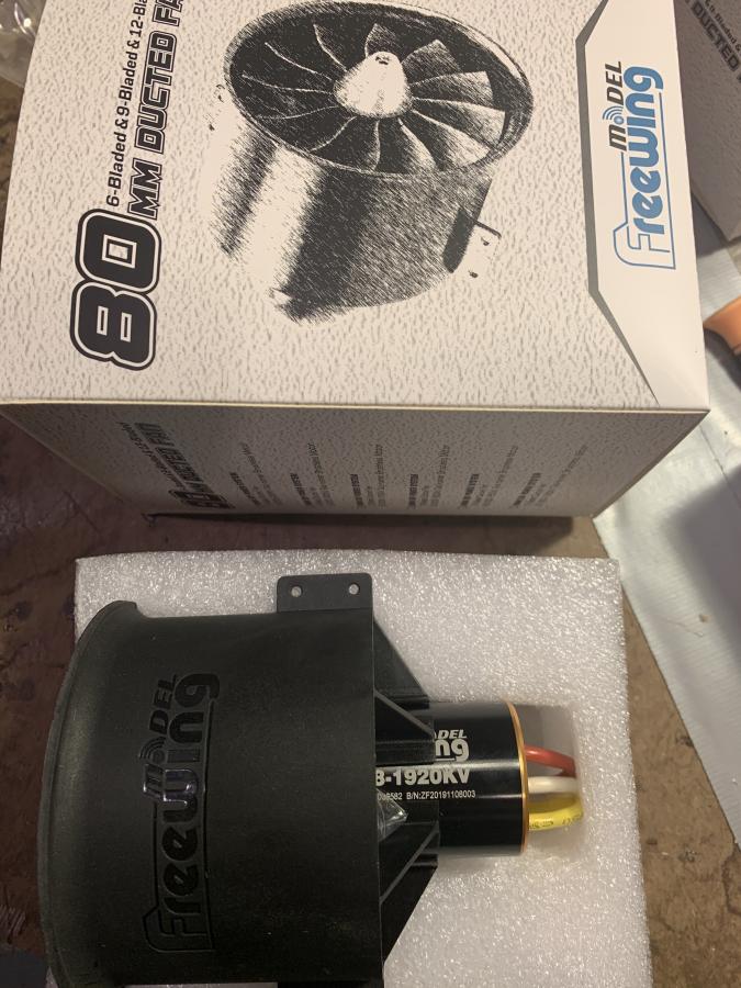

      • Both the F-14 and a pair of fans arrived today.

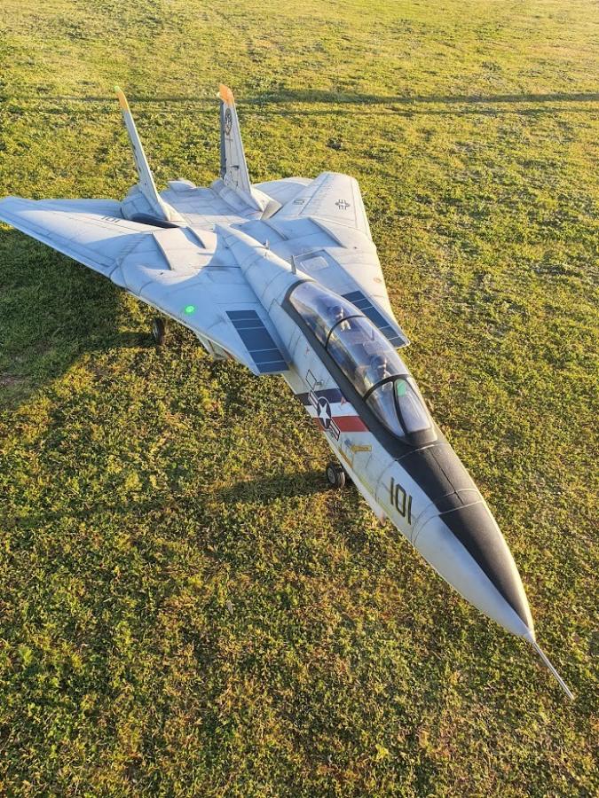

                      • Finally, after 4 years of talking about it, and crashing the first one before I could do it, it's finally done!
                        Maiden report of my Freewing F-14 repainted in VF-1 Wolfpack colors circa 1975. This is actually my second Freewing F-14, so I already knew how she handled. The only major difference between my first one and this one is I put a pair of the T-33 fans/inrunners in it after removing the stock system, and added Chris Wolfe's (Thercgeek.com) twin burners for 36mm inrunners.
                        On the first flight my landing gear somehow got reversed in the radio even after I had tested it out on the ground the night before, so the first flight was with gear down the whole time. Was a little worried about it so I landed early without getting it properly trimmed. It also made me rush the landing and it bounced and scraped a wingtip up a little. No other damage though.
                        The second flight from which these pics came (thanks greenseaships!) I went up with wyldkrd flying his E-Flite F-4 and we did a little dogfighting. The gear went up properly and I managed to swing the wings for one pass. I was about to make another low pass for the camera with the wings back when my timer went off, so I threw the wings out and rushed the landing again. Only a small bounce that time.
                        Next time I fly I'll put the ordnance and tanks on. The inrunners work really well on this bird. She gets off the ground much faster than the old stock power system, and definitely has more thrust and speed. I also added a few scale details that I 3D printed, namely some A-model nozzles and nose gear plate (thanks ChrisK!), pitot tube, NACA ducts for the ESCs and a fuel dump vent. I replaced the cheese grater venting on the belly with some thin styrene and added the NACA ducts for cooling.
                        Here's a bunch of pics, I should have some vid of the maiden later.

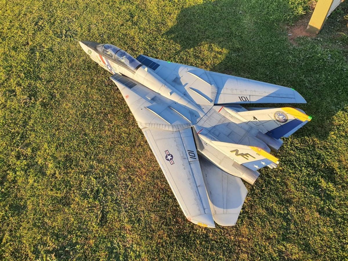

                                    Finally got a chance to fly this bird during the week. Wednesday afternoon out for a maiden + two, then back to the field all day Friday to really try and get a handle on it.
                                    For the reputation is carries it's a fairly docile jet - certainly with the wings extended anyway. Wings swept is interesting, takes a lot of elevator to hold is nose up in turns but my goodness it's a sight to behold. The transition from low to high rates is also an interesting challenge to work with as the wings sweep back. Gyro performed beautifully and the functional air speed sensor mounted on the nose cone is neat - cruises around at ~120km/hr IAS.
                                    Took a little to get the flap/elevator mix settled, had way too much dialled in to begin with which saw her floating in at too low a sink rate. Im still carrying too much speed in on final now but getting slower with each approach - I'd rather come in a little hot than go the other way lol.
                                    All in all it's a fantastic jet to fly and has become an instant favourite. A little video from the day, the scene was to beautiful to not try and capture it.
