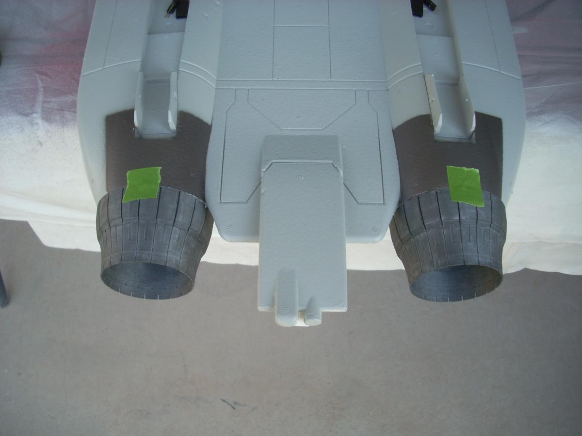

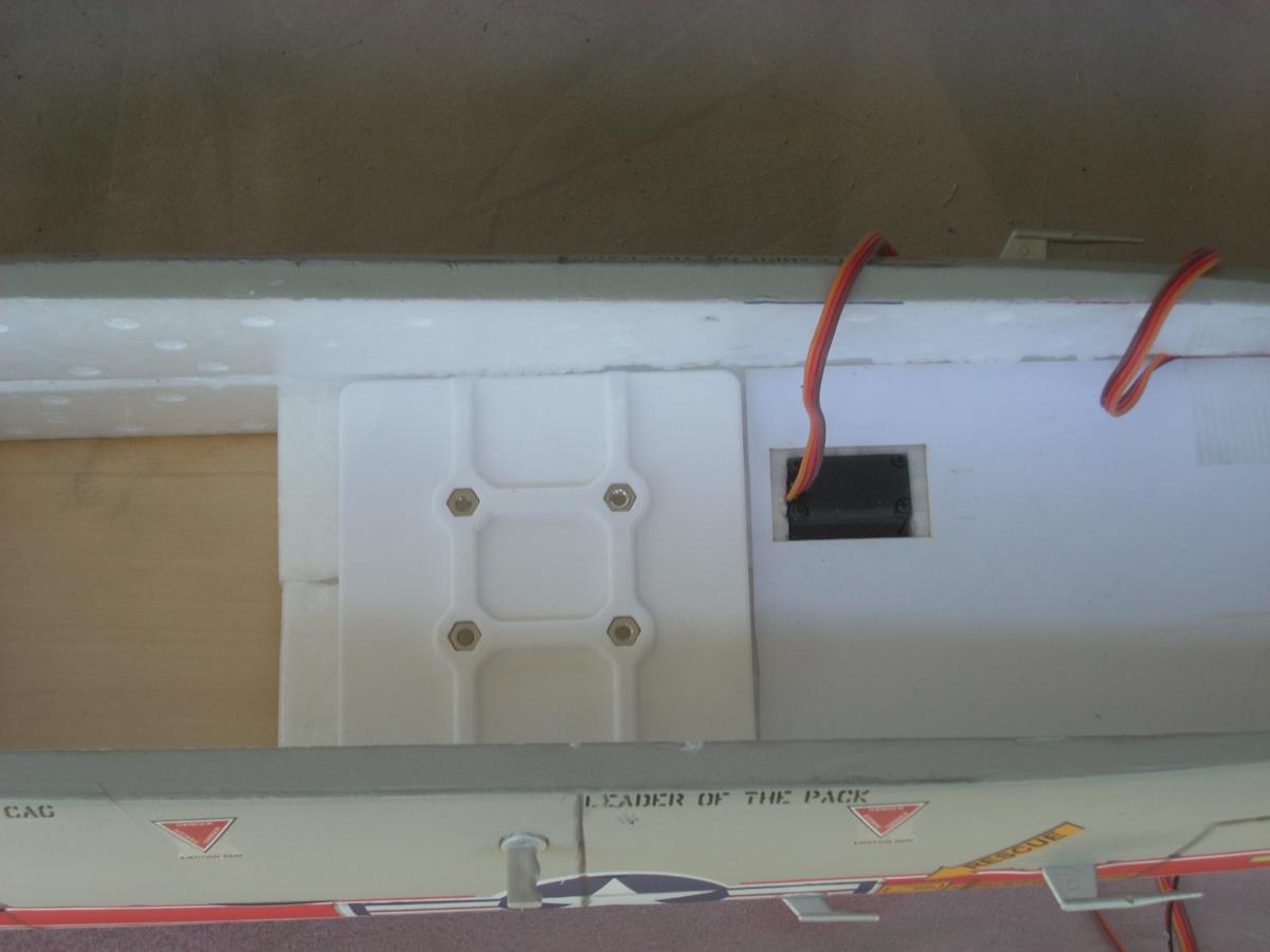

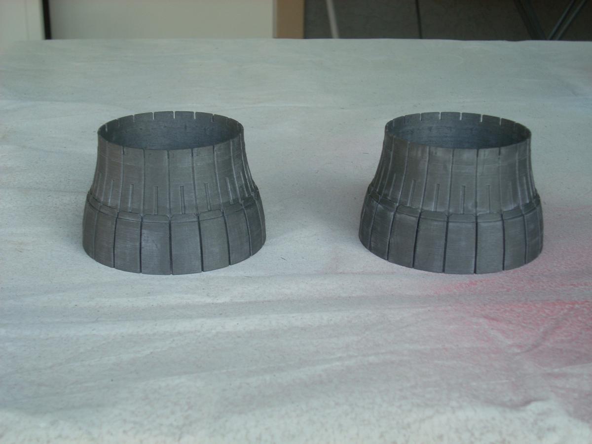

                                      Still working on the repaint of my second F-14, and she just got a nozzle change from the stock D version to the older A version.

                                        Nozzles look great, Pat! Did you design those?
                                          #980
                                          Alpha, no they were designed by Chris K. He just posted them on thingiverse a few days ago, along with a nose gear reinforcement plate. The plate is a neat design that has the mounting screws go into the electronics bay under the canopy. The stock nose mount piece can come loose after time as one side of it is not sandwiched in the foam. This plate will keep it securely locked in place. Needs M3x50mm screws and nuts. I didn't have any screws long enough so I ordered some from Amazon.
                                          However, I did design a fuel dump nozzle for the tail. Literally took 2 minutes to design based on your helpful hints for Fusion360. Next I'm going to try my hand at some super scale AIM-7 Sparrows.
