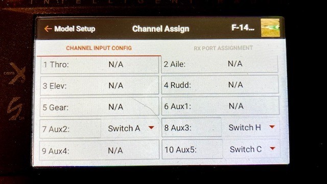

    You cannot create a mix if you just don't have enough channels available. The best solution would be to upgrade your transmitter that has more channels.
    He has a DX9. It's got plenty of channels to do what he wants to do. He's already said he's been able to do what he wants. His problem is that now, his retracts don't work. He's also stated that he has not done something with mixes on the gear channel. Something else is going on. It's nothing to do with not having enough channels.

      When I do to aileron and dual elevators I have my dear channel back on 5 when I add ailerons with lapse that's when I lose my channel 5 for gear and it doesn't give me the option to assign it back to gear thanks for all your help guys and girls

        I hate talking on a microphone When I do Dual aileron Dual elevators I have my gear on channel 5 when I do Dual Aileron with flaps And dual Elevators I lose my dear channel when I go to assign the channel the gear is that in the selection

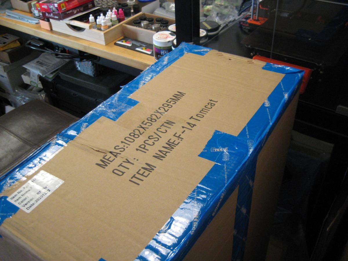

              Tomcatters,
              Proud Papa of a new ARF+ Kitten...WooHoo!
              Click image for larger version  Name:	IMG_0597.JPG Views:	4 Size:	117.1 KB ID:	301246
              Build Time:
              Best, LB

                            At that point the gear channel on your RX becomes the input for the flaps. You will have to use AUX 2 on both the TX and RX for the gear input.
                            I attached pics of my Spektrum setup using an AR9350, so only 9 channels. You will be able to see a working configuration. Sometimes if all else fails, start from scratch with a new model on your TX and RX. My channel 10 is programmed for Gyro gain. Aux 2 & channel 7 is Landing Gear, and Aux 3 & Channel 8 is Wing Sweep. Using spektrum receivers with built in gyros (AS3X), you do not need a physical channel open for gyro gain or mode selection.
                            I don't know about other RX's with built in gyros, but using the separate HobbyEagle A3S3, I needed 2 channels open just to use all of the capabilities of the gyro.
                            Click image for larger version  Name:	33.jpg Views:	0 Size:	58.2 KB ID:	302463Click image for larger version  Name:	22.jpg Views:	0 Size:	55.6 KB ID:	302464Click image for larger version  Name:	11.jpg Views:	0 Size:	62.0 KB ID:	302465

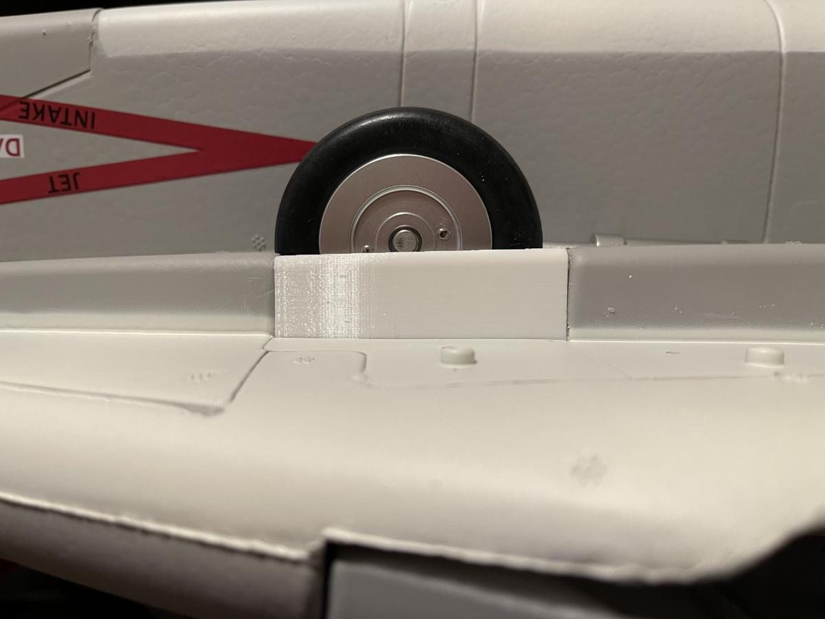

                              I got some work done on designing the main wheel well side covers. I test printed them and they fit pretty good overall. I may put these on Thingiverse if there is enough interest for something like this (I imagine very little, but who knows). It at least hides a very small part of the main wheel. The wing pylons hide more and I’ll be using those too.

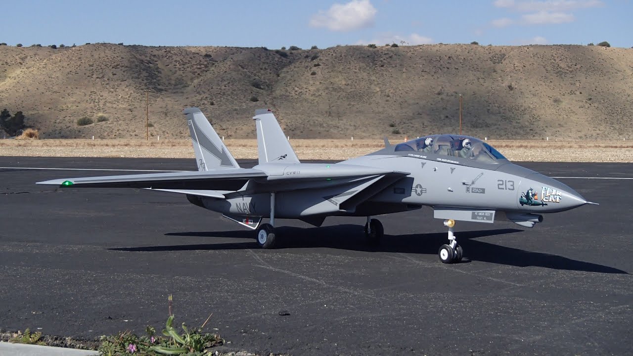

                                      So it's been a while since I posted something from the Mojave Desert...
                                      Here's Chris Wolfe's nice repaint of a Gulf War era F-14B, the "FLIR Cat" out at the recent Victor Valley EDF Fun-Fly 😎:
