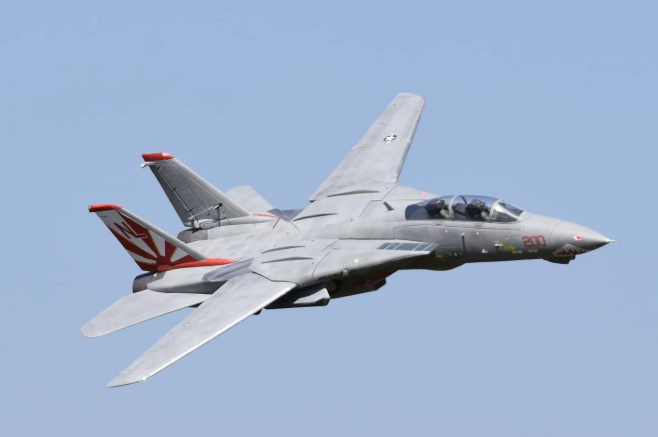

    Decide it was time to add the F-14 to the hanger. Went ahead and updated the power system to the 100amp Mig 29 setup. Graphics by Callie. If someone has a DX-9 setup file, or the link to download it, that would be a great help.

      Great livery and well done!
        #1163
        Nice!

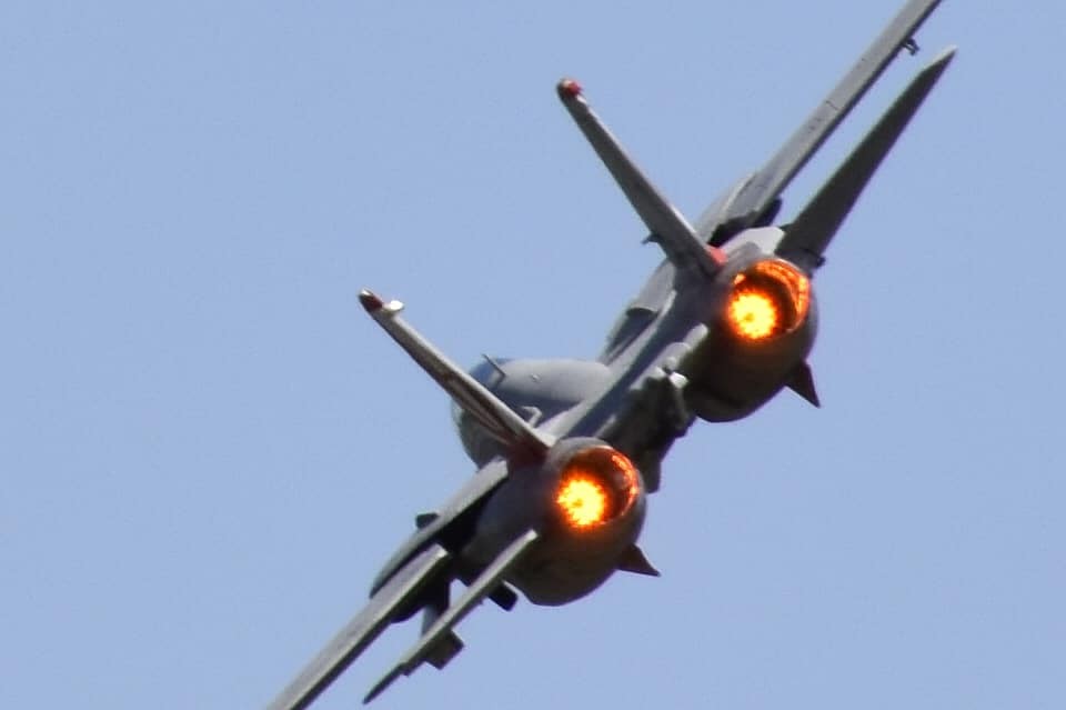

            Who doesn't love a good tomcat? Nothing beats that profile coming down hard on the deck. A10 power system and twin rc geek centerburners. Just hit 200 flights on it this past weekend.

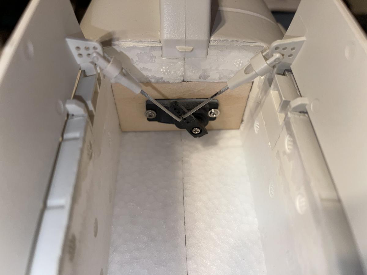

                Was wondering if someone can post a picture of the gear door servo arm. I snap mine and for the life of me can't figure out how the two rods connect to the servo arm to manipulate the doors. The book doesn't give any further detail other than use the second outmost hole, but one rod is coming up short. Any help would be greatly appreciated.

                  Try swapping the rods and/or adjusting one or both for length.

                    What is left of the original arm looks like both rods where in the 3rd hole. Drilled out a new arm so the both would fit, and they bind on each other. Used #2 and 3 hole separate, but I either have a door which opens like it should, but doesn't close all the way, or if I adjust the clevis to get them to close, then one doesn't open all the way and the gear binds when I retract the nose. I have used a combination of every hole on the arm, adjust the clevis, repositioned the arm, but can't figure it out.

                      They need to be in the same hole and the hole has to be big with some slop in it.

                          Here's a picture. You just keep messing with the holes and the length till both doors close the way you want. It's all trial and error.
