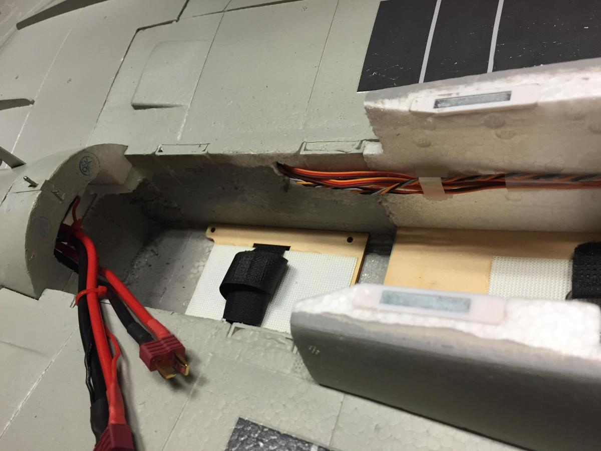

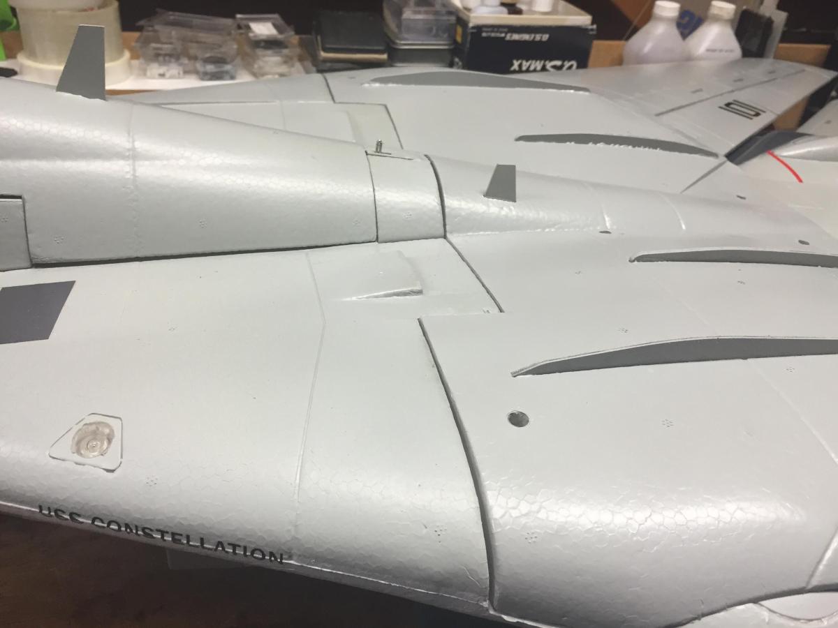

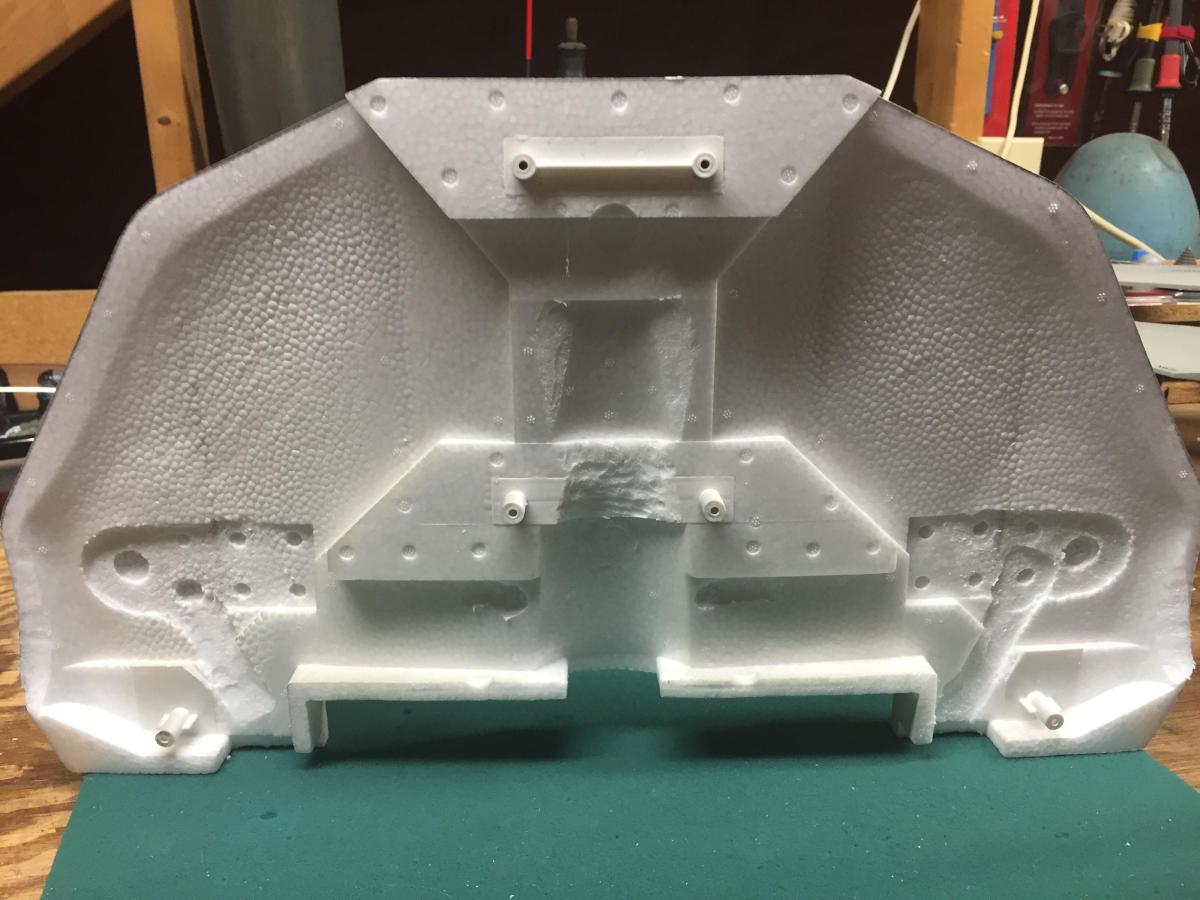

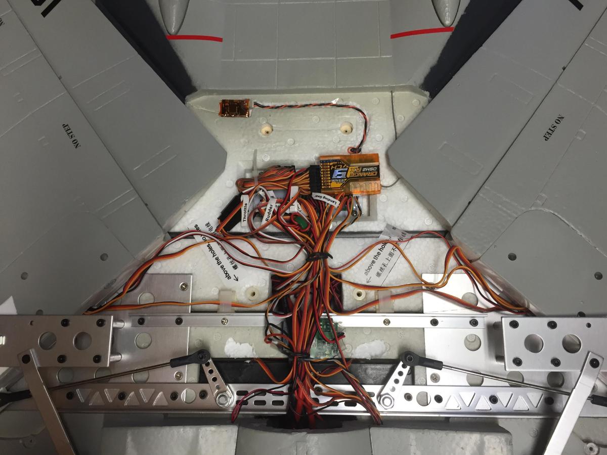

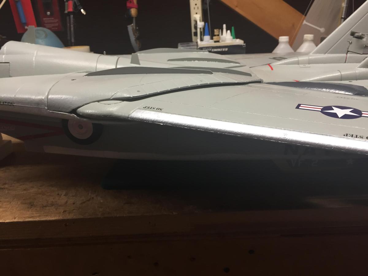

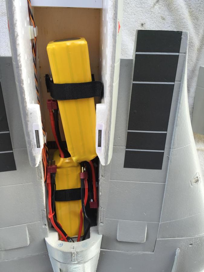

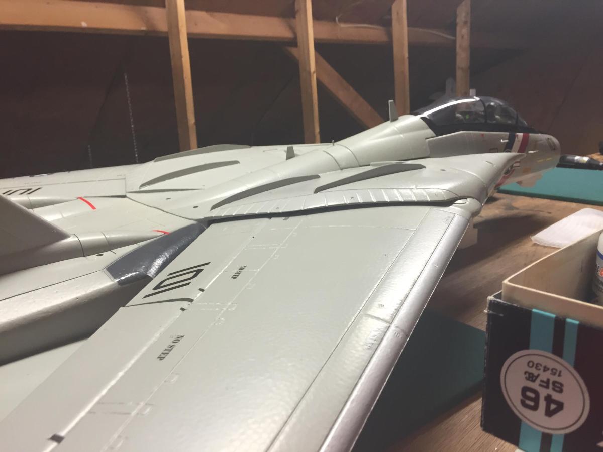

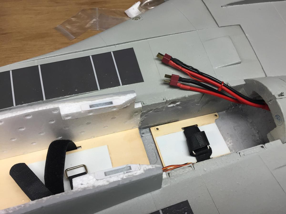

                  Mine was a very early one and took a lot of massaging to get the batteries where I wanted them, wires hidden and the cowl over the wing fold to fit acceptably. Some pics. Batteries were 705g 5000mAh Zippy Compacts.

                            Where you have the batteries in pic, where abouts does your cg ride in relation to the factory spec?
                              • 5402
                              #1314
                              Sorry but that was long ago. By memory it was close to book balance.
                                      No worries, I think mine is still a bit ahead of book value, but super close as well.
