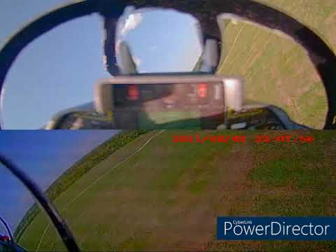

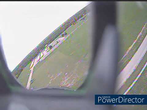

                  Quick test of my camera system. I am changing the cameras out and will test it again at the Brenham field. I just don't feel comfortable at this field anymore.
                    #1489
                    Almost go time for fpv test flight 2 with the f14, 1st with the new cameras on my fpv rig these give give much higher field of view. I will post the video when. I get it all edited together at home. The new video will have front and rear seat views.

                    I assume wider FOV. Your earlier video was quite narrow.
                      #1491
                      Yes much wider, the old camera suuuuucked. These are night and day different here's the shop test to get a perspective.
