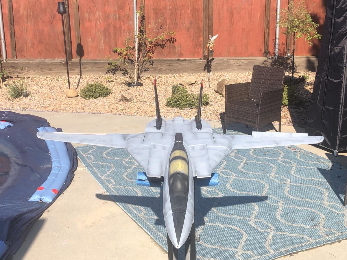

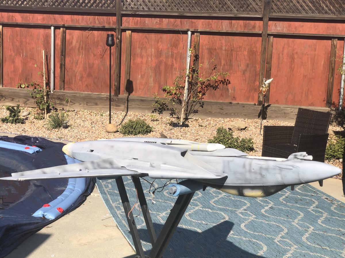

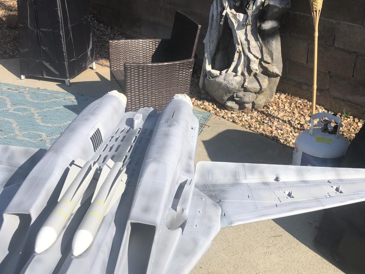

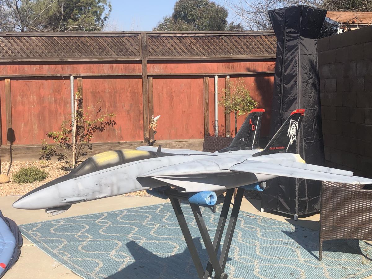

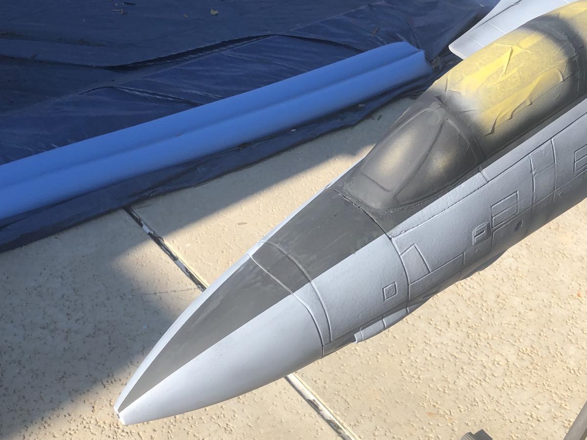

                  • Update pics, base is all done just some small areas to paint left.

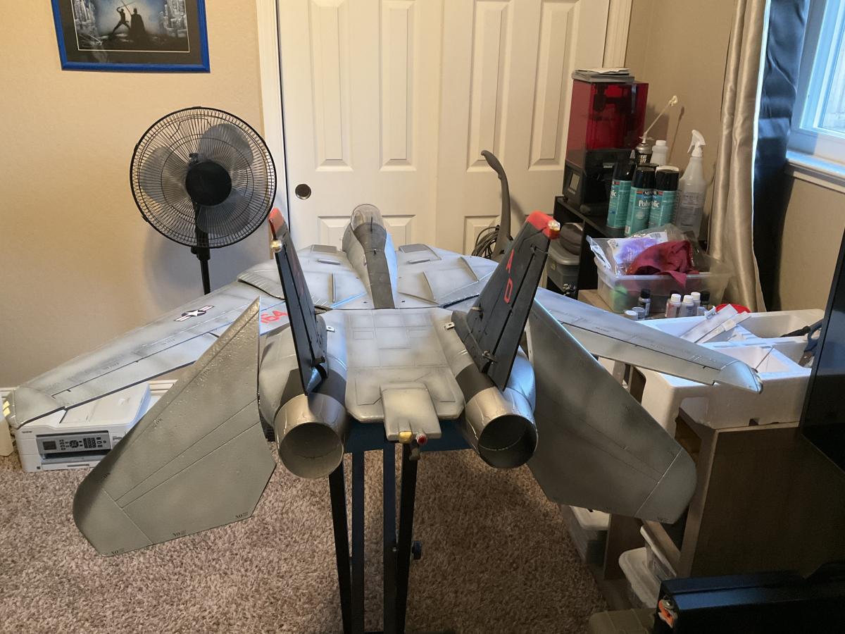

                    back of engines that show before the nozzles.

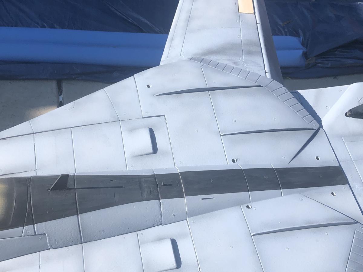

                    area that is where the wings site when swept.
                    leading edge of wings.
                    then It’s clear coats and decals.

                    • Originally posted by Gravythe clown View Post
                      Update pics. Gravy
                      GC, love the 'greys' and all the pre-shading work. Bravo Zulu, Sir. Best, LB
                      • Thank you sir, laters on layers on layers. I still got a bit but I’m happy with it so far.
                        Gravy

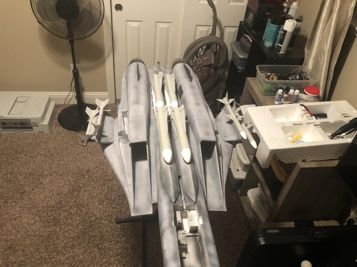

                        • Got my second load out set today. Now I can have her set with full load out.
                          also got my left wing spoiler complete.
                          need to paint the back Phoenix rail section to match the front and add some wooden braces to secure the back section.

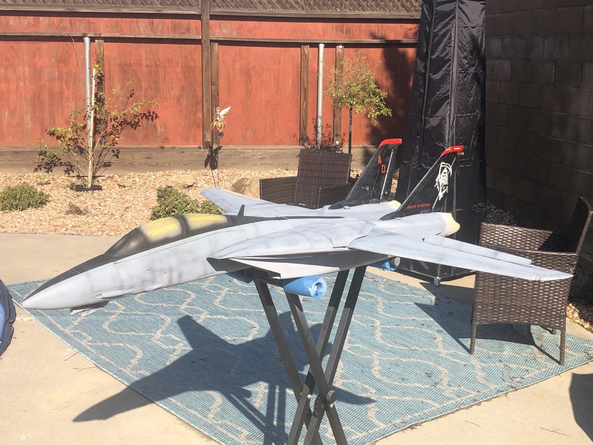

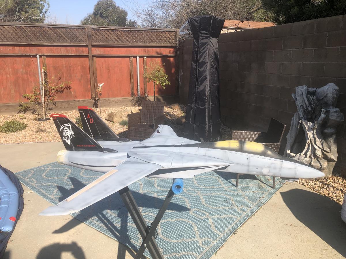

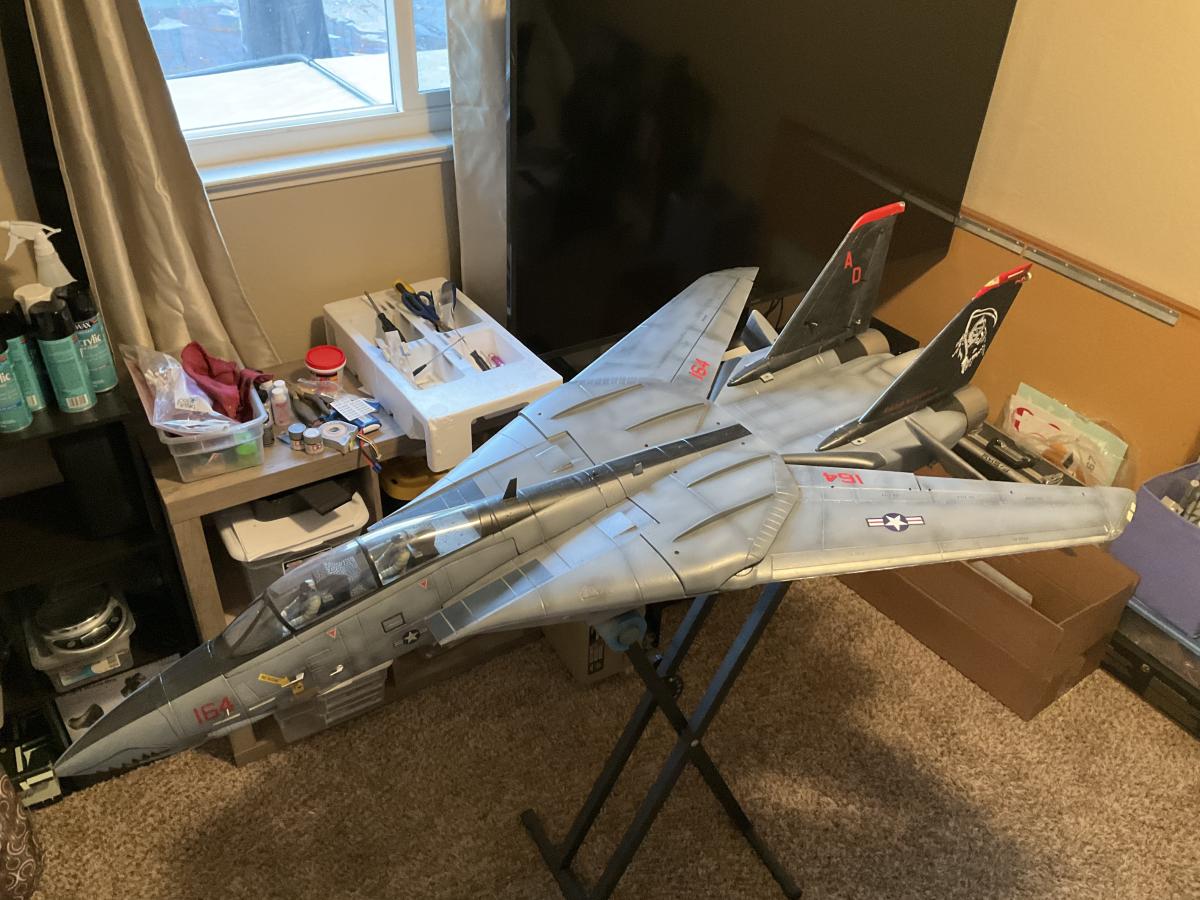

                          • Got it decaled and clear coated. I use a combination satin and matte. I’m happy with it and will start now on the reassembling. I still need to finish the spoiler wings. That will be my project this weekend.
                            Gravy
                            • Exceptional!
                                Gravy
                                GtC, What Evan D said and I'll add 'stunning/menacing. Best, LB
                                • Thank you guys. The pressure will be on for the first couple flights. Even though she’s an oldie, the hands will be shacking on the first landing. Lol
                                  Gravy
