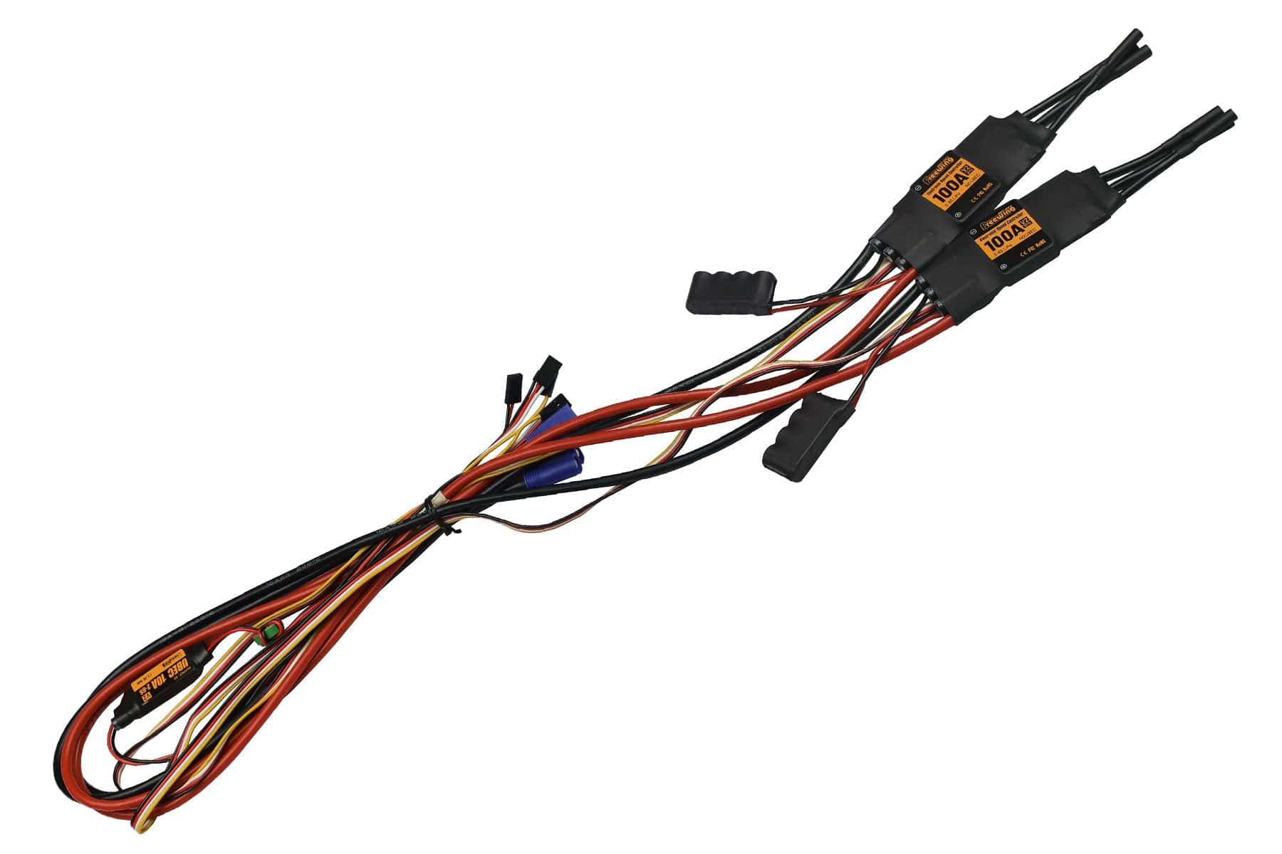

                                • I just purchased a Freewing F-14 without any power systems because I am going to install the 2100 KV motors. I am looking to upgrade Avian 100 amp ESCs. Do I need to disconnect the middle BEC circuit on one of the ESCs?
                                  • Originally posted by Having Fun View Post
                                    That is generally recommended if you're running two ESCs with integrated BECs.
                                    I put upgraded motors in mine and used the MiG29 ESCs with separate SBEC and additional capacitors, already fabricated and pretty much a drop-in install.
                                    80mm EDF MiG-29 100A ESCs with 8A UBEC (Set) from Freewing - 084D002001 Two ESCs included with 10A BEC and has reversing functionality.
                                    • Originally posted by kallend View Post
                                      https://www.motionrc.com/products/fr...set-084d002001
                                      Having Fun, the AVIAN ESCs are overkill for this model, because you will have to use a Y-Harness and Y-Harnesses negate the telemetry and programming benefits of owning an AVIAN. AVIANs also mean no afterburner because the Y-Harness creates issues there. You could make it work if you have a separate channel for the second ESC and a separate channel for your burner; however, that limits all the other fun stuff you can do with this aircraft.
                                      Kallend’s recommendation is ok, I’ve used it; however, if you want the latest equipment with the most functionality, such as reverse, use the 100A ESC that comes with the new F9F. I ordered 2 of the same motor you’re planning on using (3658-2100kv), but I also ordered version 2 of Kallend’s recommendation. Here’s the link at RC Castle where they have it all in stock. Mine shipped already and I ordered it yesterday. This setup pushes 200g more thrust than the next best FMS 3665-2000KV motor; however, it’s a drop in fit unlike the FMS that requires some foam shaving for a clean fit. (https://www.rc-castle.com/index.php?...oduct_id=10340).
                                      • Dougcarr73 Whoa, great intel, Sir. I thank you. Best, LB
                                        I don't do this because it is easy; I do this because I thought it would be easy.
                                        ~LB~
                                        • Thank you Dougcarr73! I just want to make sure I have this straight before I plug anything in. Do I "Y" cable the two throttle leads and still have the reverse functionality? Or, do I disable the middle lead to the throttle on one of the ESCs? where did you find the programming instructions?
                                          Thank you!!
