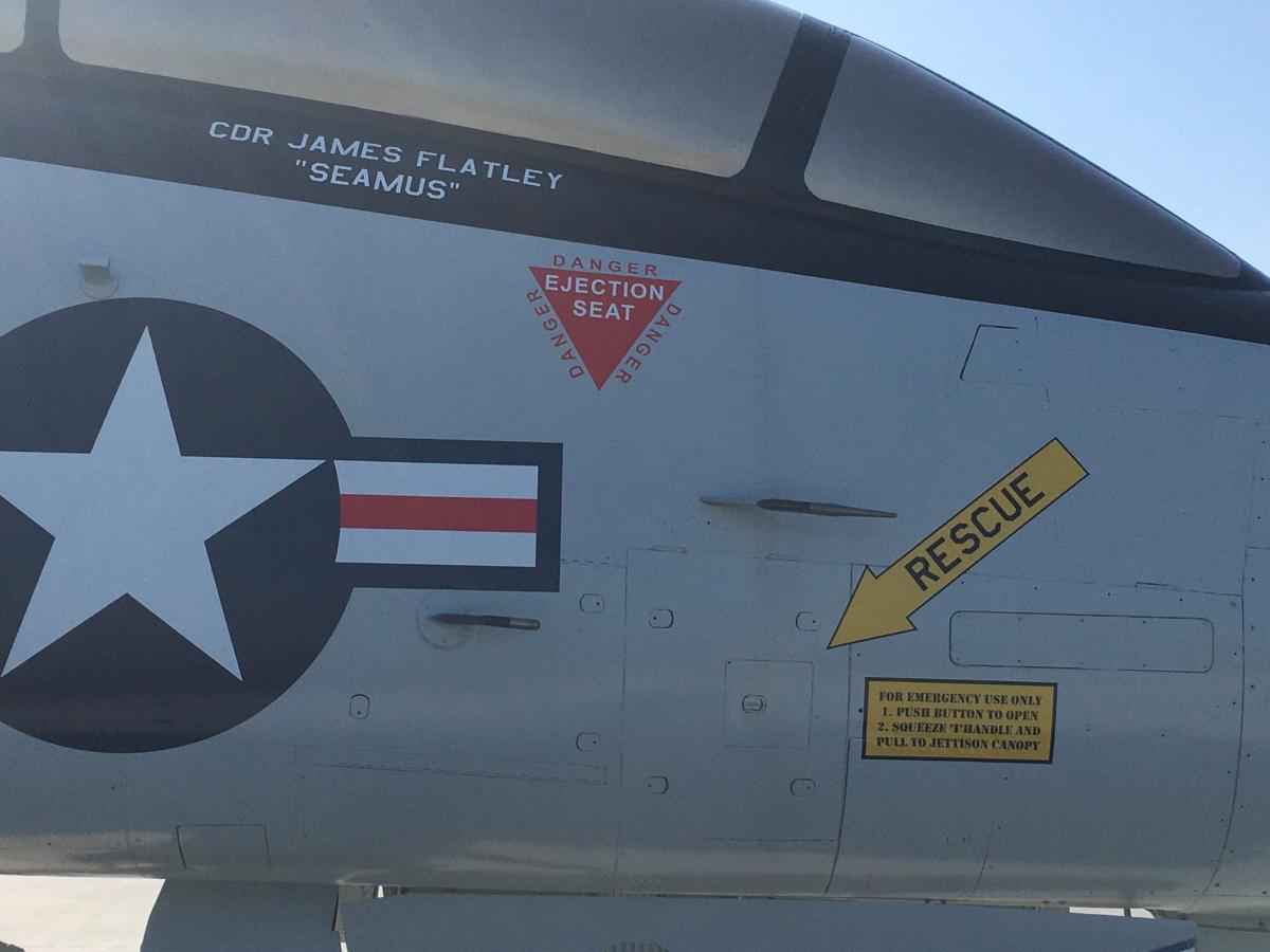

              I’d be happy with them fixing the “RESCUE”.

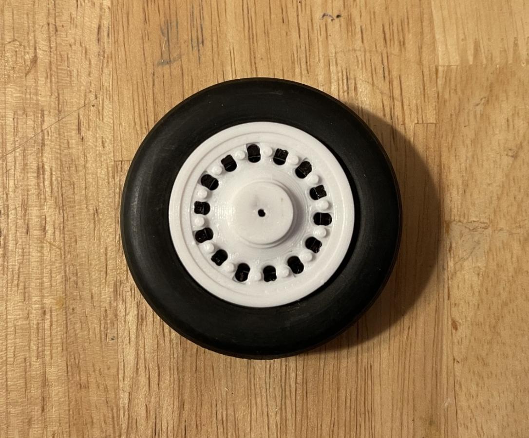

                                • Originally posted by T-CAT View Post
                                  Here are the F-14D wheel covers I promised to make.
                                  Click image for larger version  Name:	image0.jpeg Views:	662 Size:	135.5 KB ID:	298983
                                  Hi T-CAT, I was wondering if these are still on Thingyverse, as I could not find them. link is dead.

                                      I have an STL file. Let me know if T-Cat doesn't respond.
                                      • Originally posted by kallend View Post
                                        Thanks Kallend, I found all your stl's, I will start to print soon - could you send me the hub STL? want trade two gear plates for it? :-)
