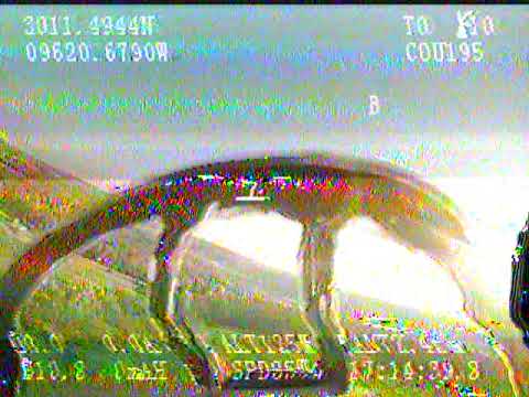

                                    #1578
                                    Here was my test flight where I got a general landing speed with my setup.
                                    • f4u ausie

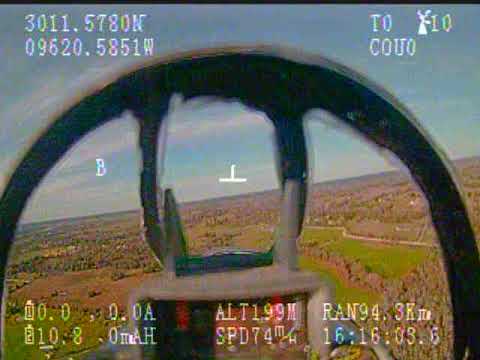

                                      #1579
                                      Thats cool stuff,, once in the air, a dumy question,, how do you no which way is home(runway). Think i would get lost,, but would .uv to do it
                                        • 8827
                                        #1580
                                        Follow the "B", relative to the upside down "T". Altitude, speed and distance is given on the screen. Some displays shows it in a different way, but usually shows where the plane is and where the pilot is in some pictographic way. I stopped doing it as I got sick to my stomach.
