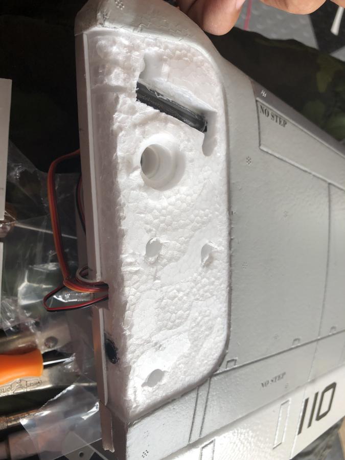

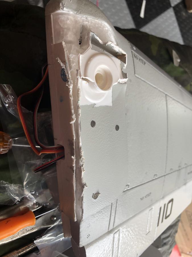

                                  last weekend I did an abort take off at speed and ran out of runway, the plane flipped and broke the wingsweep plastic tab on the wing.
                                  If anybody is curious about how to replace it, here is what I found.
                                  the part is glued to the wing, PITA to remove, it would not budge with out deforming the foam, solution was to Dremel off the side of the mouthing plate, then use a long blade and cut the glue off, still had to use players to pull up the piece.
                                  I’m not replacing the bottom half, no damage and is not worth the headache. The complete set is $2 not bad!!!
