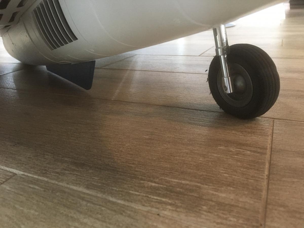

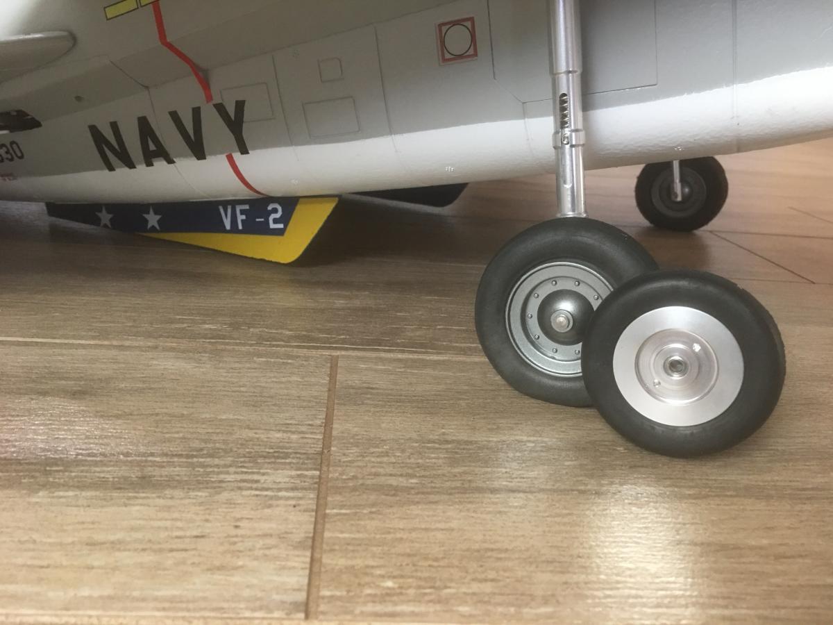

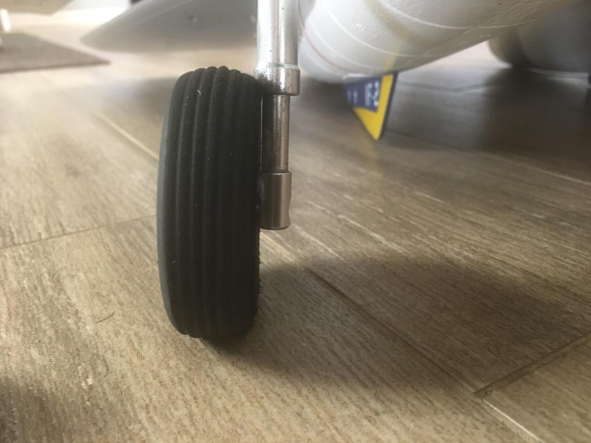

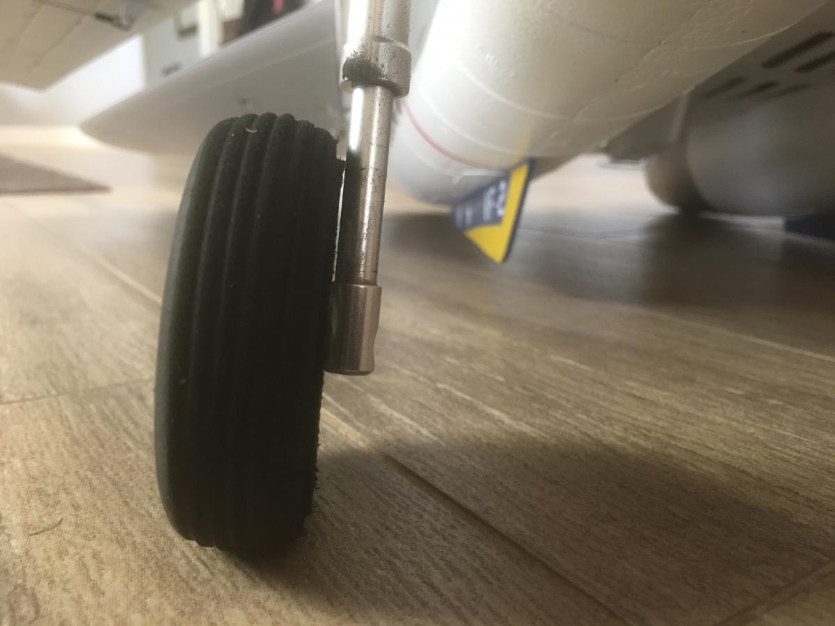

    The stock wheels have got to go. They’re definitely way too heavy. My first flight yesterday was all stock except I tightened the wheels. My flights today were remarkably improved after I installed the nose and main wheels from my F-4 Phantom. You can reduce the weight by about three ounces just by swapping wheels. The softer material also increases rolling resistance which reduces landing distance. Also when the strut is compressed it rubs against the wheel slightly for braking action! My F-14 doesn’t start rolling until about 20% throttle. Takeoff and landing distance is about 150 ft. The stock power system is great. I’m curious if my A-10 Warthog power system would be an improvement. I’ll post videos soon. Note: The F-4 Phantom main wheels are larger than the F-14 though they still fit in the wheel well.
