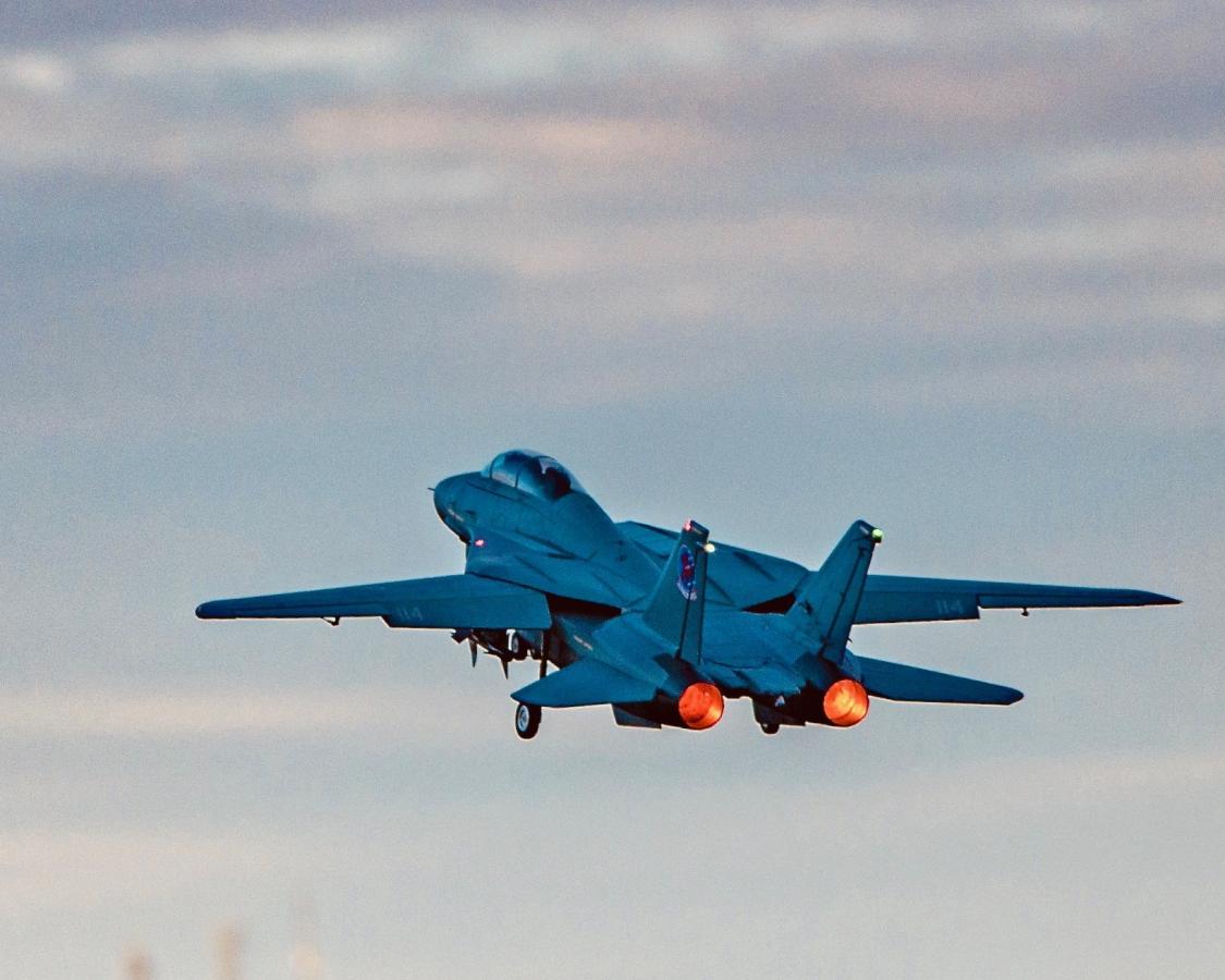

      Michael Hines happened to have a very nice camera with him at the local flying field when I was there with my Top Gun refinished Tomcat this past weekend. I've put this pic a few places on facebook, but I feel it's definitely got a home in this thread as well.
      Click image for larger version  Name:	F-14 afterburner takeoff.jpeg Views:	2 Size:	87.8 KB ID:	171430
        #423
        Gorgeous! If it weren't for the linkages I would think that was a full scale!

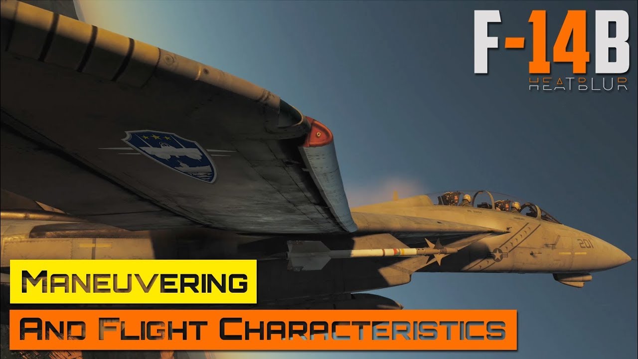

                                        I recently saw this interesting video about the F-14 unique flight characteristics in the soon to be released module for the DCS World flight simulator. By the way this will be the most sophisticated and accurate simulation of the Tomcat ever created. It has been in development for like 4 years.
                                        It left me thinking just how similar the FW models flight characteristics might have in common.
                                          #440
                                          I need him to cover why mine would bounce like a pogo stick no matter how clean my approach, airspeed and flare was. LOL
