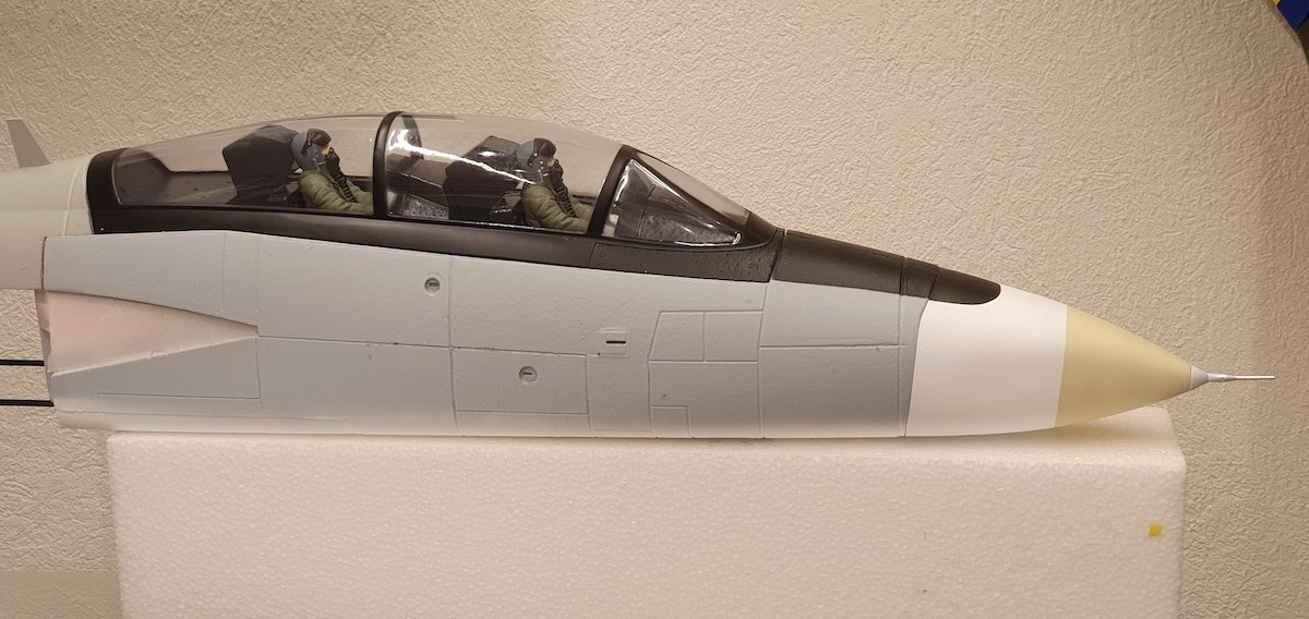

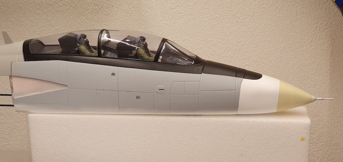

                          • Next project started..
                            I swear that I said "this time I fly before doing mods"

                            • Looks great! lol, I have said the same thing many times!

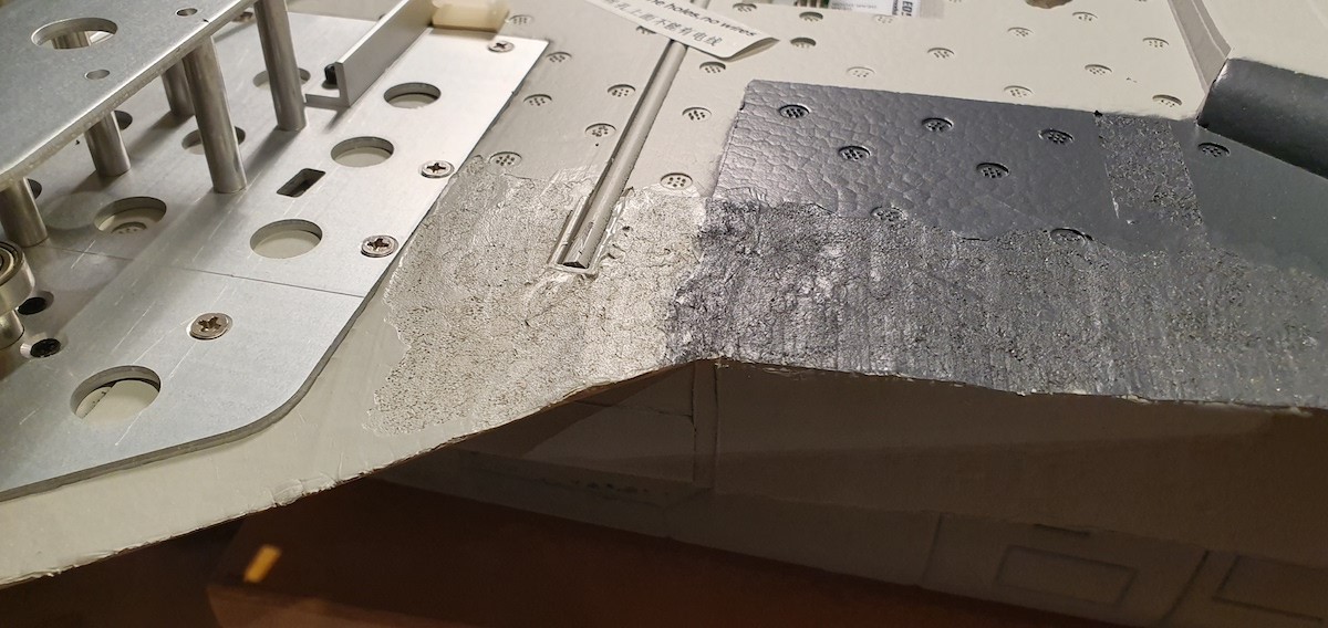

                                      • Hi guys,
                                        I installed one wing today and recognized that while sweeping the bottom of the wing scratches the surface of the fuselage. Does your fuselage look the same, it seems Freewing has to rework the moulds or so. What do you think?
                                        • I don't know how often it happens but some people (including mine) has to remove foam here or the factory did a test fit and did the same thing.
