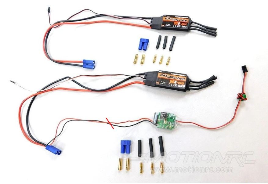

                              Got a about 15 flights on my stock tomcat now and loving it. Only mod is D85MG servos and a paint job. Have had a couple flights where I’ve heard the motors “hiccup” simultaneously and wondered what it was. Had a
                              brown out on my 90mm F-22 today where I totally lost the motor and flight controls, but was able to get just the flight controls back after a few seconds and dead sticked it back for a landing. Anyone else had this issue? Should I upgrade the BEC? If so, did those that have done it cut the red wire from the stock esc to the throttle Y cable just on one motor as shown below?

                                #795
                                Yes cut the red wire

                                    #797
                                    Why ruin a perfectly good ESC by cutting wire
                                    Just lift the plastic locking tab on the connectors red lead pin and pull it out of the connector and wrap it with some electrical tape to isolate it from inadvertently shorting out the ESC.
                                    This will allow you to reuse the ESC down the road in another application

                                      #798
                                      Hmmmm....are you sure? Because after further reading it looks like you only do that if the ESC has its own BEC....which the Tomcat doesn’t.

                                        #799
                                        Originally posted by Gvasiloff
                                        It's not ruined, just add another terminal if ever needed. I mention cut because that is what he asked. Doesn't take much lifting to disengage
                                        Sorry, brain fart. You cut the stock BEC off the battery wire leads and use those cut leads to put in your new BEC. My apologizes
                                        Cut where my line is and solder your new BEC there. Installed a castle 20amp
                                        Link to mine: http://www.castlecreations.com/en/cc...ro-010-0004-01

                                          #800
                                          Seems simple enough. Thanks!
