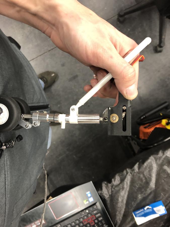

        After testing of the new main gear support plates and the nose gear reinforcement I finally had time and the parts to fix the landing gear servo and wing sweep servo.
        After completing the repair I notice the nose gear had a lot of play. Removed it and found what you see in the picture. There is no damage to the structural of the air frame. Nose gear is bent and servo housing is cracked
        Now I’m debating on what edf to swap it with. New in runner or go with the try and true A-10

          Oh Man... decisions.... 9 or 12 blade on the new in runner 80mm Would love to see what kind of flight times the F-14 would get on 2 9 glade set ups!!

            The a10 setups probably weigh a lil less. Same rotor...id be curious to know the exact amp numers and rpm numbers between the inrunner and outrunner. Id say if you can afford it..go inrunner. They are normally more efficient

              Order 2 fw inrunner setups to 3658-1875kv and esc

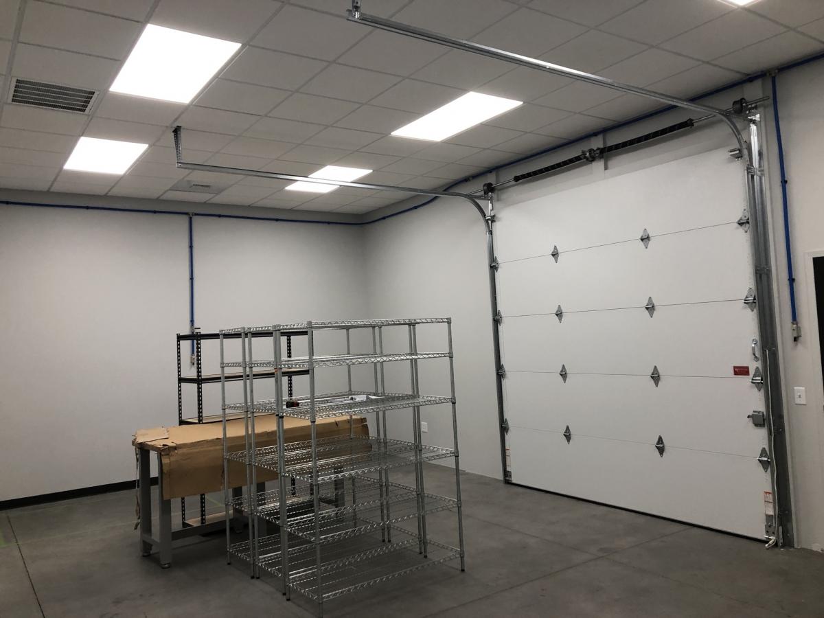

                        I had the opportunity around Thanksgiving to move my machine shop. Which would allow me for more machines. I took the risk. Looking to be back at it in two weeks. New machine arrives this coming week.
                        Getting these and the other RC project I've been working on are my first priority. I appreciate everyone understanding with this.
