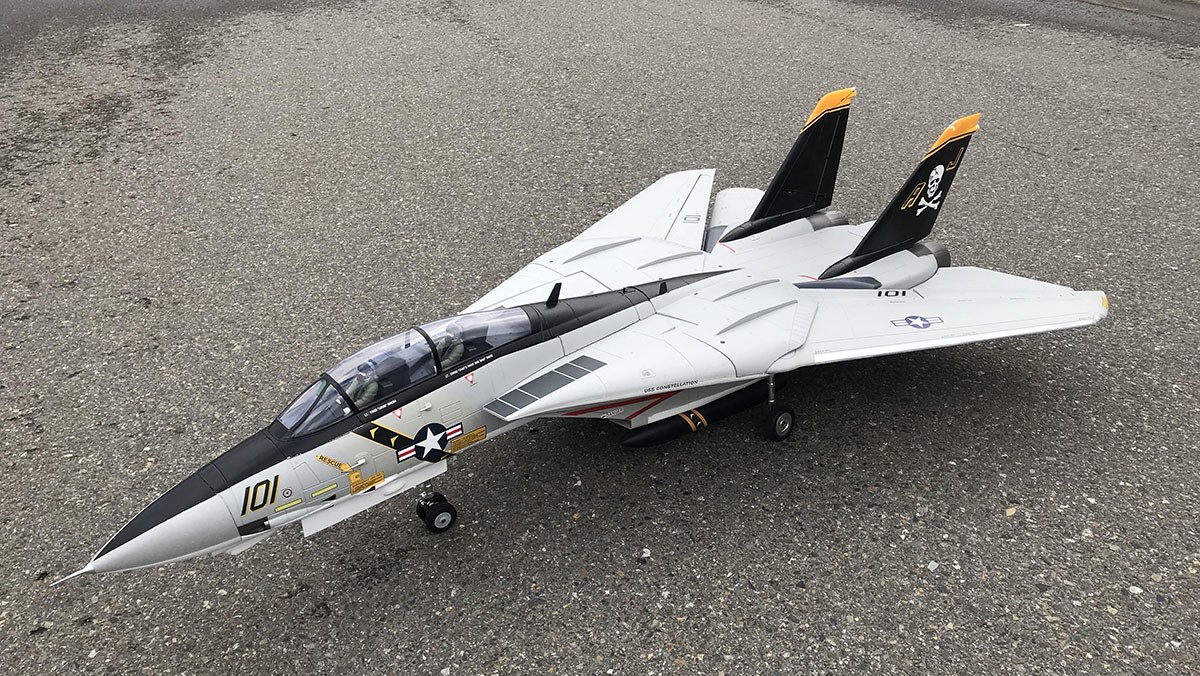

                    #929
                    Finally dug my second one back out from the black hole that is my garage and started working on filling and repainting. The full flying stabs are done. Filled holes, sanded, primed, sanded, painted, decaled and sealed with a couple coats of Testors Dullcote. Working on painting the verticals now.
                    This is a kit that I bought second hand new in box, and it came with the A-10 fans/motors and a set of graphics from Callie for VF-1 Wolfpack. Between Callie's graphics, a set of spare decals I bought from MRC a while back, and a few custom decals I'm doing myself, it should look pretty good. Not as nice as the one Brent did last year, but something I'll be proud of. This will be a dirty bird too.
                    I had put the A-10 power system in my first one, and it did better than stock and was happy with it. But this time I'm ditching the A-10 power and going with a pair of the T-33 inrunners. Should have some nice giddyup now!
                    Dry weight = 4160g
                    Batteries = 780g (pair of RoaringTop 5800 35C)
                    AUW = 4940
                    Static thrust of two 80mm 9bl inrunners = 5800g
