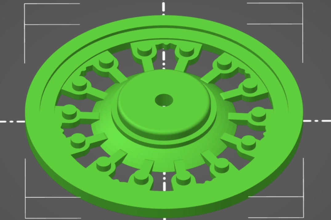

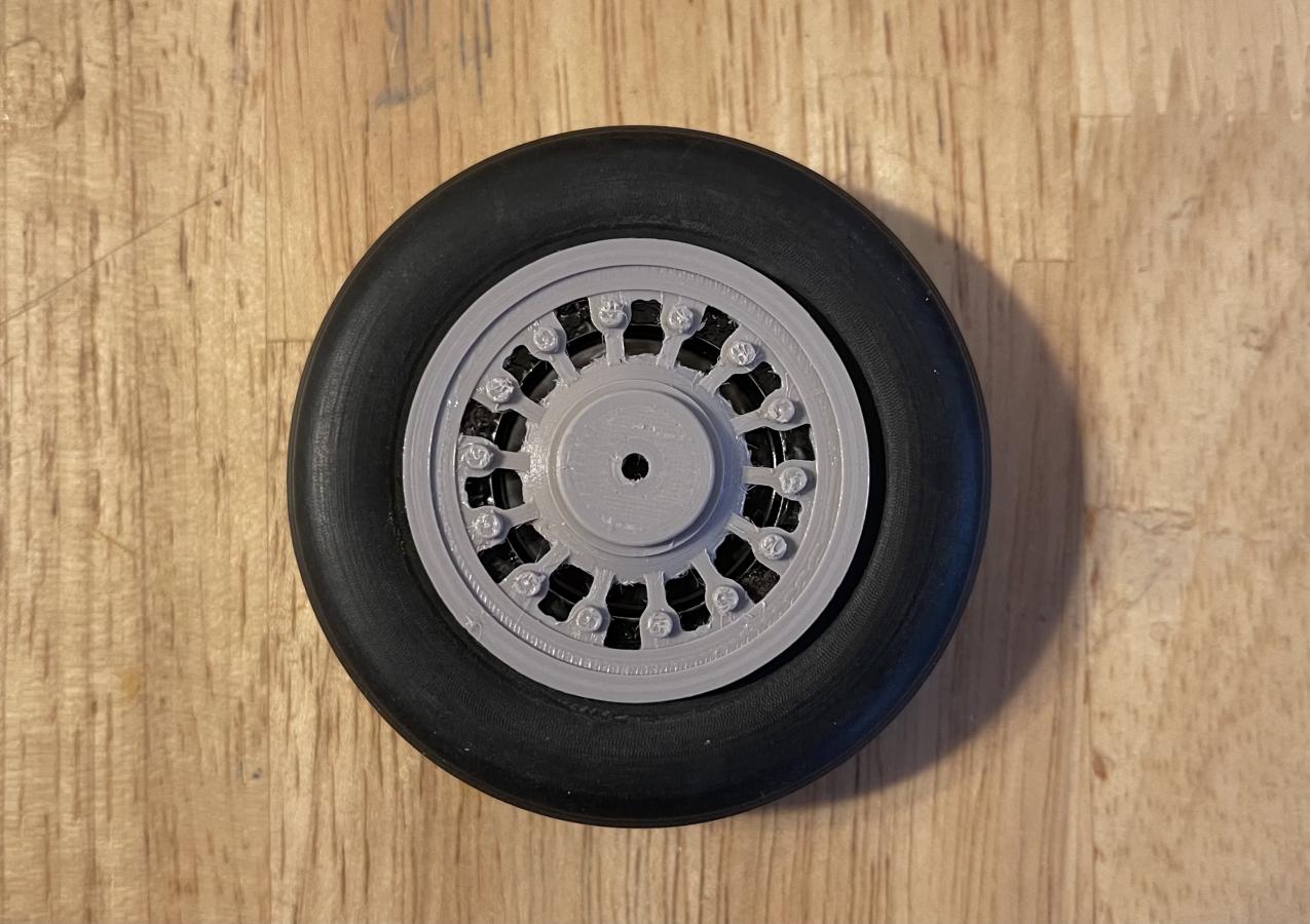

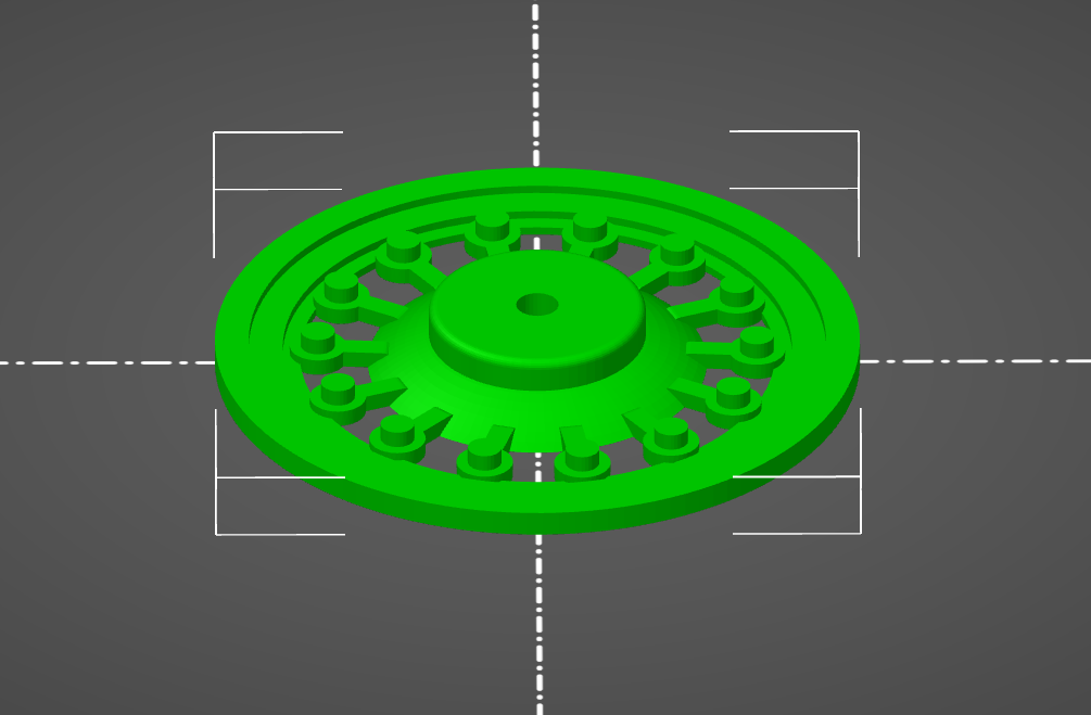

    • I have modeled some simple F-14A model main wheel covers that glue onto the supplied main wheels for Freewing's F-14D 80mm EDF Jet. For those who wish to convert their own Freewing F-14D to an A-model, this A-model main wheel cover may be of aid in the process. The STL file can be downloaded via Thingiverse at the link below.
      I painted part of the supplied Freewing main wheels with black paint to create an illusion of depth (but left unpainted room to ensure I can glue the printed wheel covers to the metal wheel and not onto paint). Then, I painted the printed wheel covers in gloss white, as well as used black marker for detail accents.

          Thanks, Elbee! I’m happy to contribute to the hobby in any way I can. Hopefully this helps some people converting their F-14 to an A-model.
          You, Dirty Dee, Radar-Guy, Alpha, and others here have been great inspiration for me to 3D model, and to get a 3D printer. Thank you!

                • Update to the STL file for the wheel covers. I added some more detail to look more scale, but still kept it within reason to ensure that detail could be printed. At 0.07 resolution or better, the wheels and detail came out good. New pictures attached, and I updated the Thingiverse file as well with the new STL.

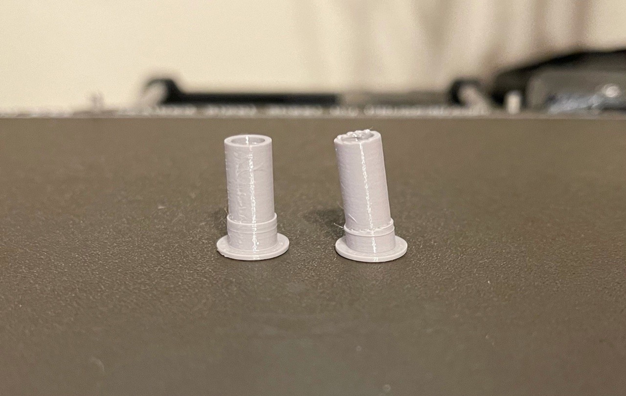

                        • I 3D modeled some wing box cover screw hole plugs to use after screwing on the cover to help conceal the foam screw holes for better visual presentation. I have always disliked the eye sore of the screw holes of the cover, so this is an idea I had to cover them up by means of a rather easily removable solution. One plug is angled and intended to be used on the two front and two middle holes. The straight plug is intended to be used on the two rear cover holes.
                          If you don't mind, please 3D print them and test fit these to your Freewing F-14 80mm EDF Jet. Let me know if they need any modifications/revisions to the design. I'm not sure if some covers have changed in any way over the years on this jet, the tolerance, etc., so these may or may not work as is for you.

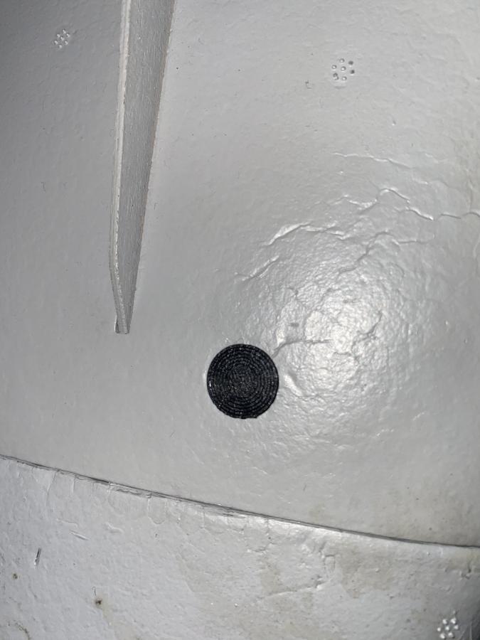

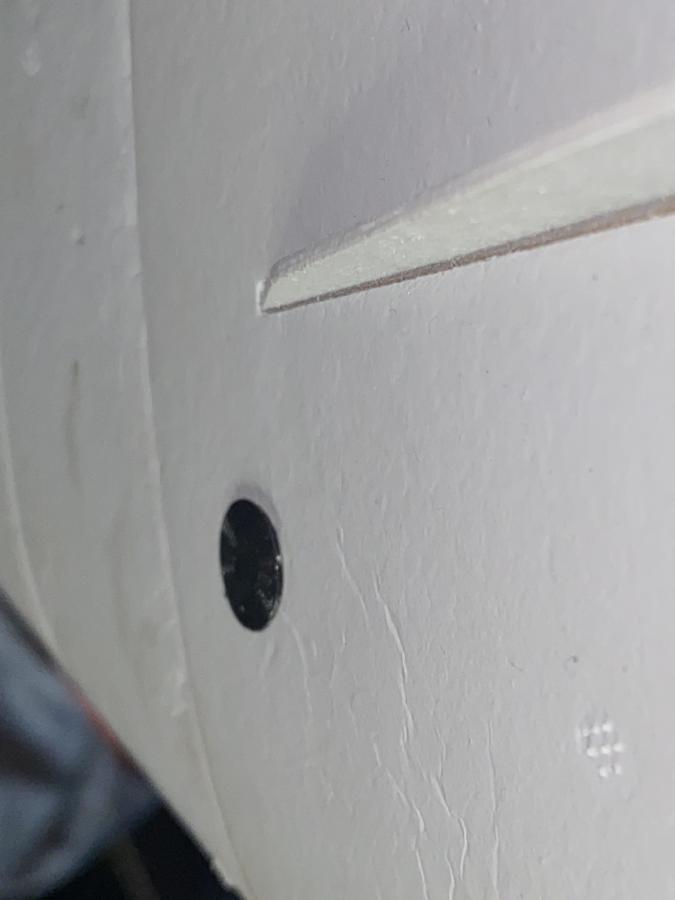

                                  Still need paint but they fit well and wont fall out on their own. The angle one works well enough for me and what it's intentions are, but the low side could use a bit more of angle to meet the foam, the high side seems fine. It is turned to the optimum alignment as well. I know that's hard to quantify and tweak in the CAD and hopefully the pictures show what I mean.
                                  Thanks for taking the time!
                                      Thanks a ton for the great feedback! This should help me achieve a final design after modifications.
                                      Hopefully you don’t mind me asking more questions to see what needs to be altered . Since I don’t own the F-14 any longer (I’ll be getting another later this year to modify), I’m doing the 3D modeling without a jet in front of me, ha-ha.
                                      1. Just to be sure, when referring to the low side requiring modification, is that referring to the part closest to head of the plug?
                                      2. Does the angled plug need modification to fit in both the front cover holes and center holes, or just one, the front or center?
                                      3. In the hole that the angled plug needs altering, when the angled plug is placed in the hole, what orientation of the turn is the plug at (angle facing forward, aft, etc.?) so I can see where the head of the plug needs to be angled more or less?
                                      If you don’t mind taking a picture(s) of the angled plug half way out or marked with how it is turned in the slot to properly seat, and possibly a quick pencil drawing of the angled plug and the mods needed to help me visualize it.
                                      Thank you!
                                      • 1. Just to be sure, when referring to the low side requiring modification, is that referring to the part closest to head of the plug?
                                        I was referring the low side as closest to the center axis of the fuse or the hump in the cover. The angle slopes towards the center line of the plane
                                        I actually found the straight plug to work better for the front and rear holes and the angled for the center holes. When the angled is fitted in the front it does not sit flush as the foam in that area is for the most part flat. The two last pictures I posted earlier are the straight plug in the front hole.
                                        Angle is facing towards the center of the plane. Its pretty hard to get a decent photo of it but the inside (center line side) of the angle only sits up about .5mm-.75mm.. eyeballed
                                        Apologies in advance for my crap photoshop skills
                                        Thank you!
