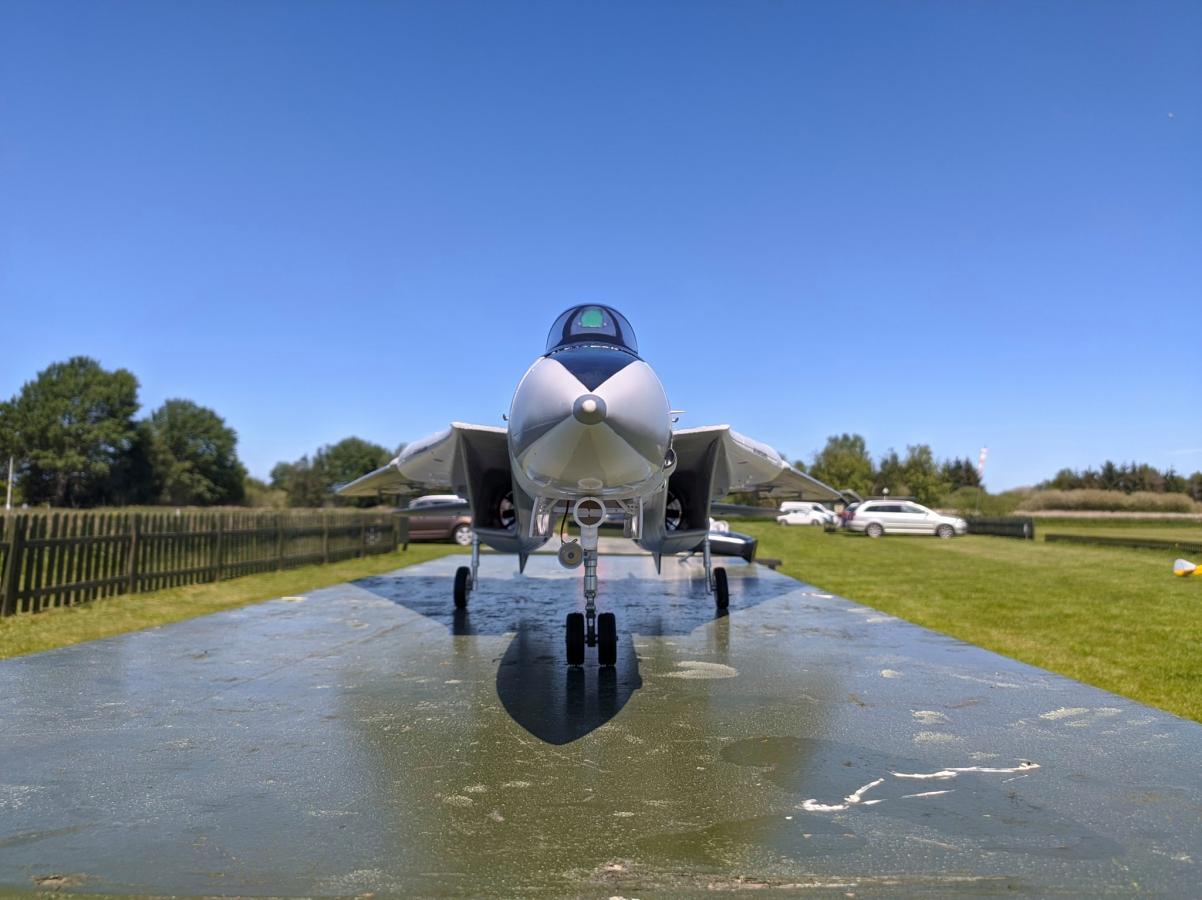

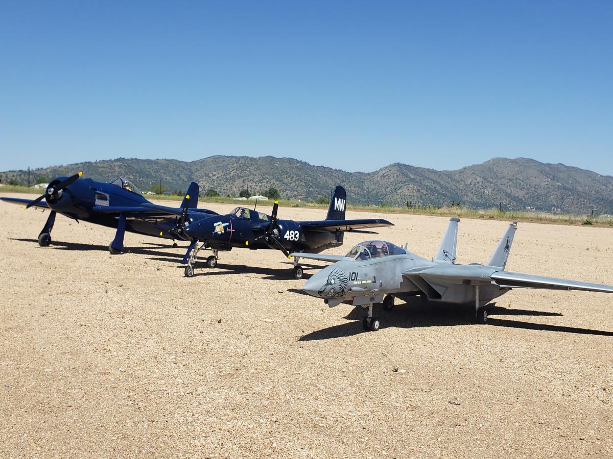

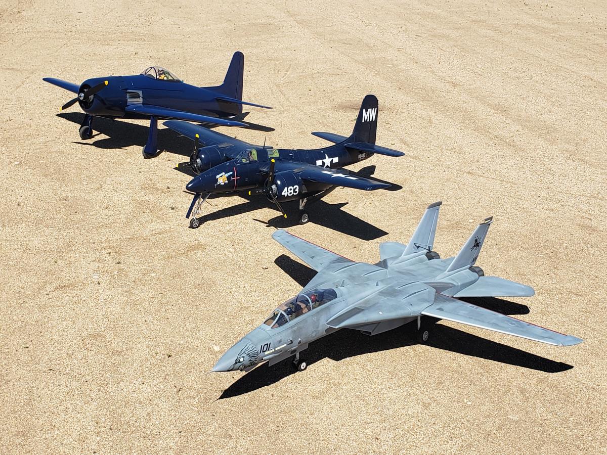

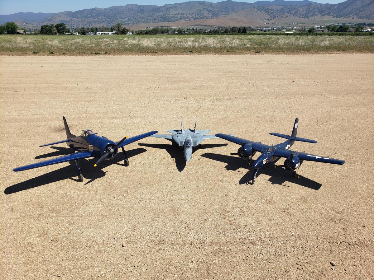

We had a grumman day at the field yesterday. Had my f8f and f14 out for some great flights. F7f belongs to my dad.

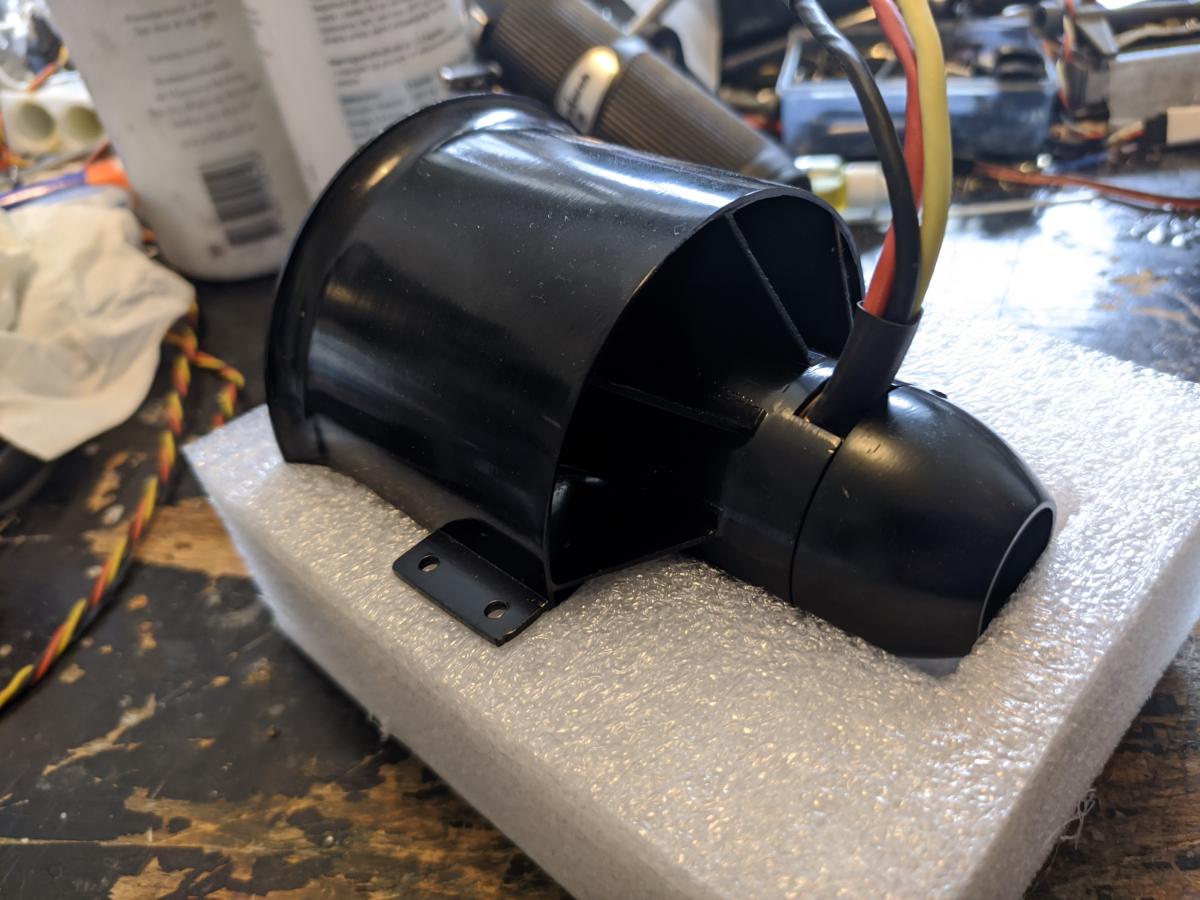

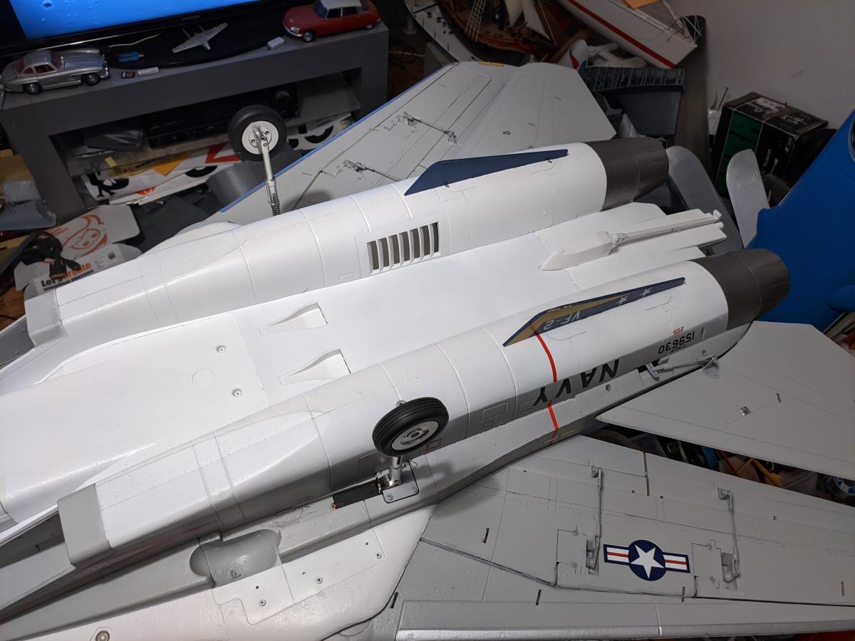

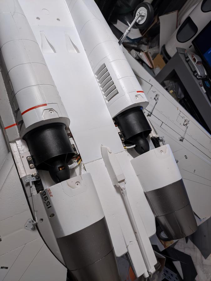

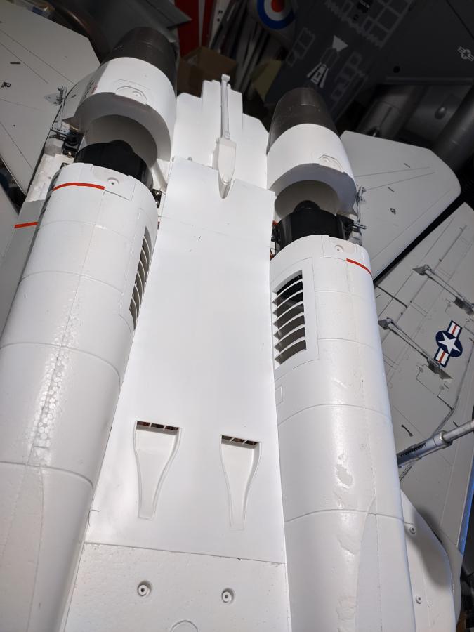

Those look great! I'd be interested in the .stl's. I'm rebuilding mine and might consider installing those.Originally posted by GarrisonR View PostWell I picked up a F-14 ARF, I have wanted one for a while now and I was inspired by Cosair Nut’s build/paint videos, I figured while my flying fields are shut down and with all this extra time I’d make it happen. I’m filling in panel lines, repainting and using A-10 ESCs with T-33 9 blade inrunners. Might test out the 12 blade rotor eventually.

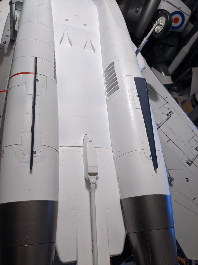

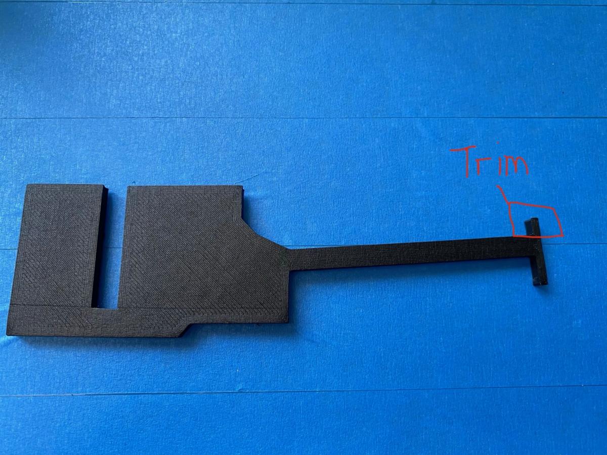

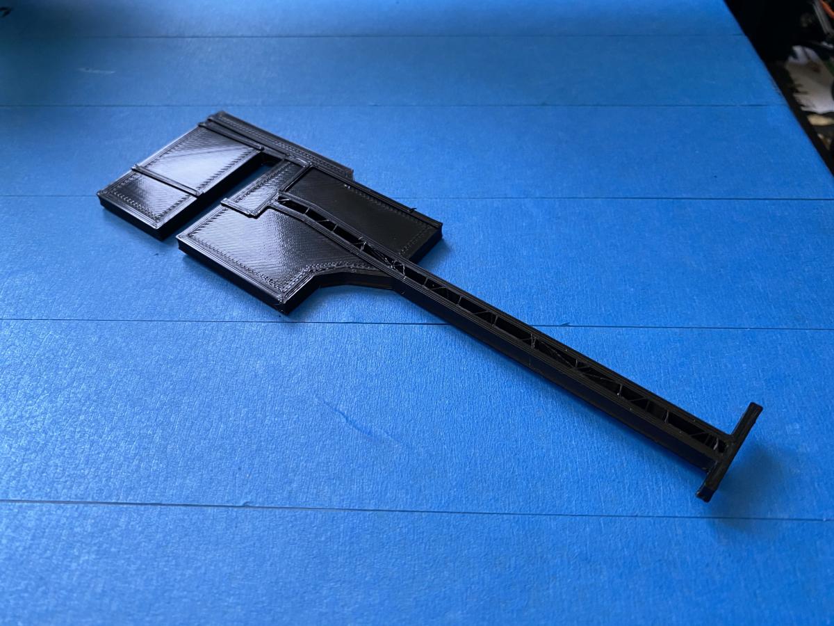

I designed this 3D printed main gear brace. I don’t fly off grass but my clubs runway has it’s issues and I figured for the occasional hard landing it’d be worth it. Plus I have the time..
I’m open to any and all feedback on the design, especially before I glue or epoxy it in. Thats my other question, do you guys think I should glue it in with Foam Cure or use epoxy? The glue I'd use is similar to the included freewing glue and has a bit of give to it.
The brace weighs 35g with 15% infill but was honestly plenty strong with 10% infill as I increased the wall thickness and top/bottom layers.
I also plan to strengthen the nose gear, likely with some variation of the RCINFORMER’s method.
If others are interested I can post the STL also.
Attached! Just mirror about the long axis in your slicer for the opposite side.Originally posted by vduniec View Post
Those look great! I'd be interested in the .stl's. I'm rebuilding mine and might consider installing those.Attached Files
Nice, no problem!Originally posted by crxmanpat View PostThanks for the file! I printed up a set yesterday for the one I'm going to be working on soon. Nice solid structure and low weight.
Quick notes I forgot to mention
-When clearing out the foam for the flat bit on the end (did that for more glue surface area in an additional direction) be careful to not go too deep on the inner side (closest to jet centerline) as the duct for the edf is just below. You cold even trim off the inner portion of the flat to be safe.
-You can use the brace for the opposite side, placed upside down to trace on the foam for where to cut, or you could also print 1 more and stop the print short (before the long bits stick up when printing upside down) just flip it over for the other side.
-Removing the foam on either side of the end of the carbon spar and you will be at the top of the gear mount, thats the depth of foam to be removed for the top of the part that sits flush with the foam.
If you have any questions just let me know! Mine when in without a hitch, and literally snapped on to the gear mount perfectly.

Your Tomcat looks outstanding. I had the opportunity to see them often throughout the 80's and 90's and your weathering looks great. Excellent job!Originally posted by Corsair nut View PostWe had a grumman day at the field yesterday. Had my f8f and f14 out for some great flights. F7f belongs to my dad.

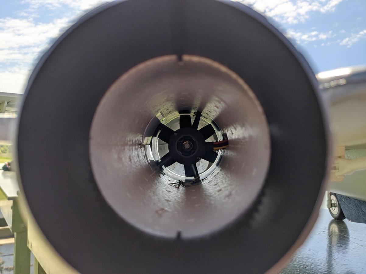

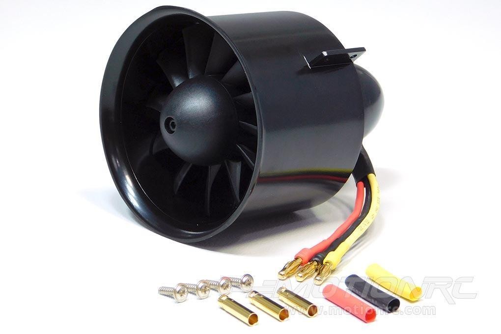

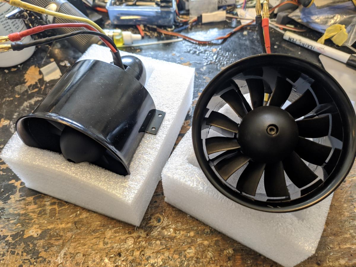

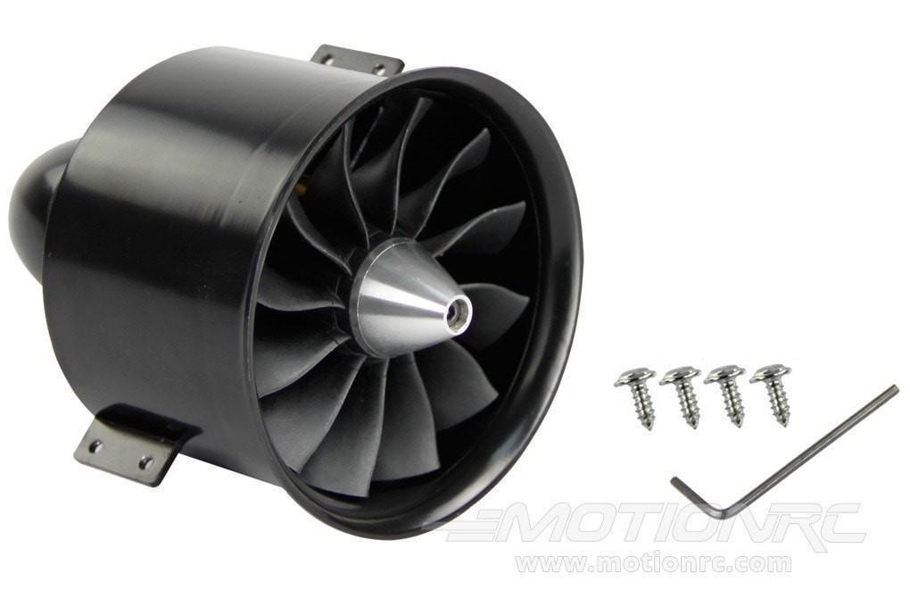

Im looking to upgrade my stock 6 blade setup to the stock 12 blade version and still use the 80 amp ESC`s
When you look at the spare parts section on motion RC site there are 2 different 12 blade EDF units.
What is the difference, and has freewing changed the EDF during the time it has been out ?
One has a metal spinner, and the other has a plastic spinner
https://www.motionrc.eu/products/fre...-w-3530-1680kv
https://www.motionrc.eu/products/fre...r-motors-black

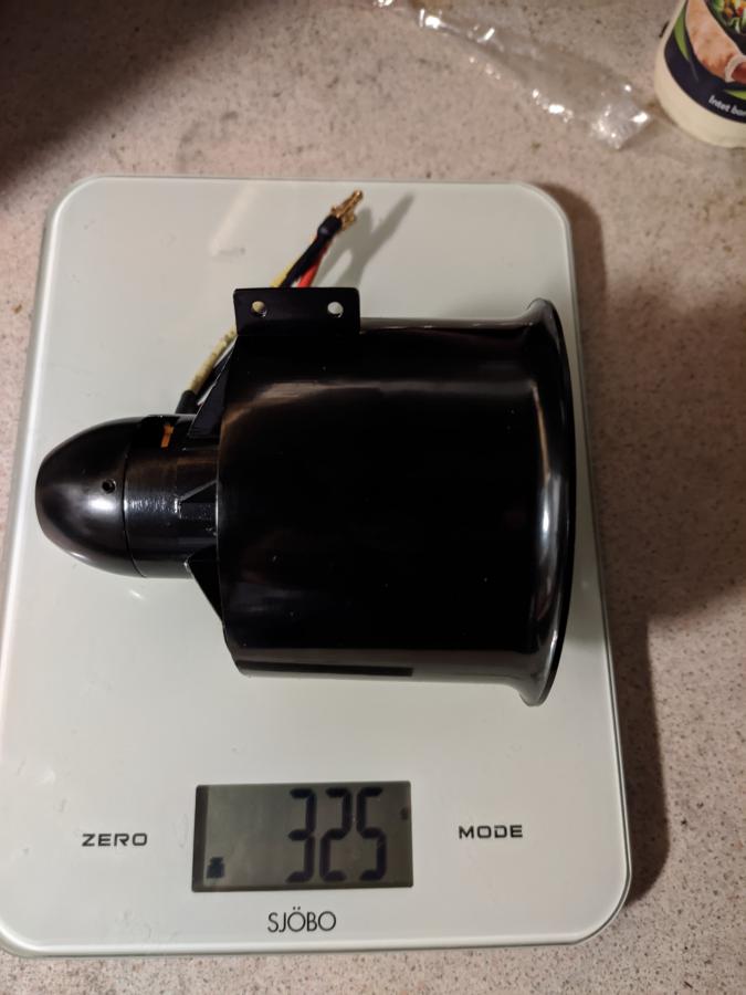

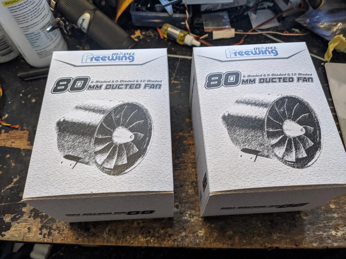

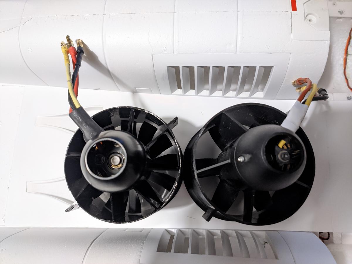

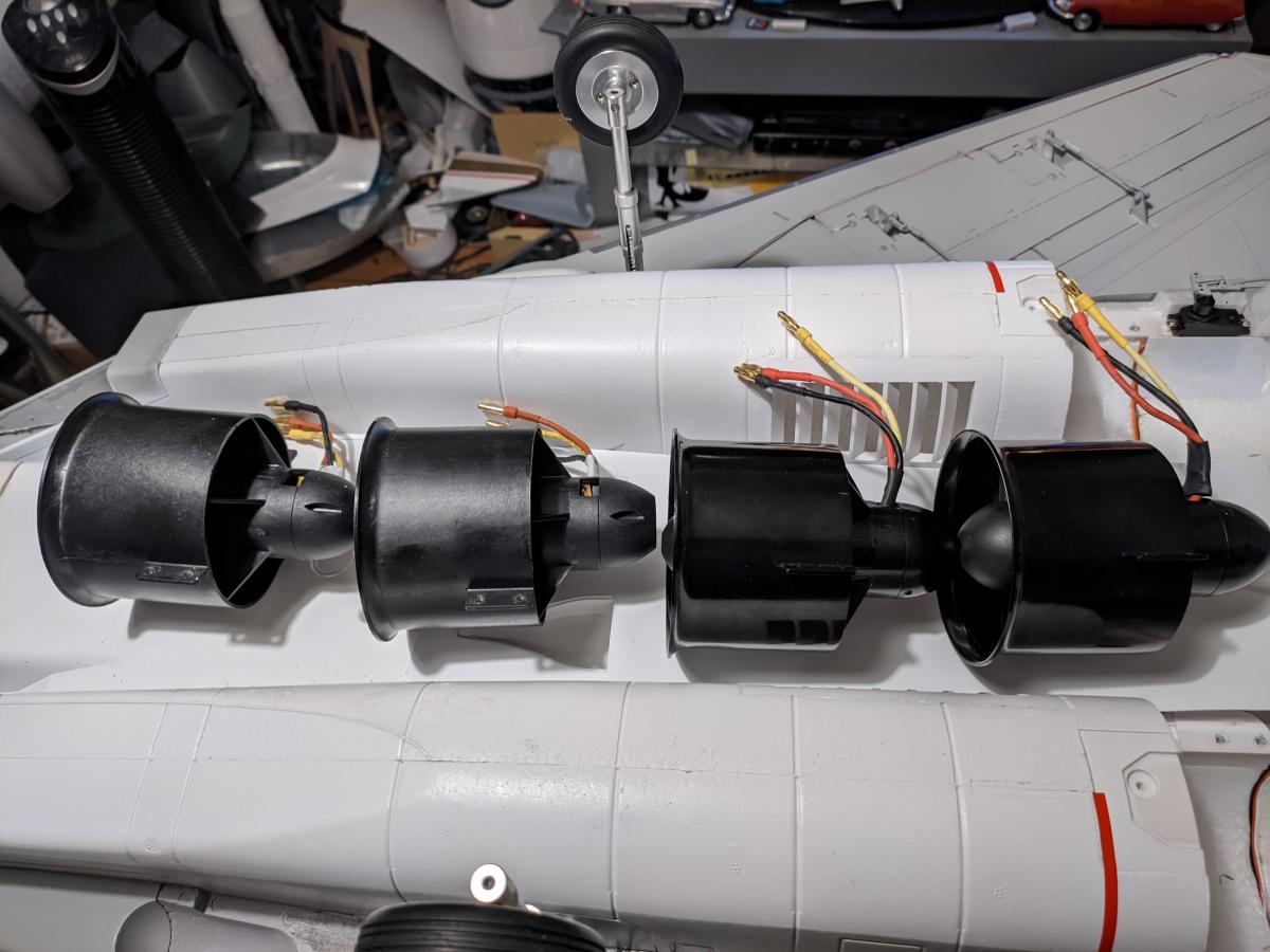

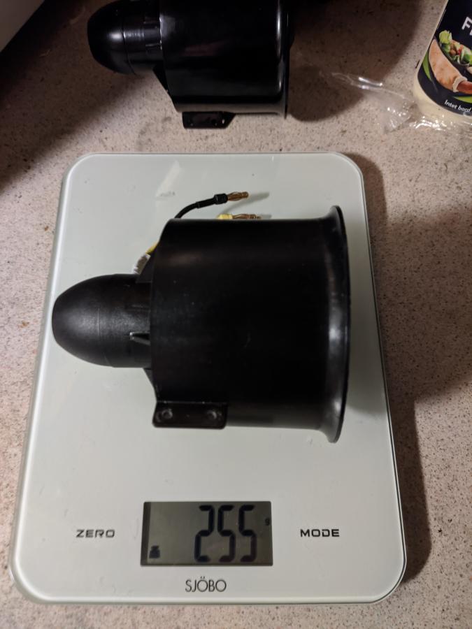

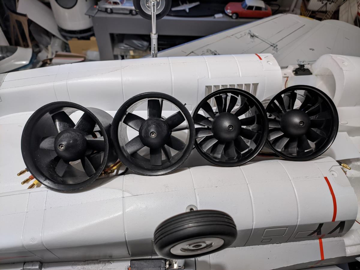

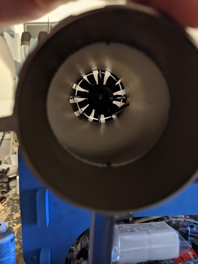

Well, 12 blade EDF`s arived, and are installed. Now I just have to get the CG in spec again, and looking forward to some better noise than the 6 blade fans :-)
One fan was in perfect balance, and the other just needed a tiny bit of tape to balance out as perfect as the other. Looking forward to the next flight :-)
