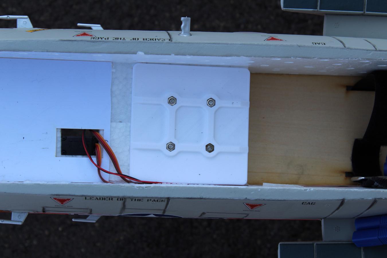

    The nose gear mounting plate looks similar to where i landed with it a few weeks back, but based on a captured hex nut rather than allthread + locknuts. The idea itself was adapted from Bmcormack who used a piece of plywood to achieve the same, but im not much for woodwork lol.
    (Can also see the front of the full length tray in this shot, which adds some additional strength to the glue seam for the forward section of the fuse once glued in place)
