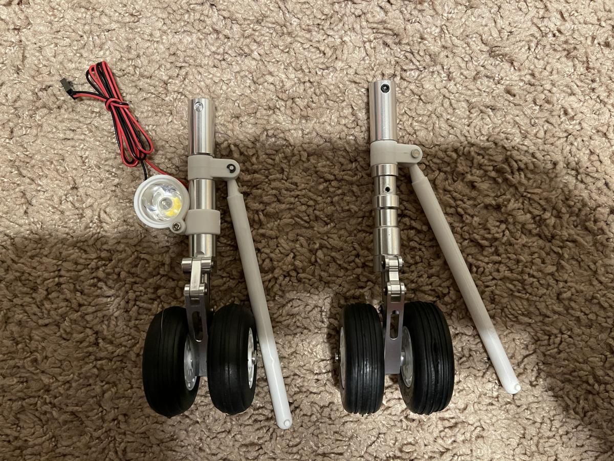

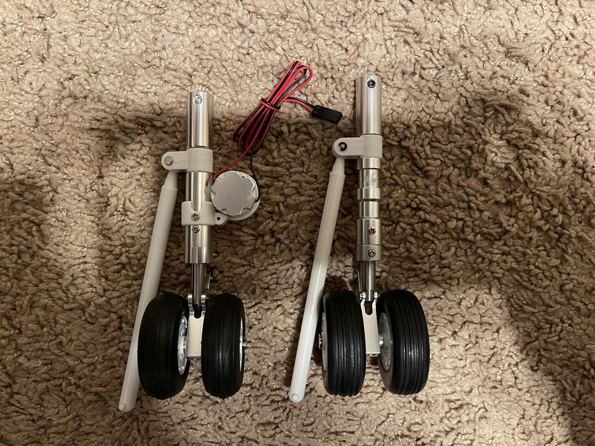

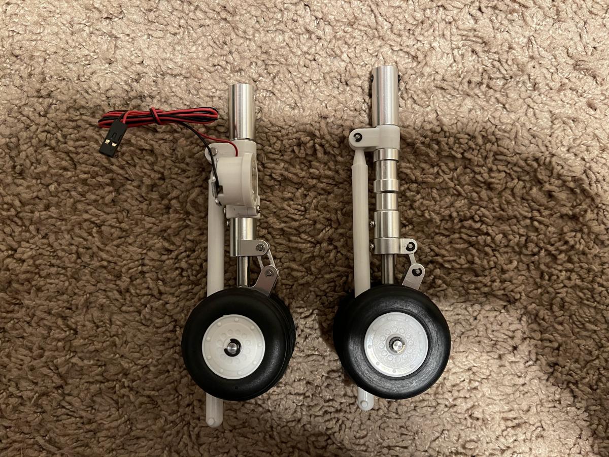

                          Also, the stock nose gear strut in my opinion is outdated and a design I don’t care for. The weak link is that little collar and screw. It wears too easily, and the collar will eventually have a stress fracture or break completely regardless of surface flown from, but it will be accelerated flying off grass and non-manicured ground.
                          What a few of us have done is change the nose gear strut to the Freewing F/A-18C 90mm EDF jet nose strut. It is much more robust, and does not contain a collar, and is instead one metal piece. The pin is the same diameter, so it’s an easy swap. However, keep in mind that the F/A-18C nose strut is about 6mm or so shorter than the F-14’s. Since I fly off pavement and a long strip, it’s not an issue, but those who fly off non-paved surfaces may need to do some testing to see if any difference in takeoff distance occurs. Personally, I like the stance better with the new strut and it’s more robust. Also, swap the nose wheels and wheel axle over from the F-14 onto the new F/A-18C nose strut, or swap over the whole fork/trailing-link by removing some of the C-clips.
                          I can post some pictures if needed of the swap and the look. It was completely worth it to me.

                            Agreed with T-CAT on the nose gear. I'm one of those that changed to the F-18 strut. Drop in fit and it works great! Four flights on mine since doing it.

                                Here are some pictures and a video of the F/A-18C nose strut on the Freewing F-14. I’ll have to take pictures outside with it on the ground for reference.
