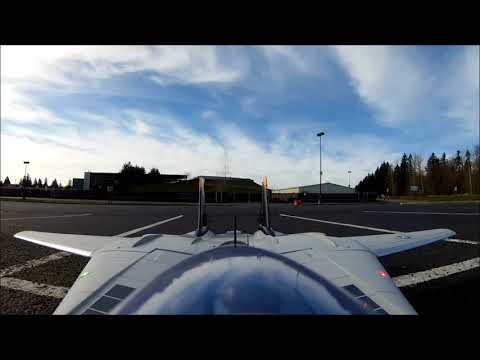

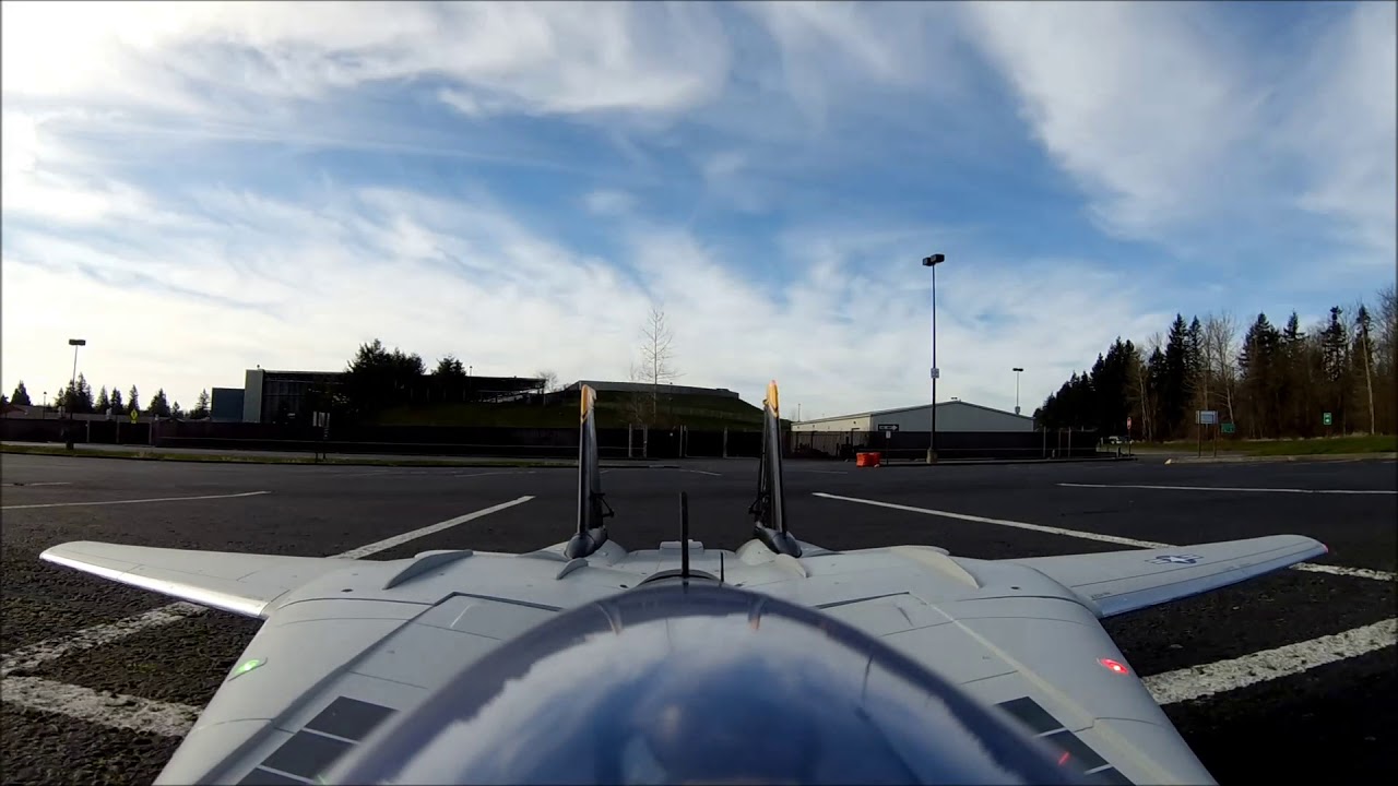

              • Flights #2 and #3 today and I still can't figure this bird out. Even though I adjusted the aileron/taileron trim, it still wants to roll severely to the right. So I was fighting the sticks the entire time. Went to wing sweep mode for the first time and HOLY CRAP was it roll sensitive! Even with the lesser rates from RC Jet Geek's DX file, yowza! So I quickly brought the wings back out. But what has me bummed more than anything is these dang landings. I cannot get her to stick once the feet touch. I have tried everything. Slow with full flaps, touching down as lightly as I can and as soon as the nose gear is on the ground she pops back up. This is the only landing that wasn't a complete train wreck. I had to force the down elevator to keep it from popping up and doing the bucking bronco.
                Reminds me very much of the A-10. The struts are very springy. I can't be the only one with this issue on pavement?
                • Aros, you might want to check the settings on the ESCs. Mine had a similar issue. Turned out to be that one ESC was set to low timing and the other was set at high timing. This cause thrust differential, causing sever roll issues. Good luck.
                  • Having to hold it down means you landed to fast.
                    Take it high and find the lowest throttle where you can maintain level (nose will be high. I mean stay the same altitude) flight with appx 30 deg flaps. Reducing throttle will either cause loss of altitude or stall if you force it to maintain altitude.
                    (you want it high enough so if you stall you have plenty of time for recovery)
                    Note that throttle setting and do a level figure 8 pattern around the field like that so you know what the aircraft attitude looks like from all angles.
                    Now do your approach at barely below that throttle setting.
                    If you are at minimum speed for stable level flight when the wheels touch, drag of the mains touching down will pull the nose down and the airplane will not hop back into the air.
                    Its a bit of a heavy airplane so you will want some more speed than most similar size models.
                    • Interesting MOFO1, I will indeed check the ESCs for timing... fhhuber, I do have a high approach (I have to clear tall trees) which may be creating a faster approach speed but on one landing in particular I kept her in ground effect and bled off all the airspeed I possibly could before stalling and it still popped in the air. For the record, I don't have a problem landing any of my other jets - including the much heavier and larger HSD F-16 105mm EDF jet - on this same runway.
