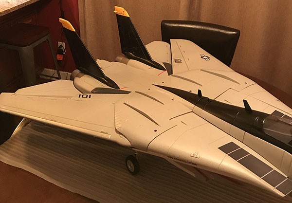

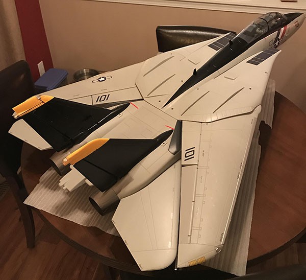

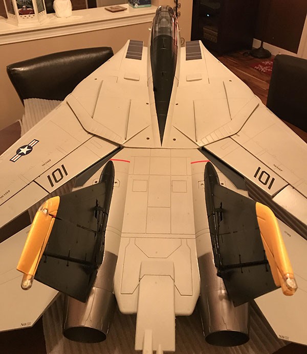

                              • A few more shots taken on my lunch break to potentially cause RCjetdude's bank account to take a dip. LOL
                                  Mine is in jeopardy as well...
