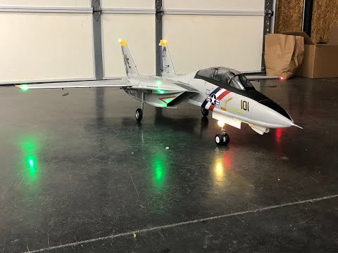

            Finished up my EDF comparison of stock vs inrunners

              TG, Logic seems sound and there's no denying the increase in static. Will be waiting for the your flight analysis. :pop Best, LB

                Awesome video! Your gunna love it! Mine flies awesome on the 1850 outrunners so i can only imagine how good yours will do!!

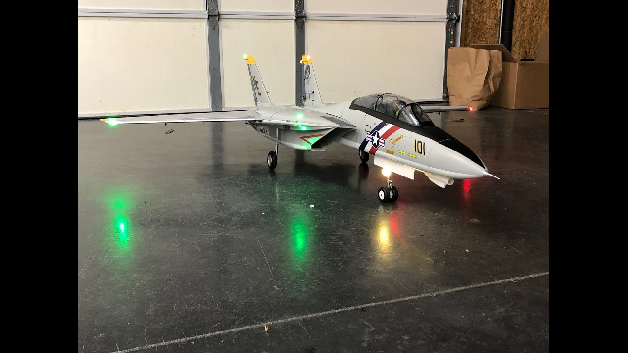

                        Hello. I have been searching and searching for someone who has done this thrust testing on the stock f14. I have been having an issue with mine and i felt like i had lost power. But after watching this video i know i have not. I get 7lbs thrust on my stock setup. I think i must have missed which inrunners you went with? can you provide a link or full description? Thanks.

                          Here you go. You will need 100amp ESC too

                            Thank you. WOW! about $400 (assuming you need two esc's). Did you really feel the difference and think its worth it?

                              I bought or had some parts
                              haven’t flown it yet. 3 lbs of more thrust is a lot

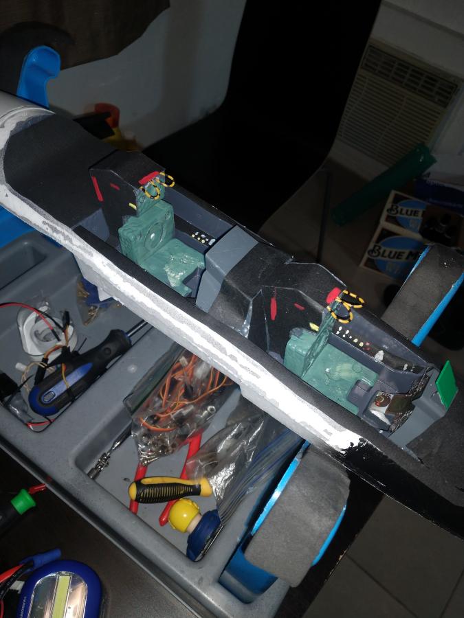

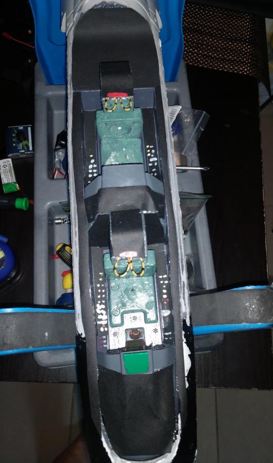

                                          Cheap F14 cockpit work around; so here in Florida that sun bubbles the foam fast and especially for this particular canopy, (I personally hated the way it would look) so I bought a large sheet of thin black construction paper, measured and cut the paper over all the exposed foam area (entire cockpit) glued, then carefully used a thin paint brush to dot in dials and controls as scale as possible. Painted seats green. Painted and cut 4 small pieces of servo wire for iconic ejection seat handles, glued them onto seat with paper over it, and this turns out to look a thousand times better than what I had. Sure you can try to get the 3D print stuff but if you don't have access to printer this is a great work around. Whole process takes a good 2 hrs to complete.
