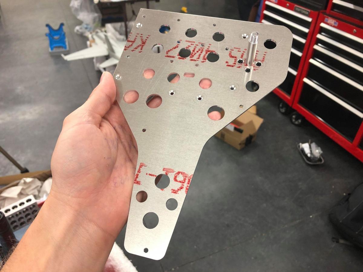

                        Won't be long now

                          Nice Dustin! Between stab hinges for Roban Apaches and these you are staying busy.
                            Yes sir and firearm parts. Then working full time for family business. I did this to my self, haha.

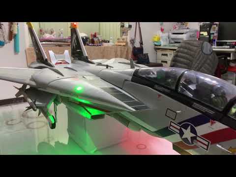

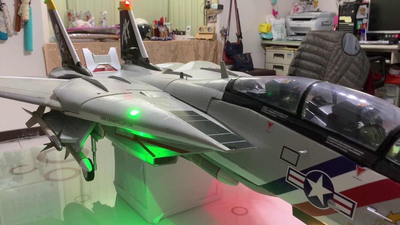

                                Stolen from RCGroups. Not sure who the aircraft owner is, someone from China or Taiwan I assume. Highly modified Freewing F-14.
                                    Absolutely gorgeous!!! That's a true modeler!!! I wonder if she'll still fly? How much weight was added? In any event wow just wow!!!
                                    This guy must have received this bird and thought, "Nice kit" or "Oh, my ARF has arrived" while the rest of us believe it to be a PNP haha.

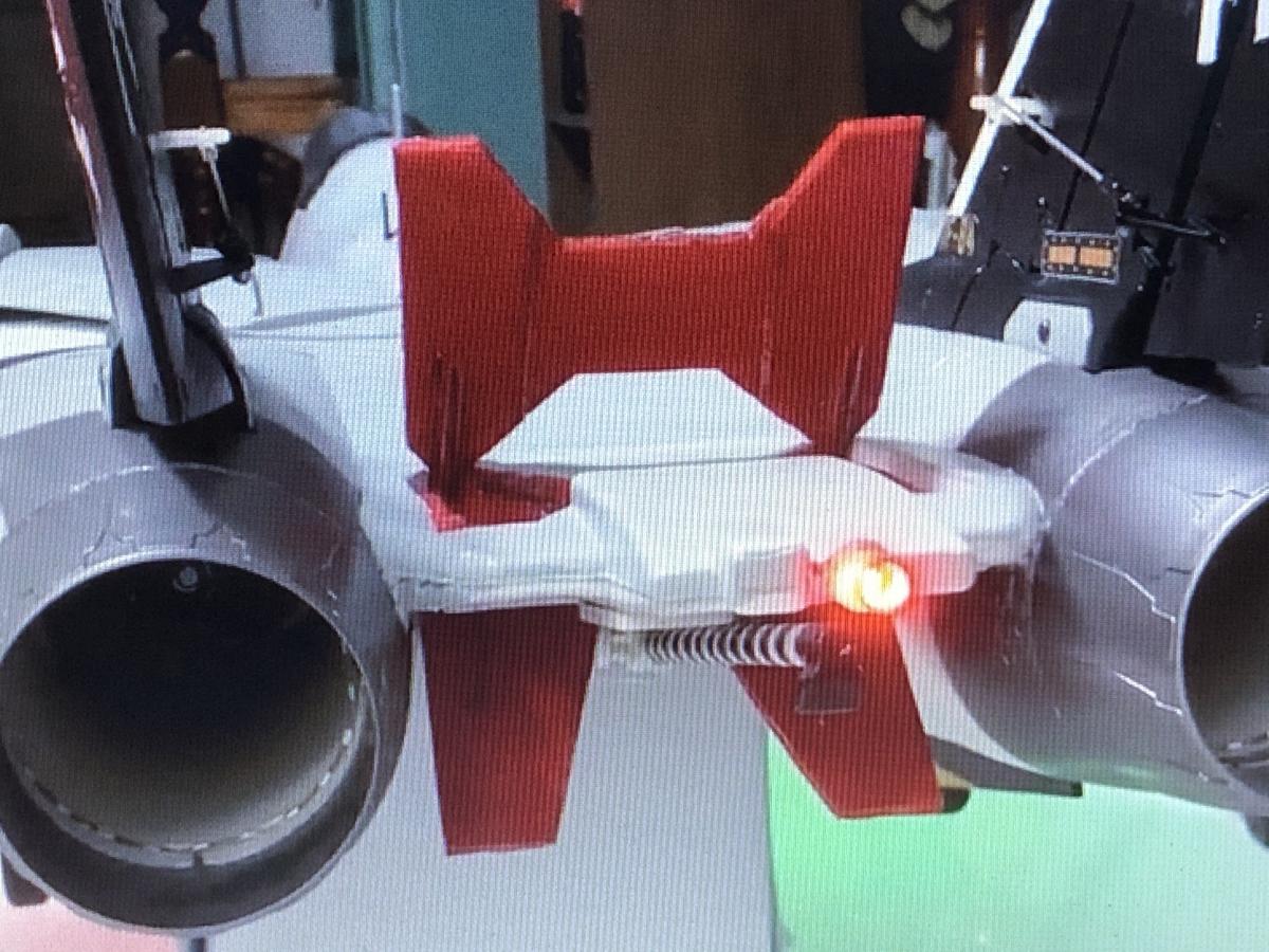

ID:	218536 I ran across that guys video and a few others he highly modified. I am very interested in doing the canopy and the air brakes. I think I can figure out how to do the canopy. But I’m thinking that some 3-D printed inserts for the airbrakes would be good. But I have no 3-D printer or the skills to do it. Anybody know of anyone producing something like that? Or is there anyone with a 3-D printer willing to work with me on it?
                                        #659
                                        I have a printer, but no design skills. Doesn't look like the scale brakes would be difficult to design.
                                          #660
                                          Originally posted by Aces
                                          Aces I can't see the video due to my location, but based on that screenshot you posted, it should be a fairly straightforward matter to modify a servo to push two control rods, each of which extends one of the brake panels. Google for a diagram on a single servo linkage for a drag rudder --same principle applies here. I'd probably run two servos, one for each hinge, to avoid any twisting that might occur in a single servo-driven hinge setup. You may also consider looking at our 90mm T-45 and 90mm F-104, both of which use an air brake mechanism, albeit a single panel one. Perhaps you could adapt the geometry to the F-14.
                                          As for the brake panels themselves, as Crxmanpat's photos show, they're flat. As I recall from several years back now, we included the panel line in the mold, so I would recommend using that outline on your existing model to trace on a white piece of paper the general shape of the brake panel. Then, transfer that shape to thin styrene, and work out the aforementioned servo linkages. Bury them on the underside fuselage so they're less visible.
                                          A bonus would me the rout out the thickness of the foam to accept the plastic brake panel flush with the surrounding surface. I'd recommend a Dremel at mid speed with a small barrel sander for this task. Adjust your speed so the edge is smooth but doesn't marr or melt. Practice first on scrap foam. It becomes easier after a few test passes.
                                          Paint the inside red, sync the servos, sit back and smile.
                                          In the air, ensure you have adequate air speed --but not too much!-- before testing deployment. We evaluated a number of configurations on the original prototype F-14s, including brakes, and we didn't quite like them. Your [air] mileage may vary.
