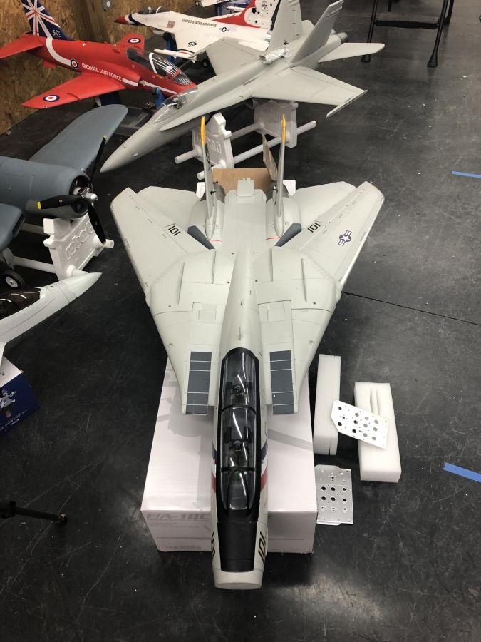

    Guys we are slow close

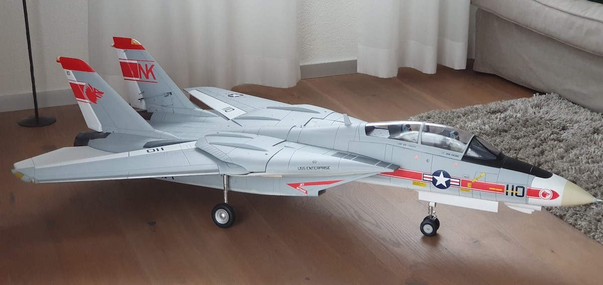

                      Hi guys,
                      I made it to program the Tomcat with JETI. Wow that was a tough brain work but finally I made it. Got some help and now I have full flaps, spoiler up only and taileron when fully sweeped.
                      Now I can close the turtle deck properly and do some weathering.
                      I attached the F4 wheels but as they block with the struts a bit, I don't know if I like that for the start phase. I do think about and maybe go back to the original wheels. Furthermore the main struts are almost completely compressed. I wonder about that. I also did some mods on the battery tray and rear fuselage where the landing gear sits. Waiting for the rcinformer mod too.
                      Click image for larger version  Name:	20191123_135826 Kopie.jpg Views:	1 Size:	128.4 KB ID:	220189

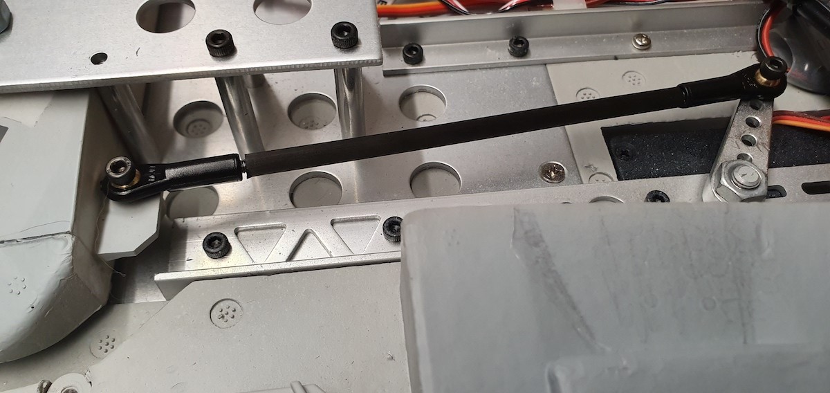

                      Did anyone have a problem with the sweep wing rod? The thread does not seem to be rock solid and as the rod in total was a bit to short I had to "unscrew" some of it which I don't like.
                      the mod would be an M3 threaded rod with carbon tube. It would look like that in the end.

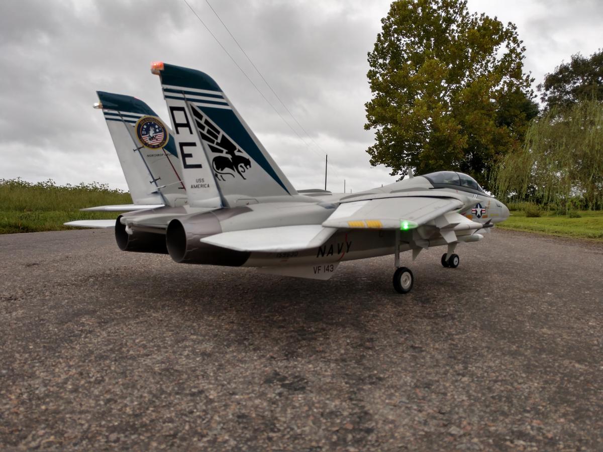

                                Here's my VF-143 Pukin Dogs livery. In the tail pic you can see that the starboard rear anti collision light is now red. Somebody from the squadron busted me on it so I had to change it. Haven't worked up the skill to fly it quite yet. Started flying a YAK 130 to get my skills up. Also have a Freewing F-16 and an A-6 for practice. This is set up per the RC Geek with full span flaps and spoilers. Hoping the maiden goes well. Click image for larger version
