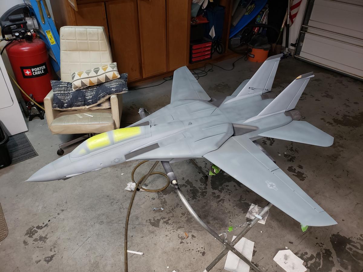

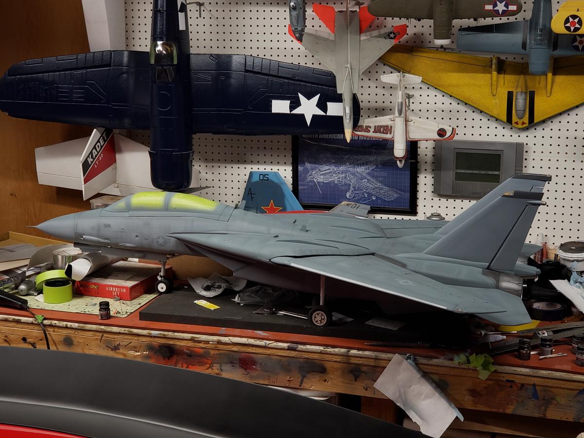

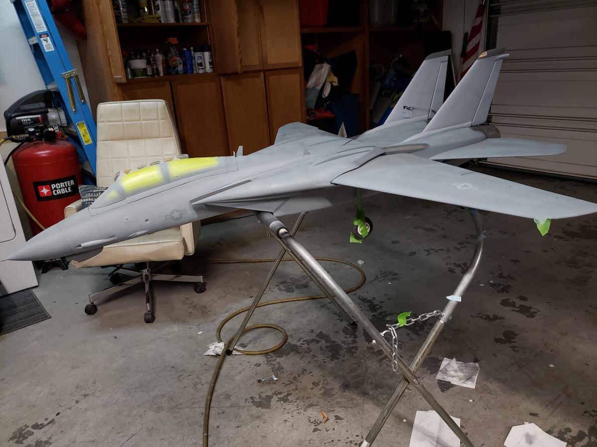

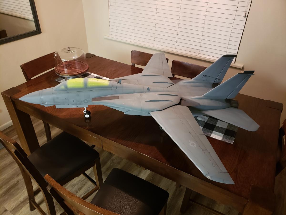

              • Finally got a chance to maiden the f14!!! Ill do a lil post flight video soon...but i put 4 flights on it..and its epic!!! Definately more vertical than the stock setups. The a4 12 blades perform real nice and i qas still getting 5 min flights on 5800s. No major trim needed...overall super happy! Started on paint. Its getting there. A ways to go yet.
                • I love the revival this bird is seeing, keep it up, all you guys. The low-vis gray is wearing on me... Love it.
                  • F-14 Envy!!! Brilliant work! I need one!! no no .... 2!!!
                    So.... "The a4 12 blades "... you used the 80mm power plants from the Skyhawk?
                    • Thanks alfa!! Wait till its finished!!
                      Yep. A4 12 bladers

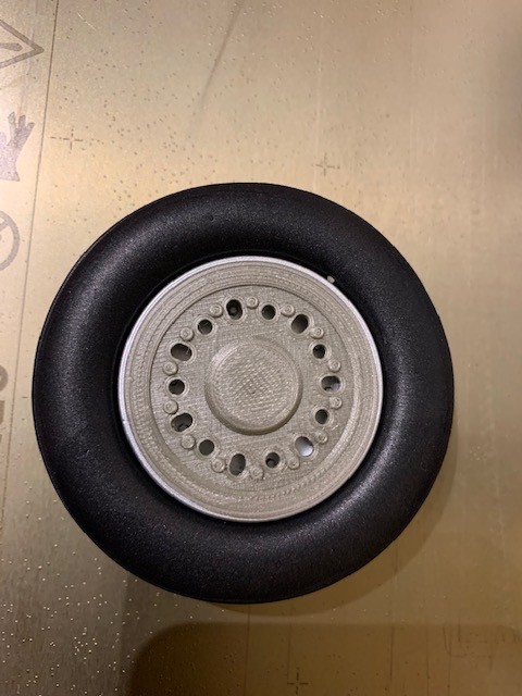

                      • Here is a small contribution to CN's Tomcat project.
Name:	Wheel Cover late Rim printed.jpg
                        • Originally posted by Radar-Guy View Post
                          RG, Nice touch and very kind, Sir. Best, LB

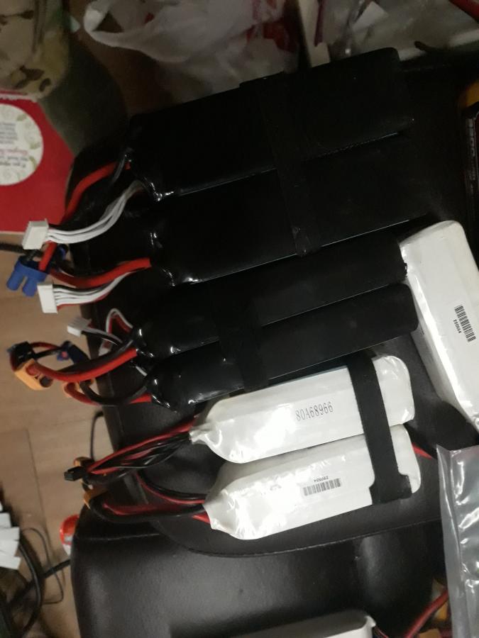

                                • Ok.... so now I am obsessed..... LOL.... What are the thoughts on 2 of these??? INRUNNERS... 12 blades and same KV.....
                                  • I wanted a10 setups but couldnt find any used and i already had 1 a4 setup
                                    • Originally posted by e4dragongunner View Post
                                      This is what I'm testing now.
