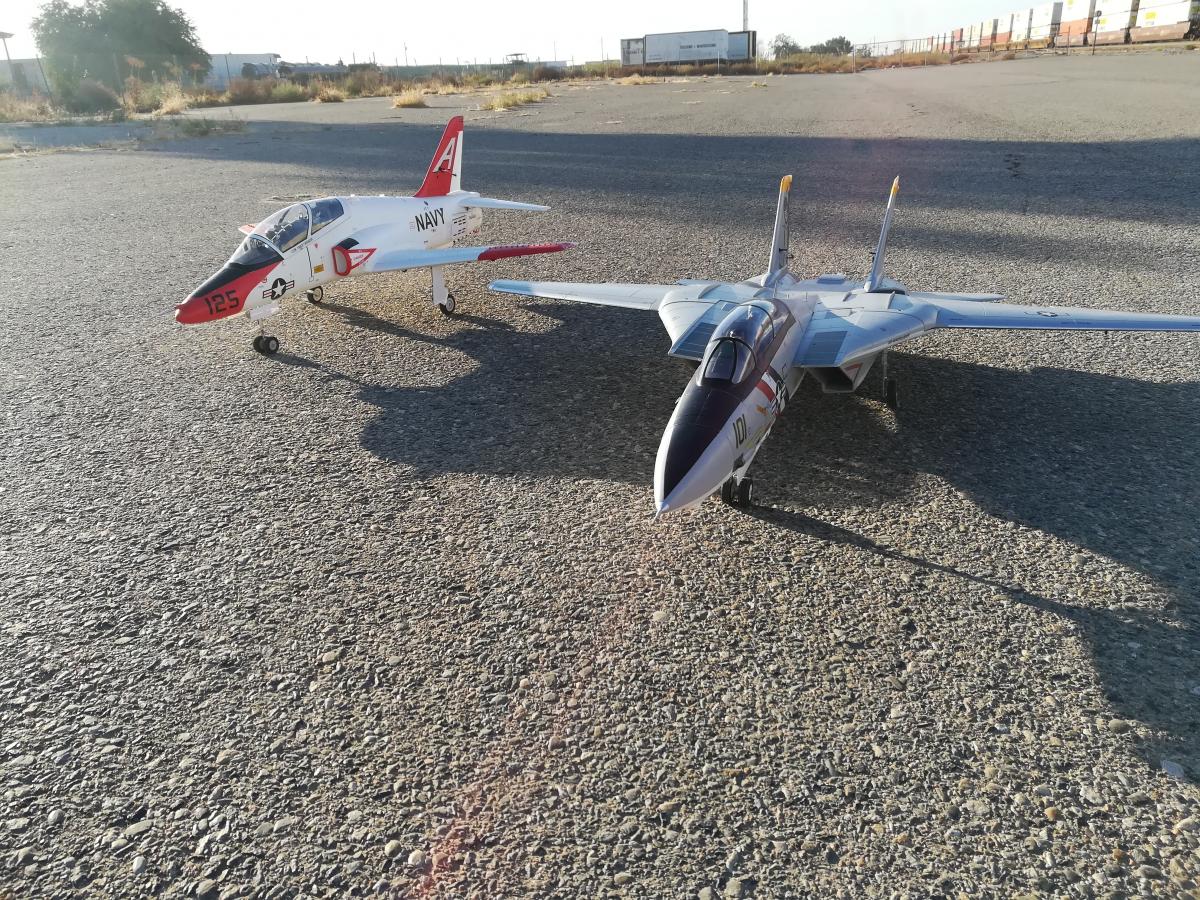

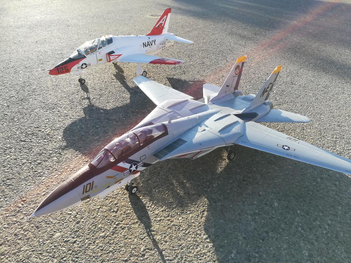

            #625
            Got my maiden done on my F-14 this morning, four flights total, first flight was for trim and the next three were with the wings swept, all good, mine is all stock and set up as per the manual, well close anyway, no mixes or anything fancy, just a dual rate set up in the swept wing configuration, using my good old faithful Futaba 7CH radio with a 617rx, ESC power and swept wing leads plugged into ch 7 on a Y, all works great, didn't bypass anything, rock solid right out of the box, I did modify the upper battery tray, just lowered it down even with the stock front one, dug out a little foam here and there and CG was perfect with two Gensace 5000 60C batts. If anyone needs pics of the battery tray, let me know and I will get some pics of that and how I mounted the 617 rx in the back next to the control board. I have flown one before and forgot how it floats on landing, had to slow it down more and use full flaps and it landed like a baby.
            • handyman220

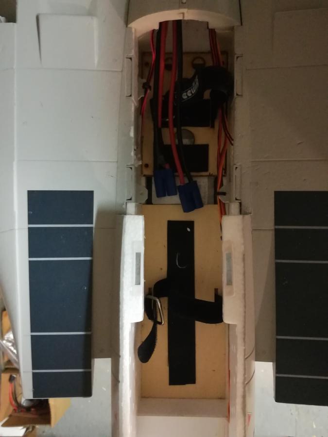

              #626
              I'd be interested in pics of the battery tray. Mine is still sitting in the box waiting. It's refreshing to hear that stock set up works GREAT!! I am looking into the upgrade for the main landing gear might do that while initially putting it together. Congrats on the successful maiden.
              • DCORSAIR
                • 1918
                • Selma, Ca.

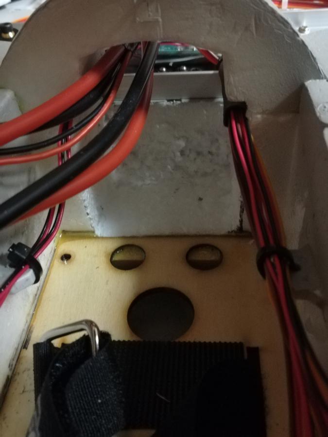

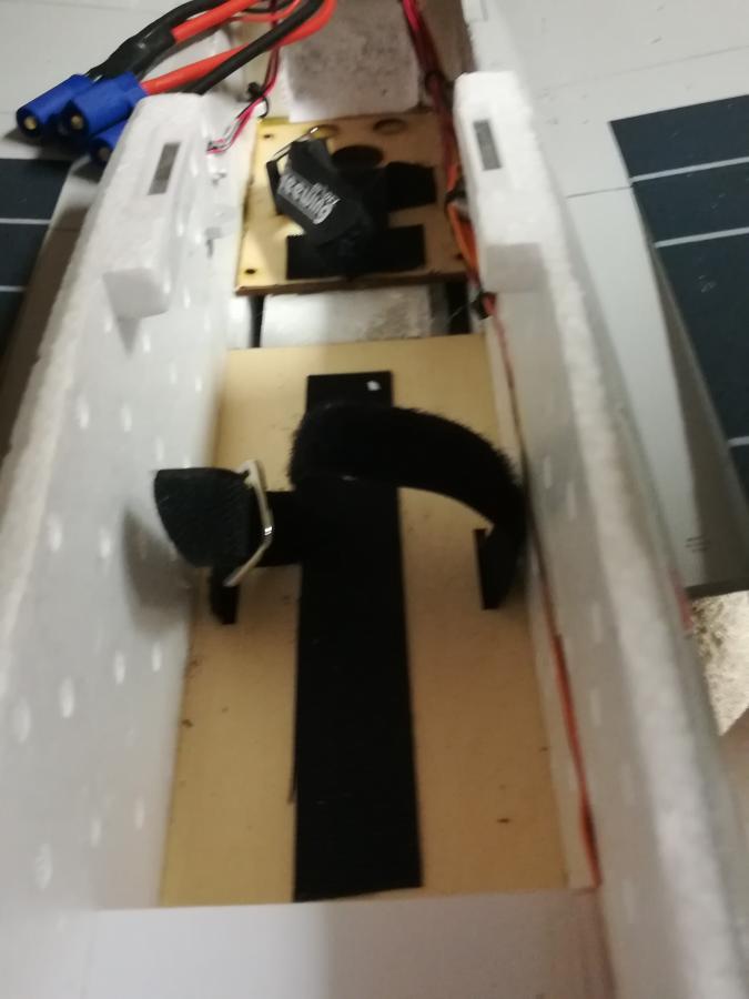

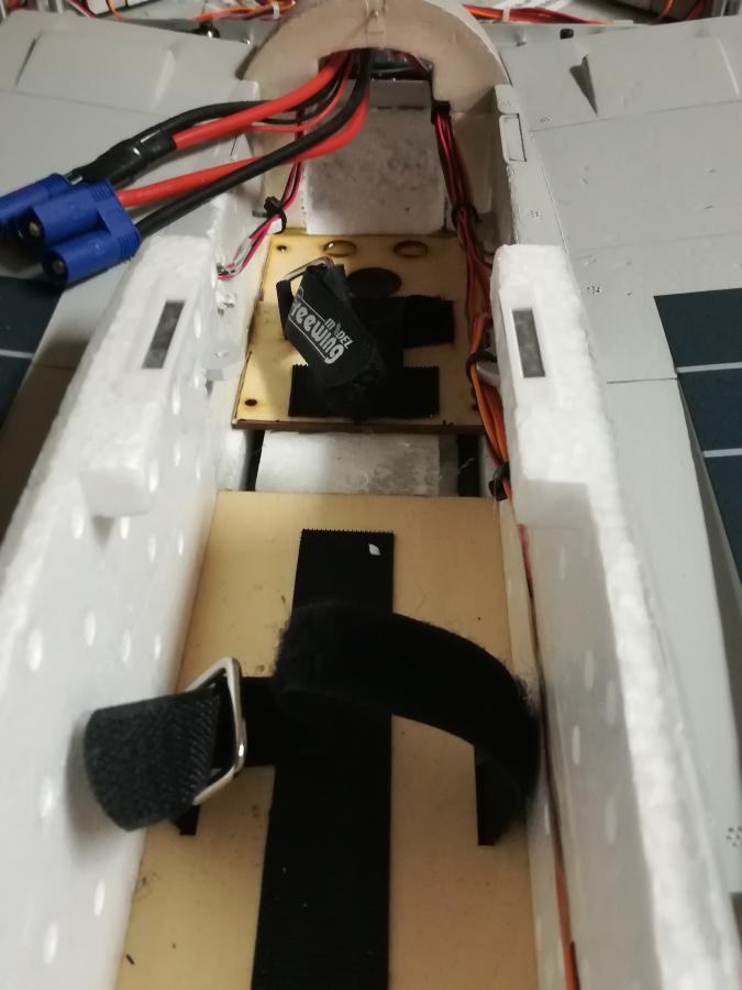

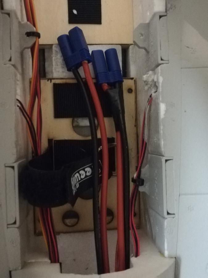

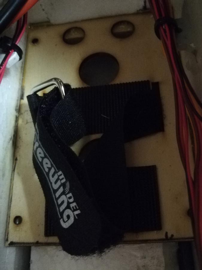

                #627
                Thanks, and I will get you some pics posted as soon as I can. I know others have made a new battery tray and all that but I like to do things simple and easy, so I used the stock tray and just dropped it down even with the front tray, I did try the batteries first in the stock configuration but just not enough room and a pain to make it work, with the new tray it makes life so much easier. Hope these are good enough to show what I did. The pic with the wooden piece is what I used for the battery tray to sit on, glued it all will 15 minute epoxy, also of my rx mounted in the rear.

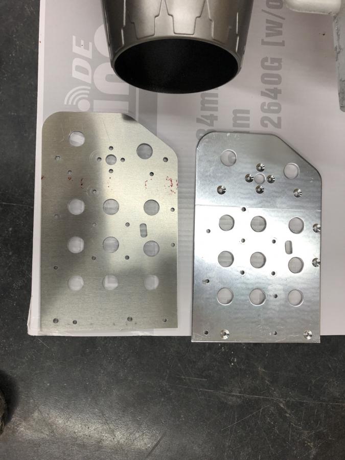

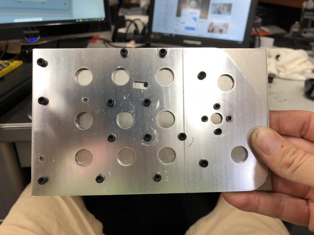

                                #635
                                Update:
                                First run of the plates to make sure bolt holes lined up well and they do! Only 2 need to be moved over about 0.020-0.030.
                                more coming in the next few days!

                                  #636
                                  What are they going to be used for? It's all aluminium?
                                  • thisguy65
                                    • 509
                                    #637
                                    To reinforce the fuse at the mains. RCinformer (Rich) has a video on it, on youtube. We've team up together.
