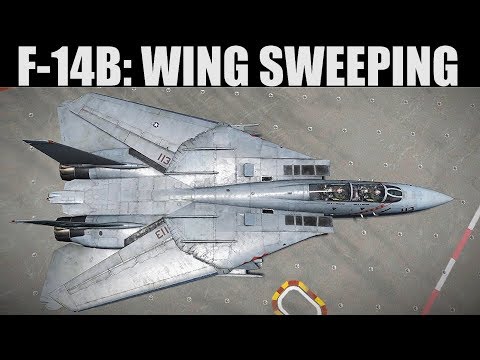

                  Hello all, looking for this bird to be the next addition to my hangar. I was curious if anyone has attempted a halfway wing sweep setting between fully extended and fully swept? If not, I'd appreciate any theories someone who owns this bird may have as to the feasibility of such a setting. Thanks in advance.

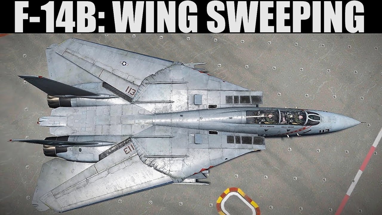

                      While I am not familiar with the RC model I am familiar with the new DCS F-14B simulator module and its sweep wing settings. The wing sweep position depends on the speed of the aircraft and what you intend to do. A half way sweep could be considered as Bomb mode when the wings are at 55 degrees. So in the real Tomcat the wings are actually set in the mid wing position when bombing or when in Auto mode because the system has calculated that to be the optimal position for the current speed.
                      I would think that you could program the wing sweep into a 3 position switch and then go in and fine tune the potion of the wings for every position of the switch just like you would do for setting up the flaps.
                      Below are two videos that will help. One that explains how the wings work in the simulator and the other one of how to set up the RC tomcat.
                      I had seen the setup video a while ago and watching it again now makes a lot more scene after having some experience with the F-14 in the simulator. I highly recommend checking out DCS if you have a PC capable of running it to become more familiar with the Topcats flight dynamics. https://www.digitalcombatsimulator.c...odules/tomcat/
