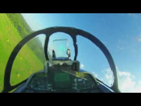

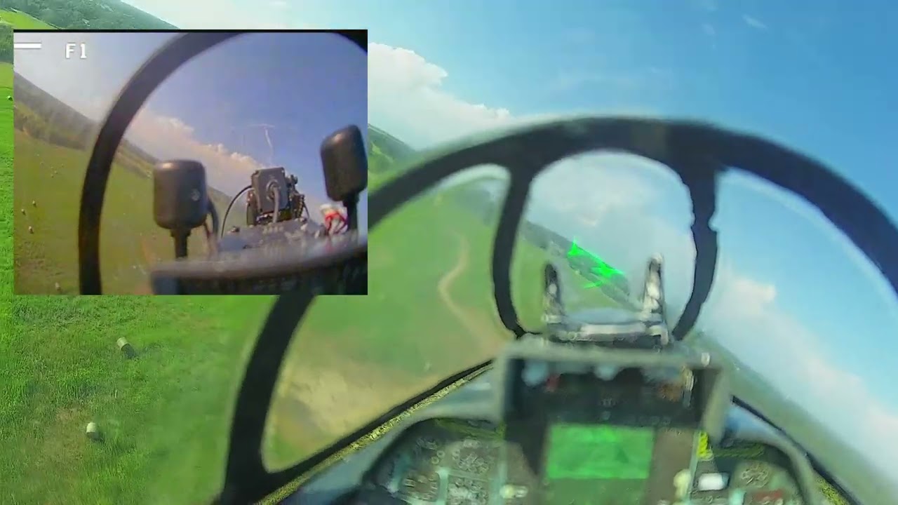

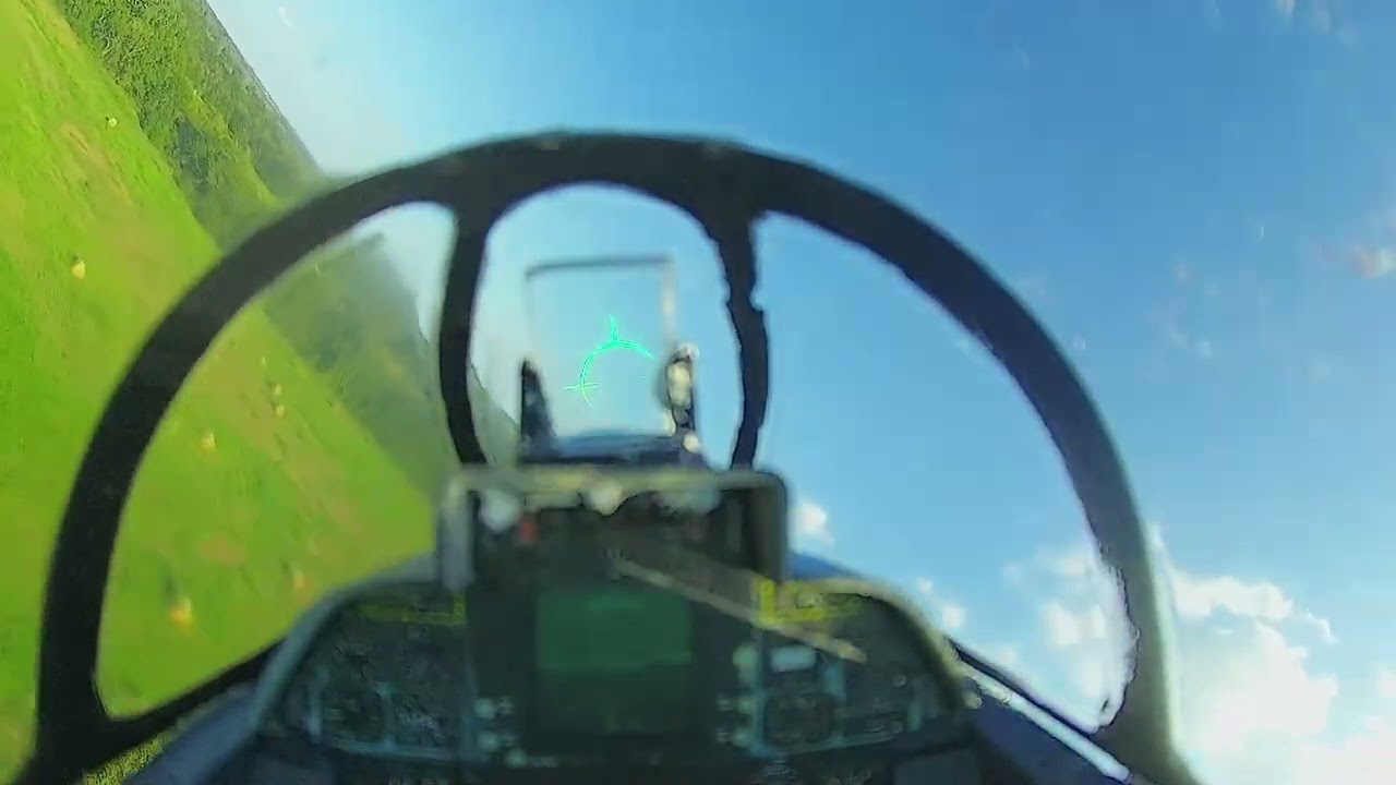

              Replaced the gun sight. Definitely looks better in this video. You can definitely tell the weight improvement on the loop I did in this one.
