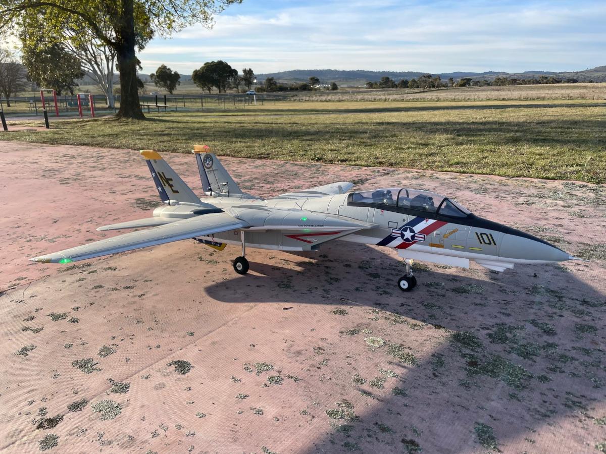

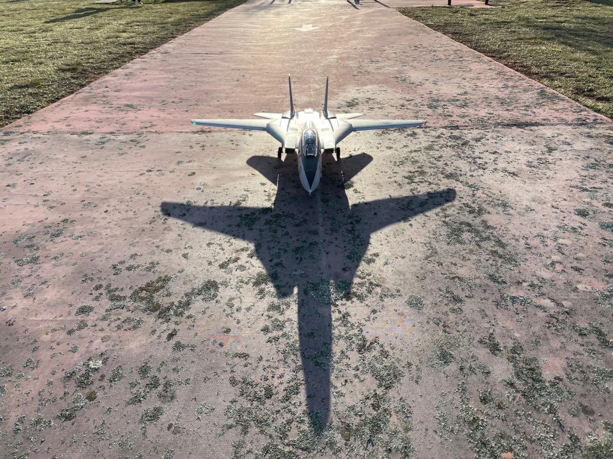

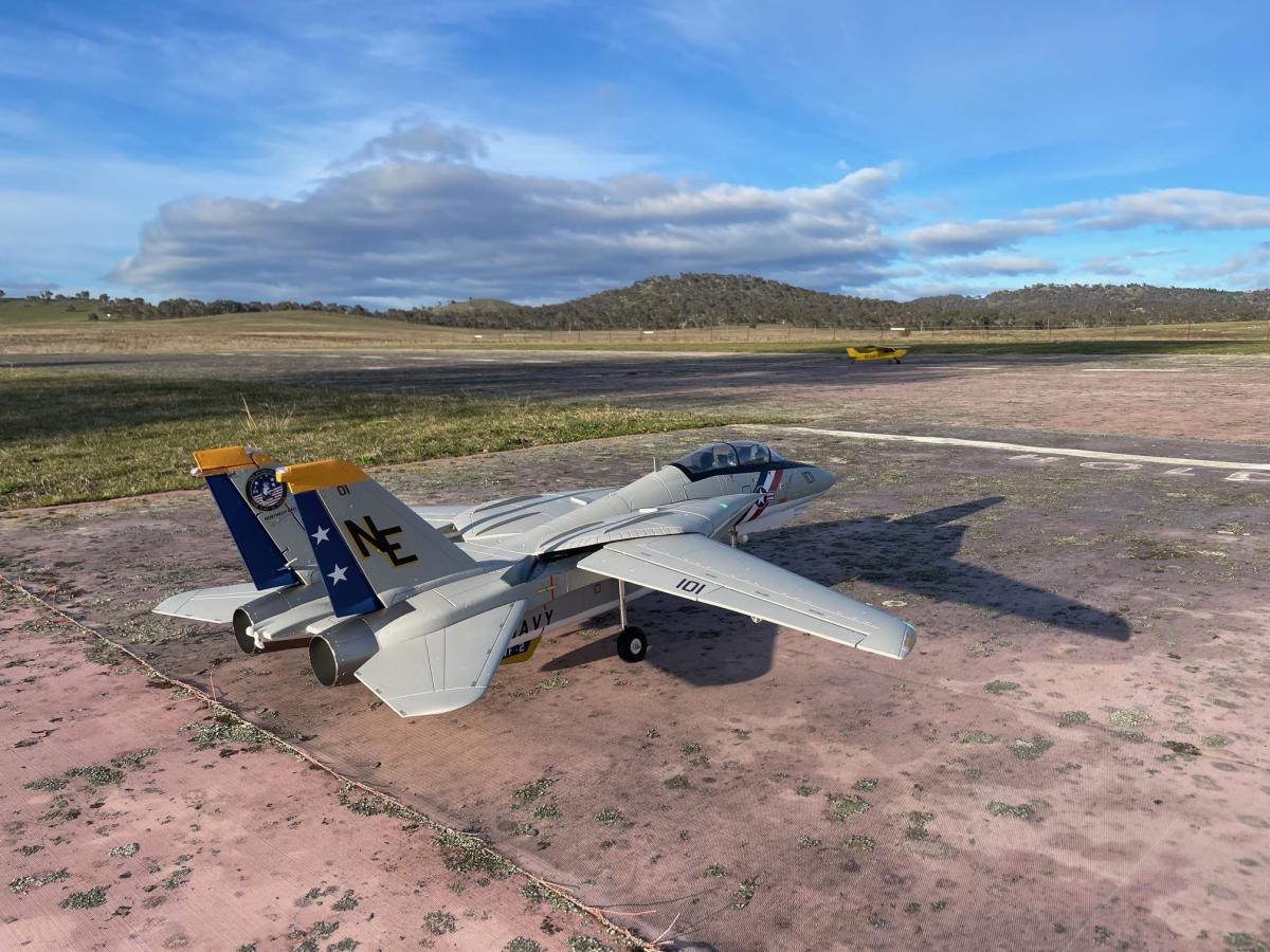

      • So it was a successful maiden flight on the 80mm Tomcat yesterday albeit in challenging conditions at the end! Looks so amazing in the air. I added centre burners and changed the ESC & EDF unit to the latest Freewing 80mm units. Had her setup with the RC Geeks setup (Tailerons, full span flaps and 'spoilers')..
        When I lined up on the clubs runways the windsock was totally limp. By the time landing rolled around it was horizontal, kicking and a cross wind.. I felt personally attacked.. Brough her in with no flaps and a bit of slip and ended with a small bounce before settling. She just wanted to keep flying..
        Looking forward to flying her in more amenable weather conditions so I can nail some nice landings..

        • Originally posted by HairyTacco View Post
          So it was a successful maiden flight on the 80mm Tomcat yesterday albeit in challenging conditions at the end. I felt personally attacked.. Brought her in with no flaps and a bit of slip and ended with a small bounce before settling. She just wanted to keep flying..Cheers,
          HT
          Great debrief, beautiful model. Congrats, Sir.
          Best, LB

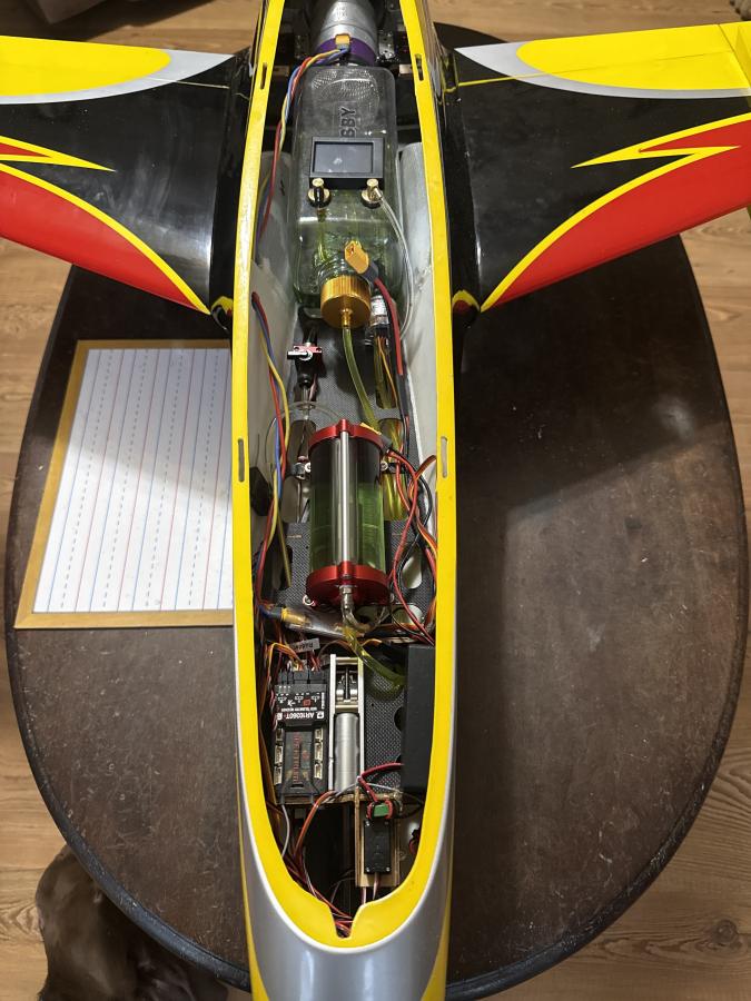

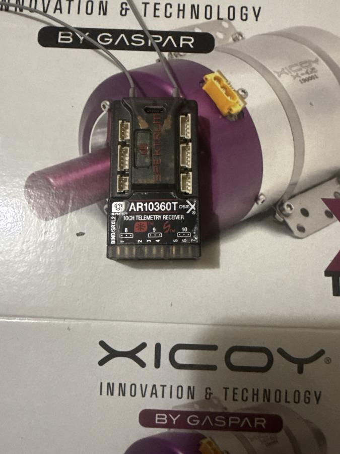

            • Originally posted by shortround91 View Post
              Just finished up my F14 waiting on another AR10360t first one not working right to program ailerons ( wing ) to not operate when wings are in. For now just flying wings out hopefully any time I can sweep them in
              Hi shortround91, Are you absolutely sure it's a fault in the receiver? If you're not a programming expert, like me, then it's quite possible the error lies in the programming itself... don't you think?
                But your Tomcat is awesome, that has to be said!
                  Are you really sure it's a fault in the receiver? If you're not a programming pro, like me, then it's quite possible the error is still in the programming... don't you think? But this Black Tomcat is awesome, I have to say!
                  • Originally posted by EDF-Jetpilot View Post
                    Well when port 4 does nothing set up stock configuration and 4 other receivers were installed video’d showing H company I actually understand electronic programming yea the receiver has an issue. Sorry I was a Dyno Jet authorized trained operator have done electronics in the Army Yamaha Suzuki Kawasaki Honda of course all factory trained I’m not a MMI person. I think after setting up over 50 planes I’d understand when a port that is fixed doesn’t work. Yes port 4 is locked so how can you mess that one up. So thanks for the 😉 but this guy isn’t stupid either
                    • I actually still have the receiver if you’d like to buy it prove me wrong was strange that I purchased a new AR10360t+ and all the sudden everything worked. I do admit when I mess up including my first time setting up safe not knowing to go back in forward programming servo relearn. Was ugly my first EDF with retracts went up then straight down into the ground. Yup I messed up but honest enough to say it was me. Here’s the receiver again let it go half price 😁
                        Oh, sorry, I didn't mean to offend you... I couldn't have known how experienced you are. Anyway, this kind of thing has happened quite often, that it was a simple programming error, even to me. That's why I asked you the question. And by the way, I don't want a defective receiver, what do you think, not even at half price!
                          Yes was the weirdest thing no matter what wing configuration you put the receiver in port 4 did nothing, H Co had me plug in several servos again had to video upload everything to them. I did get upset after a month of going back and forth with them, all I wanted to do was send it in or sent a replacement. Then when it was on my dime to send in for warranty I go even more upset it came this way out of the package only receiver I’ve had any issues with. That why I never sent it back and don’t blame anyone why want a defective $200 receiver, I’ve been Spektrum since I got back into the hobby now flying 2 turbines working on a third. I apologize I’m still a little butt hurt over HH customer service took my comments a little far. Here’s a shot of my Avanti that I just fired up last night for the first time, just need the winds to calm a little before maiden time
                            Thanks for the message. No problem... yeah, that kind of thing can be annoying. I've been flying Spektrum for several years now and I'm very happy with it, no problems at all. The ASX3+ gyro software is absolutely top-notch and works really well! Do you also use a Spektrum gyro with your turbine? That doesn't work with the receiver's integrated gyro; it should only be done with the Spektrum Powersafe. Do you have any experience with that? By the way, that's a great painted Avanti! Ich denke, das passt aber nicht in diesen Thread.
                                      Something that's handy when a receiver seems to be malfunctioning is a PWM pulse width meter. Plug it into the offending port and it will show you what signal is coming out of that port (including 'no signal'). I got mine from Aliexpress, it was about $5.
